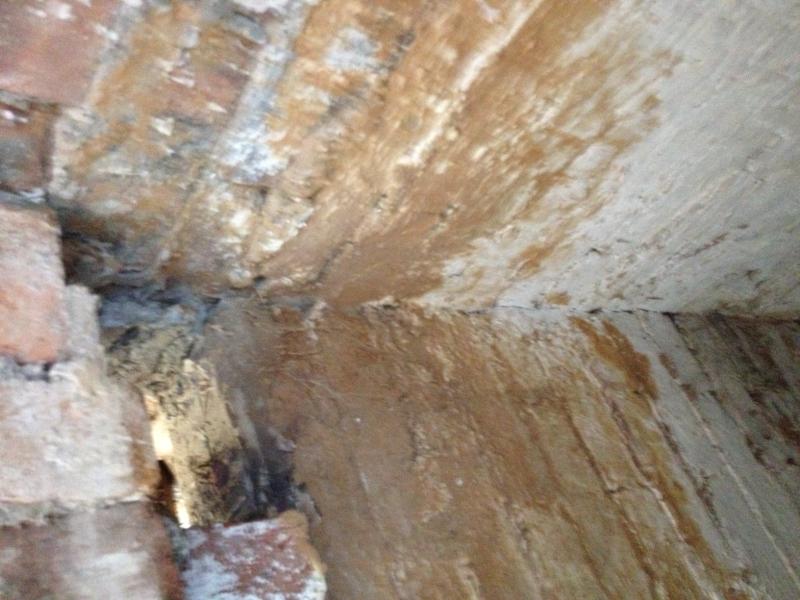

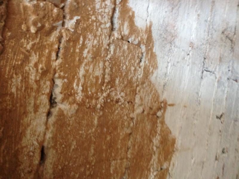

I have stripped out some flooring and joist where an old bath had been leaking and i have discovered this on the wall i the basement around where the wood was rotton.Is this drt rot or some thing else.There are no other signs of growths.This is all it looks like.The timbers that came out did have a cuboid type rot.More a wet rot type.I have attached a few pics in my album.
Go to Yellow Pages and get a few timber and damp companies to come and give you quotes, they will then tell you what the problem is and more importantly what caused it.
I am going to do that tomorrow but i just wanted other opinions.From what i have heard some companies will just scare you and charge you a fortune for the work.And i am still unsure what it is!
The pictures are blurred
If you are referring to the brown stain on the wall, then that is not rot. Its a brown stain
In pic one, just below the opening you can see faint strands of what looks like dry rot.
The brown business i think i've seen before on basement walls - it used to be the "pre-condition" for what was called cellar rot. If examined very closely, it appears to have a tiny cover of furry fuzz. Typically, ground water (or a leaking drain) was penetrating the cellar wall(s).
THanks Dann09.Thats just exactly what it looks like smalll strands covering the brown stain.Most of the brown stain is on an internal dividing wall.I am wondering if the toilet has leaked at an earlier date and that is what the stain has been caused by.What would the best treatment be for this.And is cellar rot something i should worry about and how would i treat it.

You must reveal the total extent of the dry rot, or cellar rot, strands in the flooring timbers, skirtings and behind any nearby plastering.
Cellar rot seems to go by various scientific names, but it's a wood seeking and wood destroying fungus - altho not as virulent as dry rot.
Typically, we would reveal and remove all damaged material, wire brush down and spray with anti-fungal chemicals. We would also locate and remove any source of moisture, and provide ventilation.
