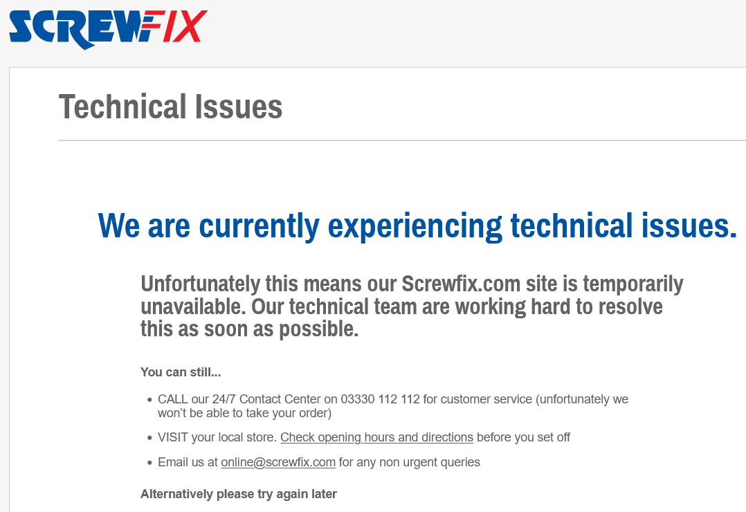

I didn't see that, here. The site has worked just fine, throughout. I wonder if they present a different site to those in Wales, from those in England, and it is the Welsh version which is down?

SF site has been available throughout the day AFAIC and my grandson finished a shift there at 20.15 and reports no problems.
