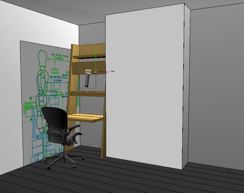

I'm making a couple of ladder desks out of new unbanded white pine scaffolding boards.

Design inspired by this sort of thing:
http://www.grahamandgreen.co.uk/balthazar-ladder-desk
Modified with an adjustable monitor arm and split-level keyboard areas to become a sit-stand desk
The structure will be screwed to the wall at the top and have an angle bracket slotted between floorboards at the bottom, it's not going to slide off the wall...
I will attach the cross members with 2 or 3 coach-bolts per plank.
