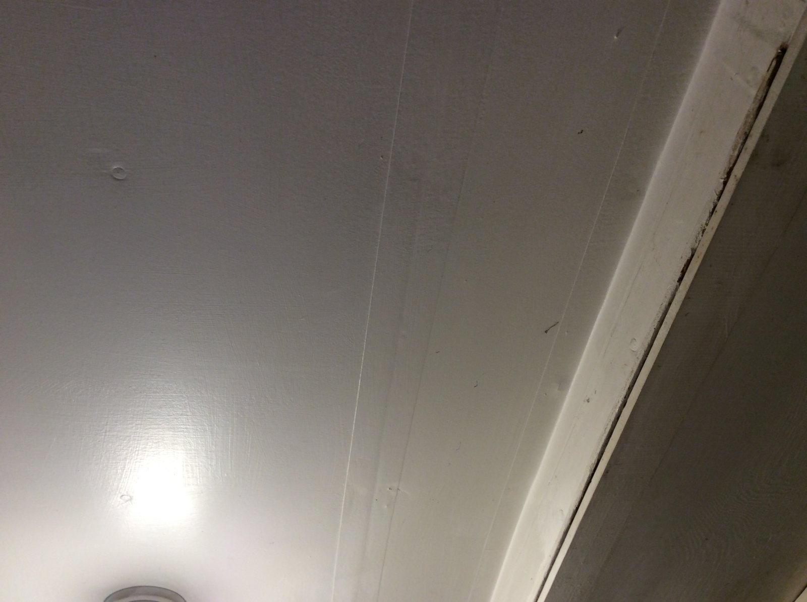

Having said that We have moved into a 4 bed property where in 1974 all stud walls and ceiling joints were done with pasted tape then wallpapered or just painted . Ive since redone it all except for a cloak room so just snapped one of the joints.
While it doesn't look that pretty, the joint tape does take some getting off.

fair enough but exceptions dont break rules.
how do you now it was paste whenit was done 34yrs ago? just curious
