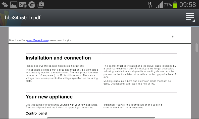

I read the instructions. They say its supplied with a flex but this must be changed. And fused at 16a. And a l or b circuit breaker. Would the 16 a do both from the dual plate or they better separate and two independent breakers

Looking at the specs they say flex length. Till I get them I can't tell if they have flex on them. If both were to run of plug top they would need 15a fuses. And wouldn't be good for the outlets
Further to this. You cannot plug these ovens in. There are no plugs with 15amp fuses.
The ovens will not have any cable attached to them. You'll need to supply the specified cable and connect the ovens to the dual appliance connector.

... In the instructions it says it is supplied with flex that needs replaced and a 16a fuse that comes of cu
Why would the cooker be supplied with a flex which needs changing by the consumer? Makes NO sense at all!

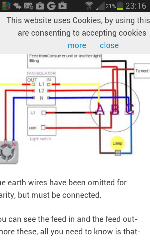

That's what it says see pic. See second pic .
