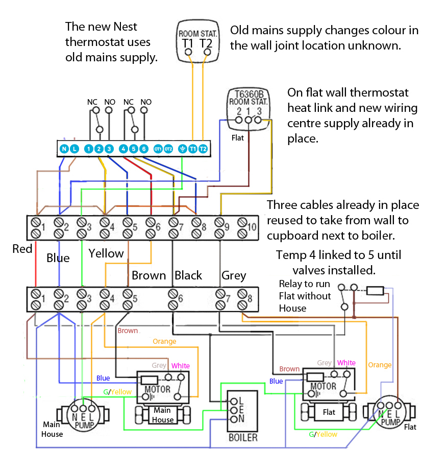

I have a haeting system in an old farmhouse where downstairs is new underfloor heating and upstairs on standard Y plan rads and hot water.

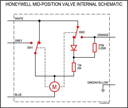

A 2 Honeywell port valve has been added in front of the 3 port valve to shut off when no heat is required for y plan but heat is required for underfloor manifold (fed from same pipework from boiler). To wire controls I am planning on wiring the two control panels (y plan and underfloor controller) in parallel to the pump and boiler so either can call for heat. To prevent unwanted heat to the Y plan when underfloor is calling I plan on wiring the orange wire(pump L) from the 3 port valve to the Brown wire of the 2 port valve which will open 2 port when called, and then orange wire out of 2 port to pump/boiler. Does anyone think there will be a problem with this being wired in parallel with the underfloor controller and would there be any problems from live back feed when underfloor switches boiler and Y plan doesn't? Sorry for long question but didn't want to go straight for relay options if not needed. Comments welcomed, thanks.

Hope all three can turn on boiler, tank thermostat, Y Plan and Heatmiser. Y Plan
is not the best design. White from room stat, grey from tank stat, but grey is line to stop DHW heating not to make it heat. It makes the motor drive the valve all the way, if DHW not wanted.
So
should that not be after the three port valve, is in front will also stop DHW? You will as it stands need relays, as you need to have three feeds to boiler, but these must not back feed, I have the same problem. I had to sit down and draw it all out.
1729860224944.png and after all that, still got it wrong. It should have two relays, only used one. So house can run without the flat, but the flat can't run without the house, however don't need latter so not corrected. Also today doubled up on house thermostat, have Nest and Wiser working now, but only Nest Gen 3 does DHW.
