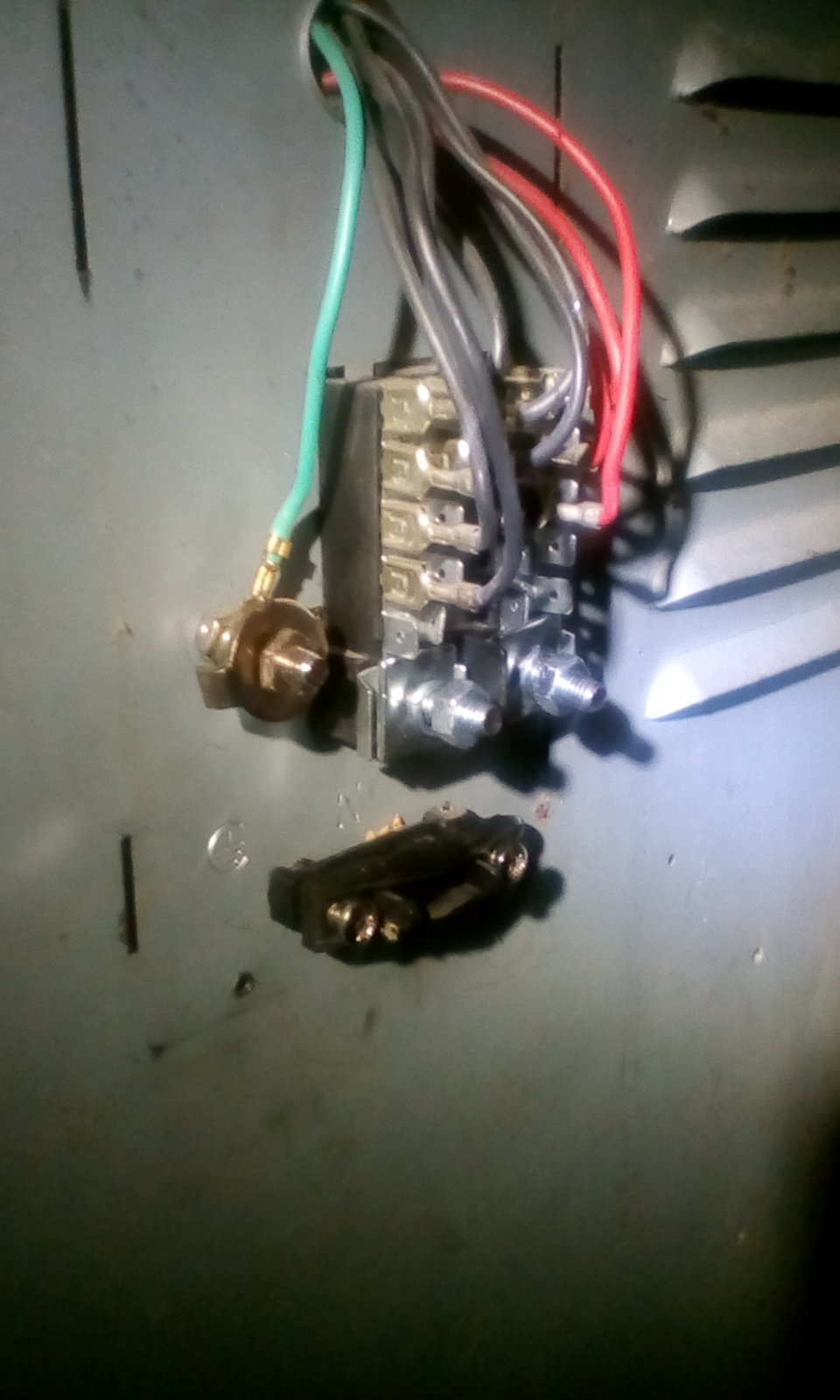

have a cannon 10425g range cooker.
has arrived with no power cable for electrics...
power box is there, can anyone tell me how to fit cooker cable to the power box please.
otherwise, please show us the inside of the connection box. I expect it has about five terminals and a copper bridging strip.

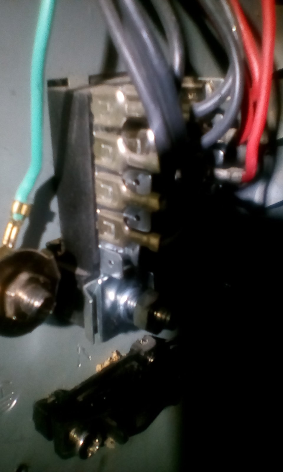

Pics looks straightforward with three terminals, earth to left, live to right, wires go under the square washer and nut secures.You need correct cable size for power rating.
Yes the second pic now added does tend to suggest it should be connected as Foxhole says as long as it has previously been installed on a single phase supply & all the links are correctly in place.
Thank you so much guys.. Yes I have the protection box. And a recent fuse box with RCB.
