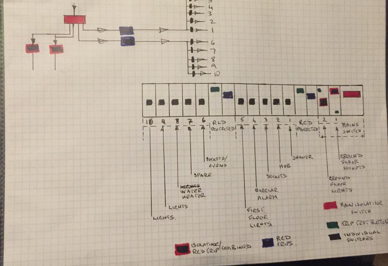

Ive just moved into a house which has a British General dual RCD board. It looks fairly new. There are two non RCD protected slots which have RCBO’s installed. The previous owner left a diagram which shows the two RCBO’s as ‘ground floor lights’ and ‘ground floor sockets’. What would the reason be for these two ccts to be protected in this way?

I guess he was keen for these 2 circuits to be working even if there was a fault elsewhere causing the RCD to be off
An electrical reason would be faults anywhere else do not take out the ground floor lights or sockets - and vice versa.
Yeah, was there a school of thought at some point that both downstairs lights and sockets be be protected like this.i was concerned that there was a recurring fault on one of the ccts possibly causing nuisance trips. Not that that’s happened since I’ve moved in.
Not really.
That is a possibility. To remove some accumulated earth-leakage.
