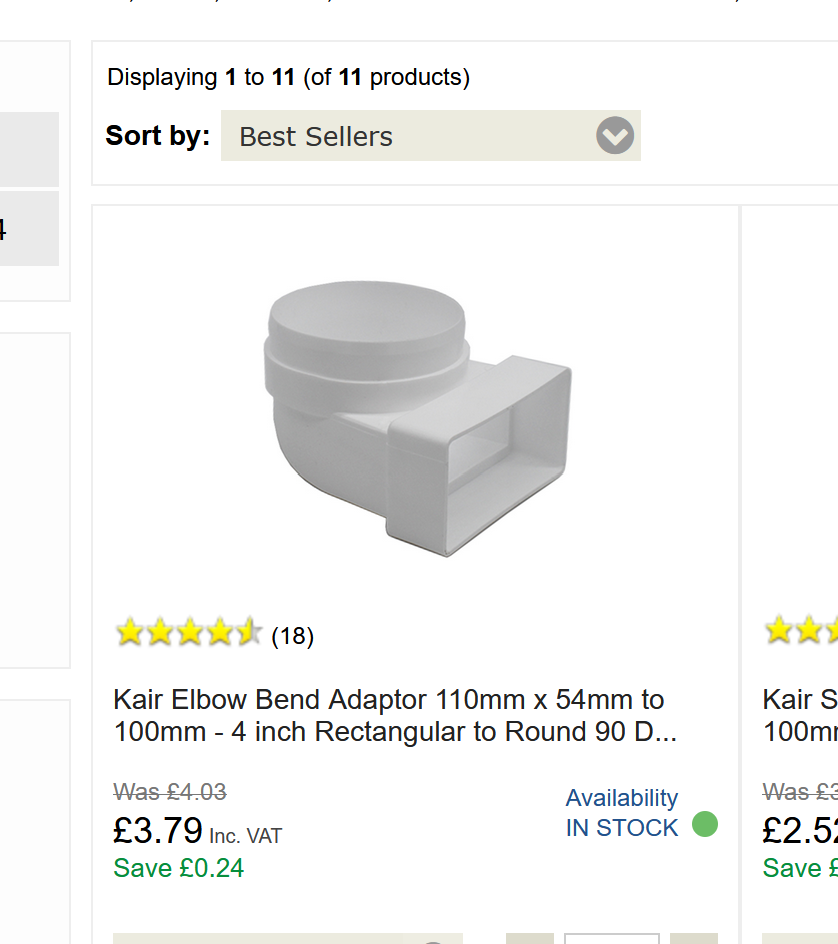

I need to vent out the tumble dryer along a 2m stud wall to external. The wall is constructed of 63mm CLS timber. I was looking at cutting through the uprights with 54mm venting am i literally cutting it too thin as i guess im going to end up with a max of 4mm walls ifi cut the slots dead center. Or should i be using narrower 24mm ducting which im concerned doesn't give enough air volume? Thoughts appreciated.

Does your duct have to be invisible? Yes cutting cls to that depth will make the wall very wobbly. Your best plan B will be the flat 110mm equivalent ducting fixed to the wall surface

Im guessing re studwork if i cut the slow really low it won't comromise the stud so much or like you say i run it external, thanks for your thoughts all the same, most appreciated.
Presumably your stud wall has plasterboard on it? What you could do is sink the (flat) duct into the CLS then plate over it with 5mm steel strap (TS/Screwfix sell it). To be really posh you'd rout out the cls as well so the 5mm steel was flush with the surface, then plasterboard over the top and job jobbed.

in a horizontal location 25% or16 mm would be maximum in the correct location
now in vertical its still the same but iff you say added 12mm ply to both surfaces rather than plasterboard you may get away with far less but you now start to become non standard or not compliant so possibly a problem in the future??
Rectangular duct fixed to the surface of the wall would do. At skirting or ceiling height will not be obtrusive
