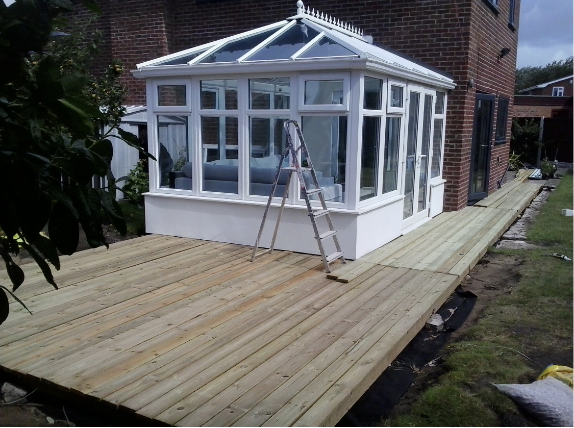

Hi all,
I've got a steel Durabase conservatory base to install and these require 5 concrete pads measuring 400mm x 400mm x 400mm for the steel base "feet" to sit on but on looking at a lot of you tube videos i've seen quite a few use concrete foundation blocks and then just fix them in place with ready mixed concrete as opposed to filling the entire hole with ready mixed concrete but given this will hold not only a 3m x 3m steel base it'll also hold the floor to ceiling windows and a flat roof are these ok to use ? the one's i've seen are only around 3Nm or up to about 7Nm strength bearing.
Anyone fitted these as a foundation at all as these seem a LOT cheaper (and easier) than pouring 0.5m3 of concrete in there ?

I’ve got a durabase on my conservatory.
I recall seeing videos of them being built into existing patios, etc but like anything it depends on the ground conditions and how well the original patio was done. I wouldn’t recommend going down the concrete block route personally.
From memory the pads have to be 450mm concrete cubes but personally I just did a 500mm x 500mm strip foundation. It’s not that much effort to do the pads so I’d strongly recommend doing it in line with the manufacturers recommendations.
@^woody^ these come with a 25 year manufacturer guarantee (mine didn’t as it was 2nd hand). The plus points are the ease of construction and you get a steel framed wall with cement boards for brick slips to be fixed to on top of the base - so you end up with a conny with a dwarf wall base without needing any brickwork laid - so handy for the diyer :)

For 5 pads, I would just be mixing myself.
I can’t imagine it would need that much material...but I’ve not done any calcs for you situation.
A ton bag of ballast, a few bags of cement, wheelbarrow and hire a cement mixer for a day. Jobs a goodun.
