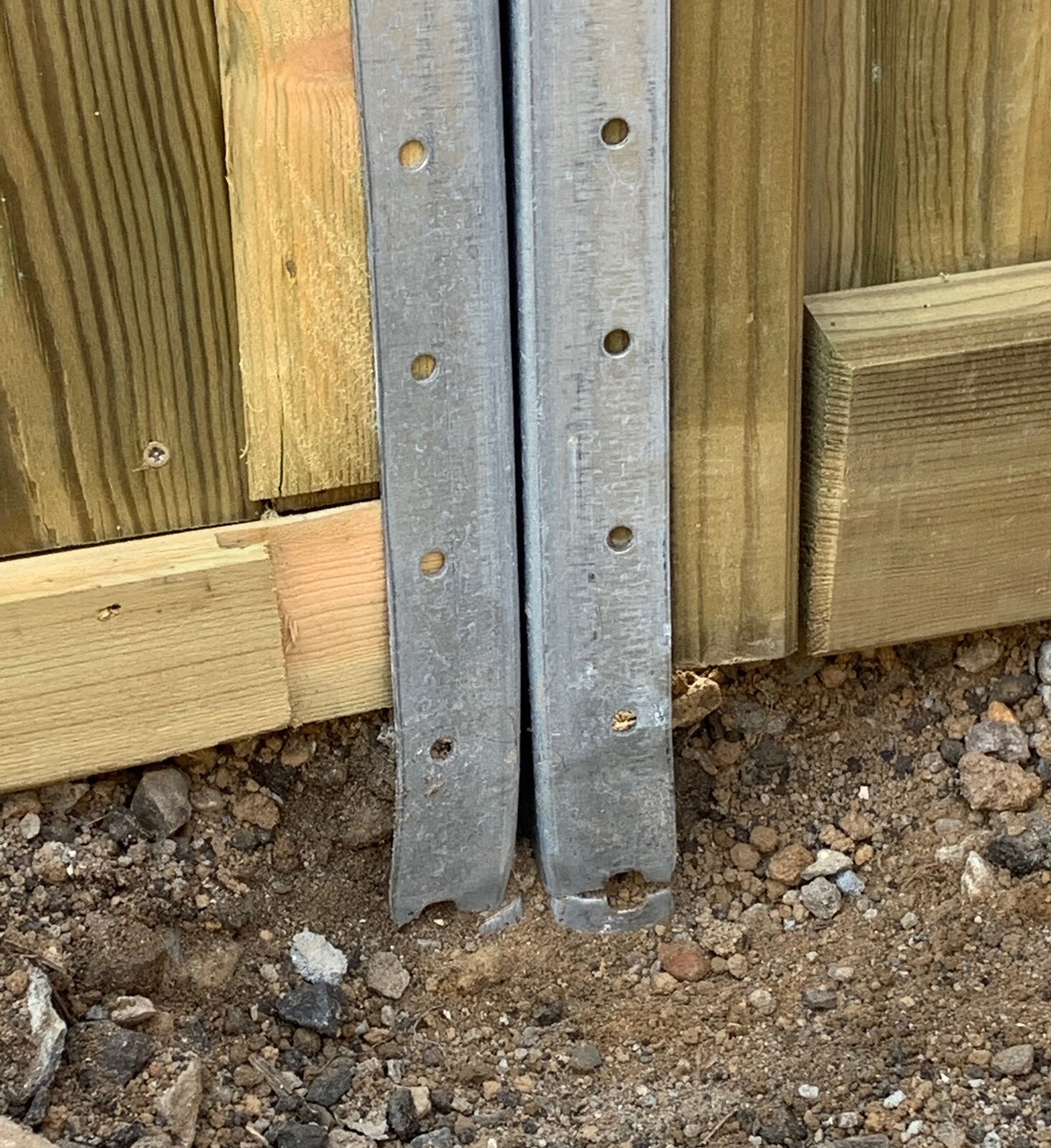

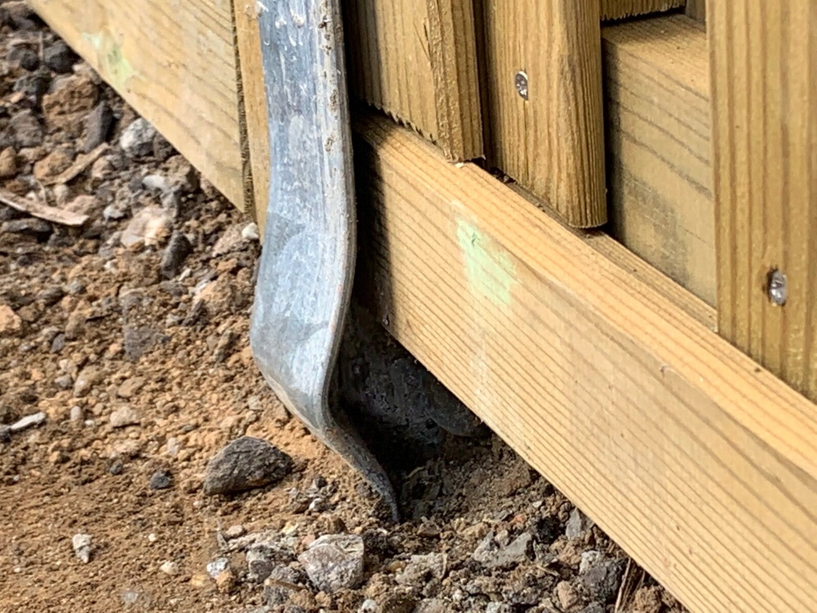

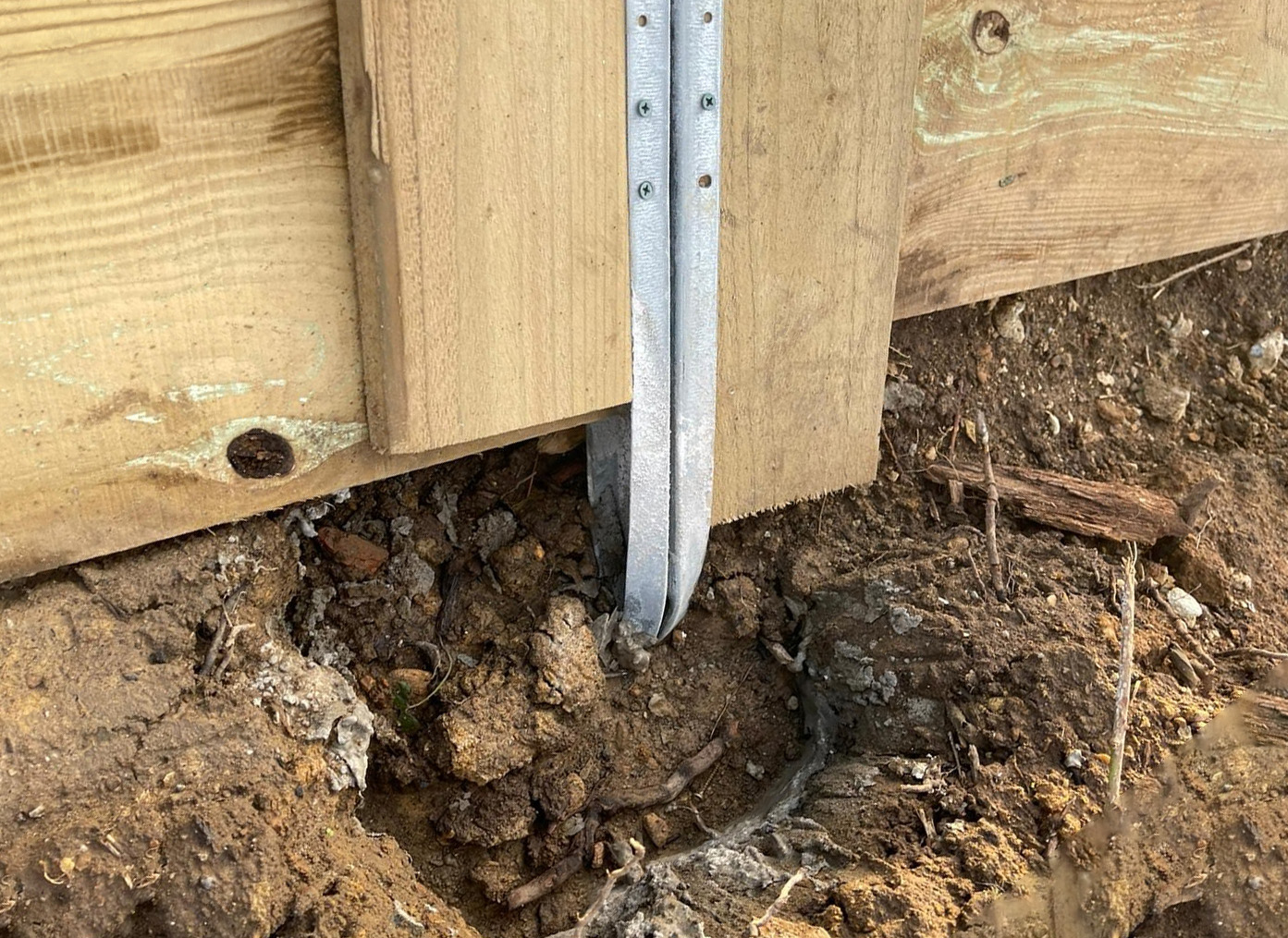

We run a family business, and part of what we do is fence installation. As my dad is getting older, he’s found it more challenging to install the heavier posts and fences, so we've started using more Duraposts. However, being on the coast means we are often dealing with strong winds.
We have had two separate jobs where the posts buckled at ground level, causing the fences to fall over. Luckily, one was in a business yard, but the other was in a garden, and the customer was understandably upset.
Moving forward, I think we’ll return to using Jacksons heavy-duty Jackposts in gardens or concrete posts if the customer is not concerned about the appearance. We are worried about the other jobs we have done though.

I live in a windy coastal area and only concrete lasts. It does not rot or rust. I have had metposts rust away and break.
I paint mine with dark brown masonry paint so it blends in with the fence stain. This also prevents rain penetration, especially on the tops, which you will sometimes see causes the steel reinforcement to rust and the concrete to spall.
Thanks for the replies. Those pictures make for grim viewing so maybe time for a rethink!
