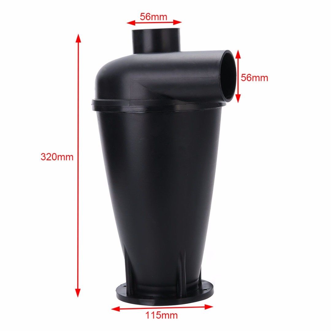

Another approach may be to take a cheaper extractor and fit a pre-filter cyclone and maybe a HEPA filter to it. The pre-filter cyclones look like this:
It is necessary to make your own drop box (basically a bucket with a sheet of ply on top where a hole has been jig-sawed out to take the bottom of the cyclone) and source some flexible hoses and Jubilee clips, but these pre-filter cyclones have the advantage of spinning 95% or more of the dust out before the air even gets to the vacuum extractor. That means the filters in the vacuum last a very long time and that a single dust bag in the vacuum may take months to fill up. Can be used with a very cheap vacuum to make a very effective dust extraction system if you don't mind doing a bit of DIY
