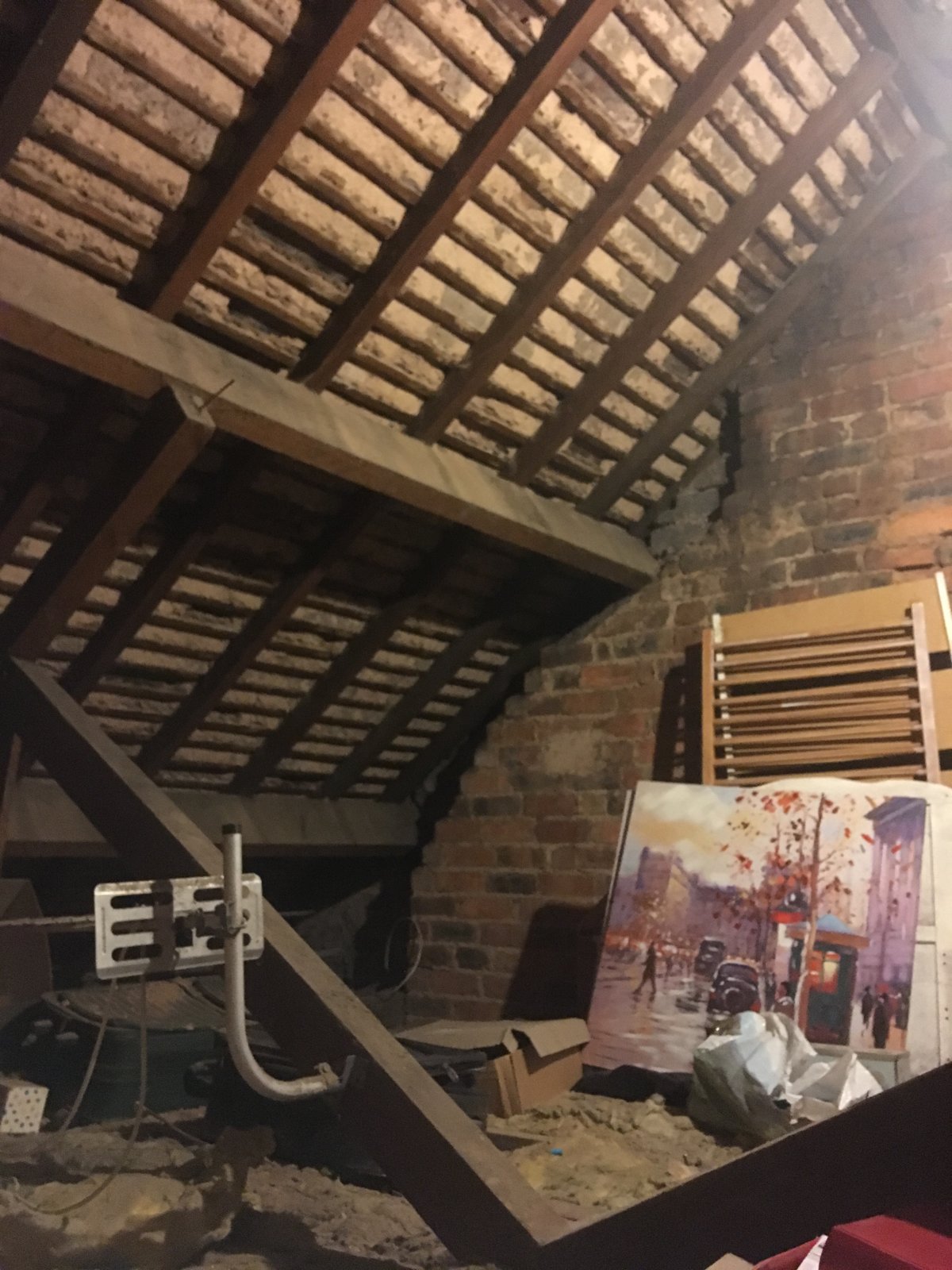

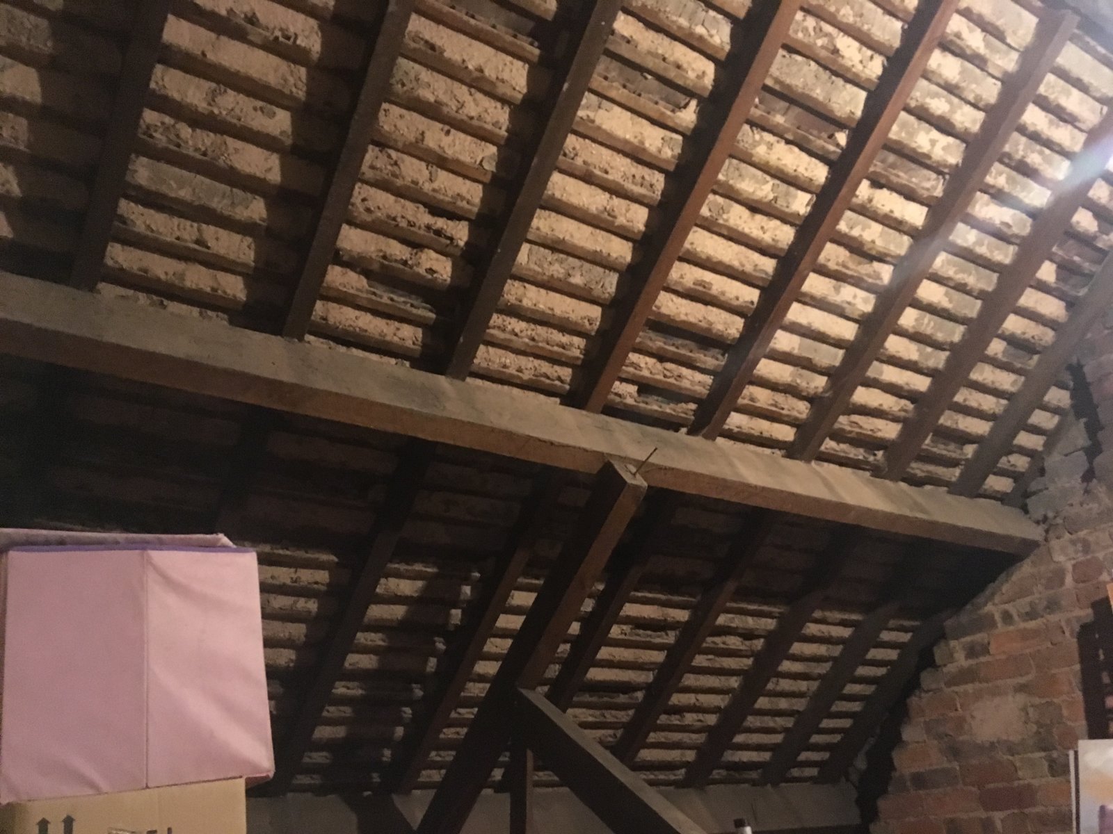

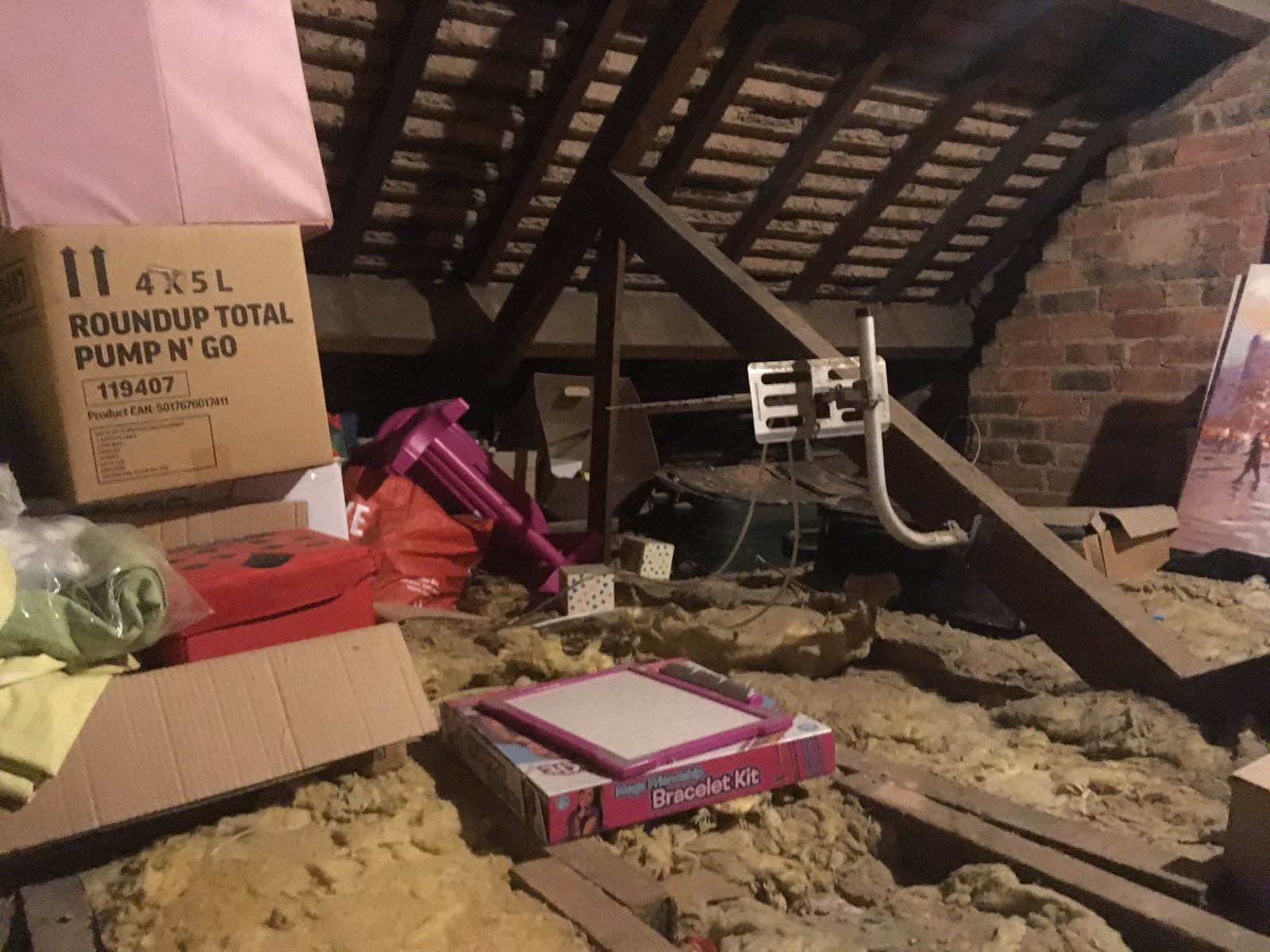

I’d like to try and sort our loft out, as at the moment when we open the drop down hatch, we get showered in debris and dust which is, I assume, being created when the wind whips up. I appreciate a new roof would be the ideal and have felt laid under new tiles but if I’m honest we are hoping to move soon so really want to do things that aren’t going to cost us the earth but make a difference... most notably here, not showering us in muck when we drop the hatch. I’m going to board it out with boarding or floorboards but just wondered if anyone had any suggestions to lining the roof to stop the dust blowing around. I’ve attached some pictures to give you an idea what we’re working with. Thanks ever one in advance..

I am not a builder or roofer but something like tyvec breathable membrane stapled to the roof would help?
Thanks for your reply!! I’ve literally just been reading about something similar after googling what I wanted to do.. sounds like a plan..
Done the exact thing at my last house and this house .... it just stops everything getting covered in dust ....
