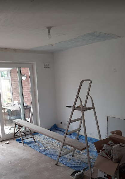

Just wanted to add that I used the gel too, even on ceilings. It was still hard work but the gel turned what would have been a horrific job into something merely very unpleasant. It's expensive but my ceilings are relatively low so I didn't want to lose height by boarding. I did get the artex tested for asbestos and it came back clear so was reassured on that front. You should still wear a mask of course. Score the artex the day before and roller on diluted gel to get it working. Do a section at a time without around 45 mins for the gel to take effect. On the thinner parts diluted gel actually does the trick (saves money and fast to apply with a roller). Clear up regularly- the gel will make it sticky and if you tread in it then you'll get it all over the house. Something like https://www.toolstation.com/prep-heavy-duty-scraper/p29412 for the main parts and a smaller scraper for detail work.
Finishing stretch of the lounge.
Still got the bathroom to do but was happy to get the rest of the house done. The walls are still in their scraped state (just PVAd to seal them)- I prefer that to the artex.
