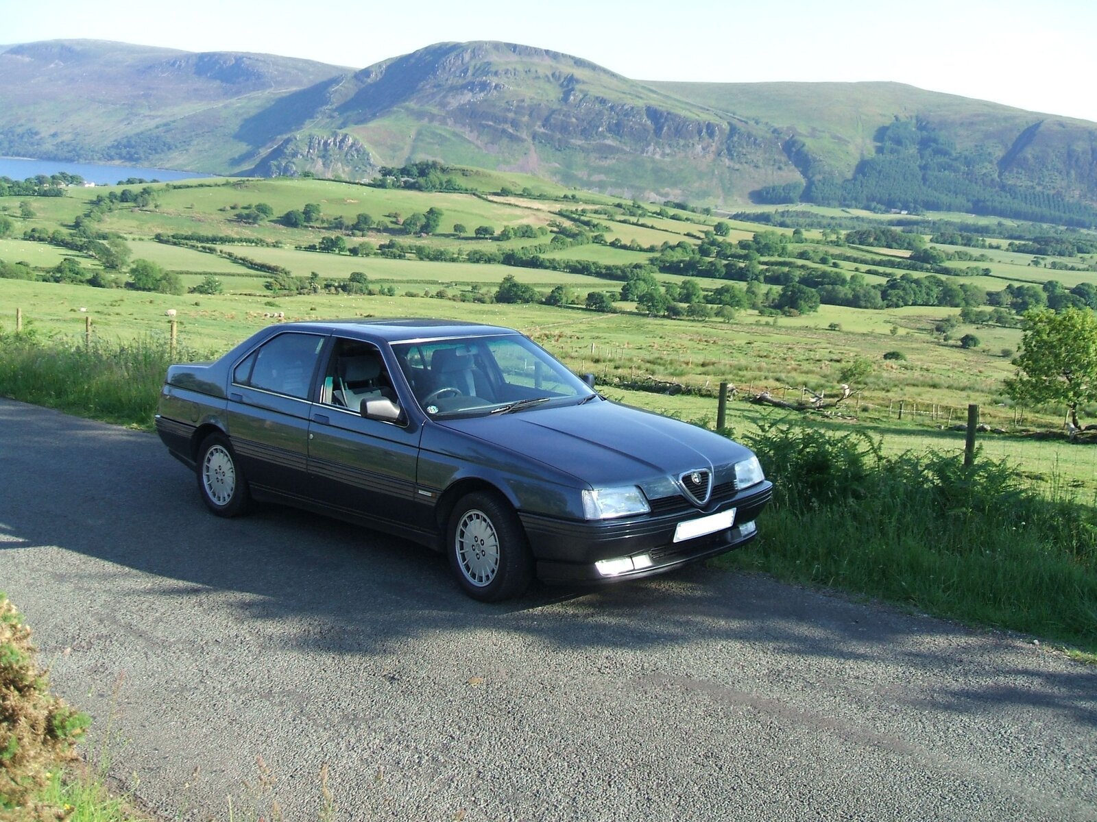

By the way, have to ask -- what's the car?
Interesting stuff! Yes fuel sat in the tank for more than a month was on my mind, hence the post.
There is a steel fuel line from the tank to the pump, thereafter it is hose to the modern carb which I think uses a plastic float (need to check that). As it happens it was Gates' hoses I used. I recently changed the timing belt on my 406 and used a belt kit from Gates', I know the name is good.
Not long after posting this, I decided that next year (maybe even over this Winter actually) that I am going to remove and strip the tank, maybe replace all the steel pipe with rubber and overhaul the fuel pump. It's one of those AC Delco ones so replacement diaphragms etc. are around.
Have a look on the hose, to see if there are any standards written on it. As you say, Gates are a reputable brand, but of course, their older hoses won't be E10 compatible either. Your steel line will definitely rust internally, with E10, (less so with E5, but to be honest, any ethanol will do it, so it's just a question of how fast). The float might well be plastic, but it's tiny little things like the pin it pivots on, or maybe some jet holders, etc, that will suffer. You might be lucky, they might all be brass.
Mine's an old Alfa 164.
