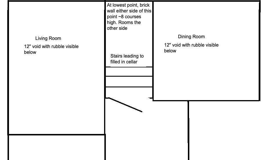

Pic 1 - Lower portion of external brickwork, three bricks deep.

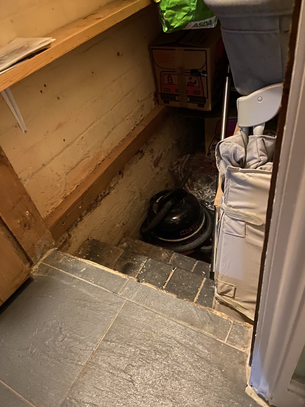

Pic 2 - Attempted shot of the steps leading into the cellar (10" tall each)

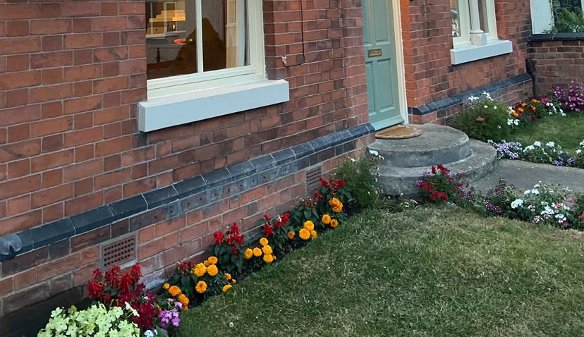

Pic 3 - My crude diagram of the floor layout
