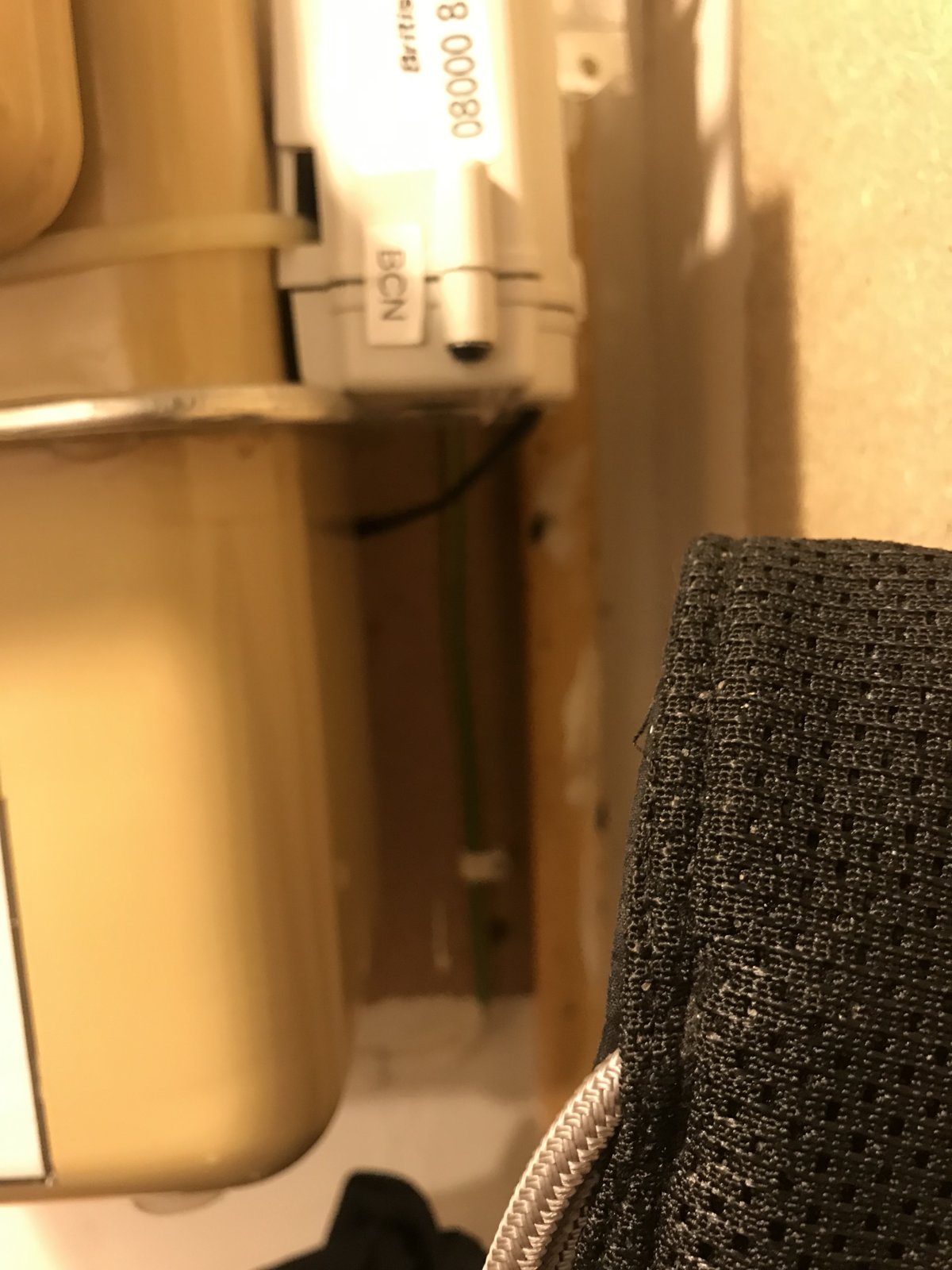

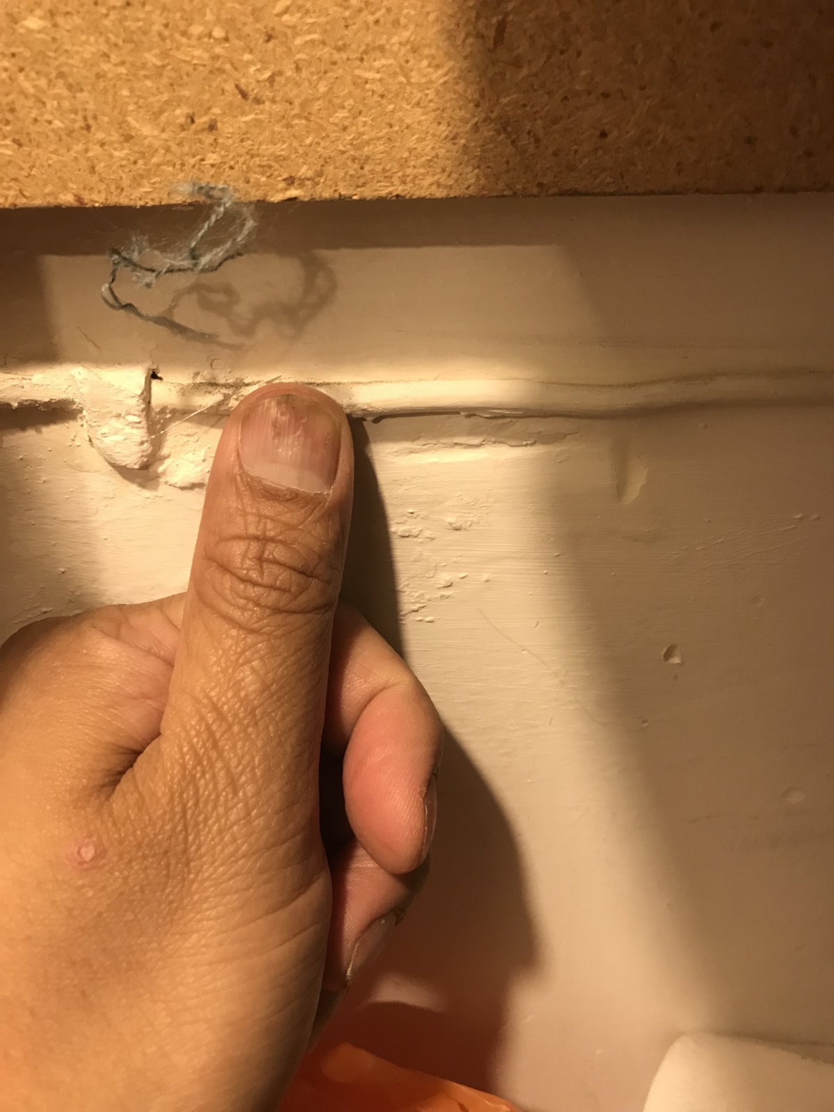

my house was build in the 70s/80s, the wiring and consumer unit are the original. I am planning on moving house so undertook a electrical safety check. the main findings were that gas and water pipe need to be bonded. the current bonding is apparently 6 mm - new regs mean it should be 10mm so I am told.

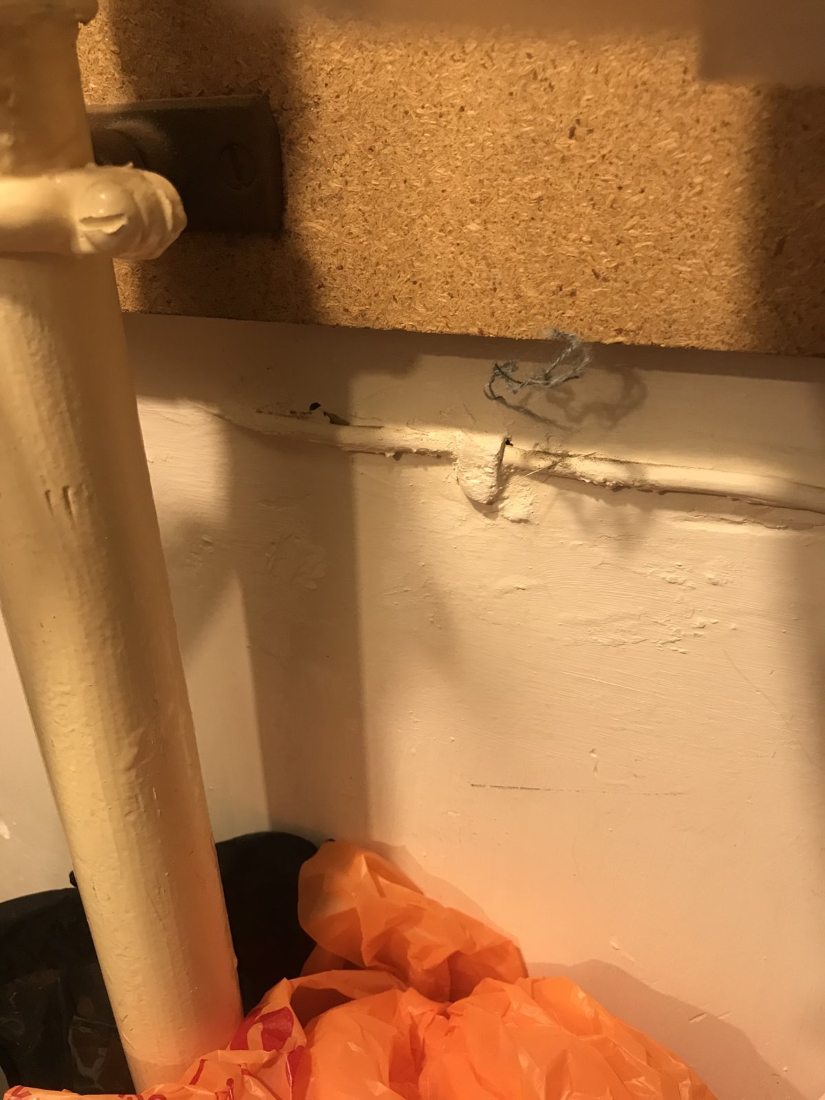

1) The electrician has suggested he runs a cable from the consumer unit through the ceiling to the gas mains and under the sink in the kitchen. This is not ideal as this will cause a lot of mess and not something I need right now as we want to move. The estimate is 600+VAT, which seems excessive considering its a small 2 bed property.

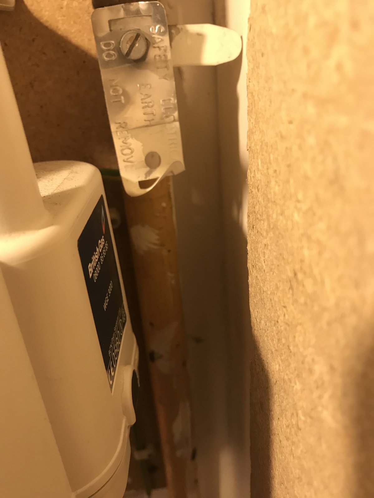

2) I did notice the the previous earthing involved a metal tag around the pipe with the earth wire buried into the wall, does this method not suffice anymore.
3) The main water inlet (stop cock just outside the front door) is made of plastic.

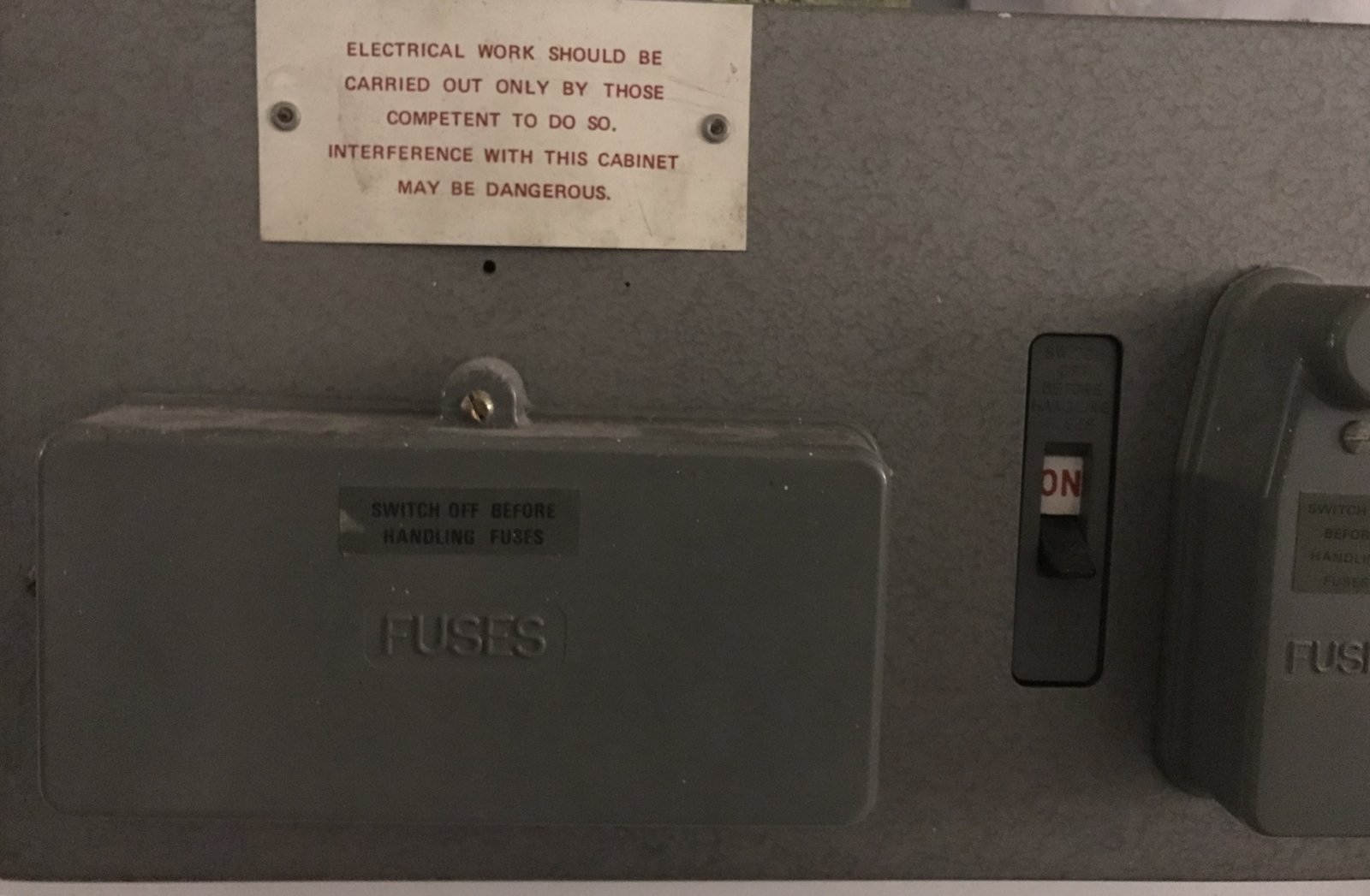

4) A surveyor did a homebuyers report where he claims the installation does not have a modern cut of device. He claims this is a clear fire hazard. And is insisting we install a new consumer unit with MCB and RCD.

it is most unlikely that he has any electrical qualification. You might like to ask him.
He can't insist you do anything. Potential buyers are entitled to form an opinion on the desirability and value of the house as it stands, or on what it might be if you made some changes. The amount they are willing to offer may vary. The variance might not be the same as the cost of the work the surveyor suggests.
Your installation looks like it might be about 40 or 50 years old and a potential buyer may well decide to carry out extensive rewiring and modernisation, for example adding more sockets and modern switches and outlets according to his taste and preferences. Any work you do may differ from them. This buyer is also likely to carry out redecoration and other works, which are often more convenient to schedule after renovations.

The bonding would conform no less it if was done with surface wiring, for example tacked to the skirting or picture rail. This would be much cheaper but less elegant. lifting floors is quite a lot of work.
this is what is effectively there at the moment, I guess I could DIY it and replace the wire for a 10mm to no longer a C2 Issue.

You could achieve the desired compliance by running a 10mm² conductor (green and yellow wire) between the two and connecting to the existing bonding conductors and pipes.
What are the positions of the gas and water supplies? Are they near each other?
One is under the stairs, the other is about 12 ft away in the kitchen - no easy way of getting wire without surface mounting or drilling through walls.
