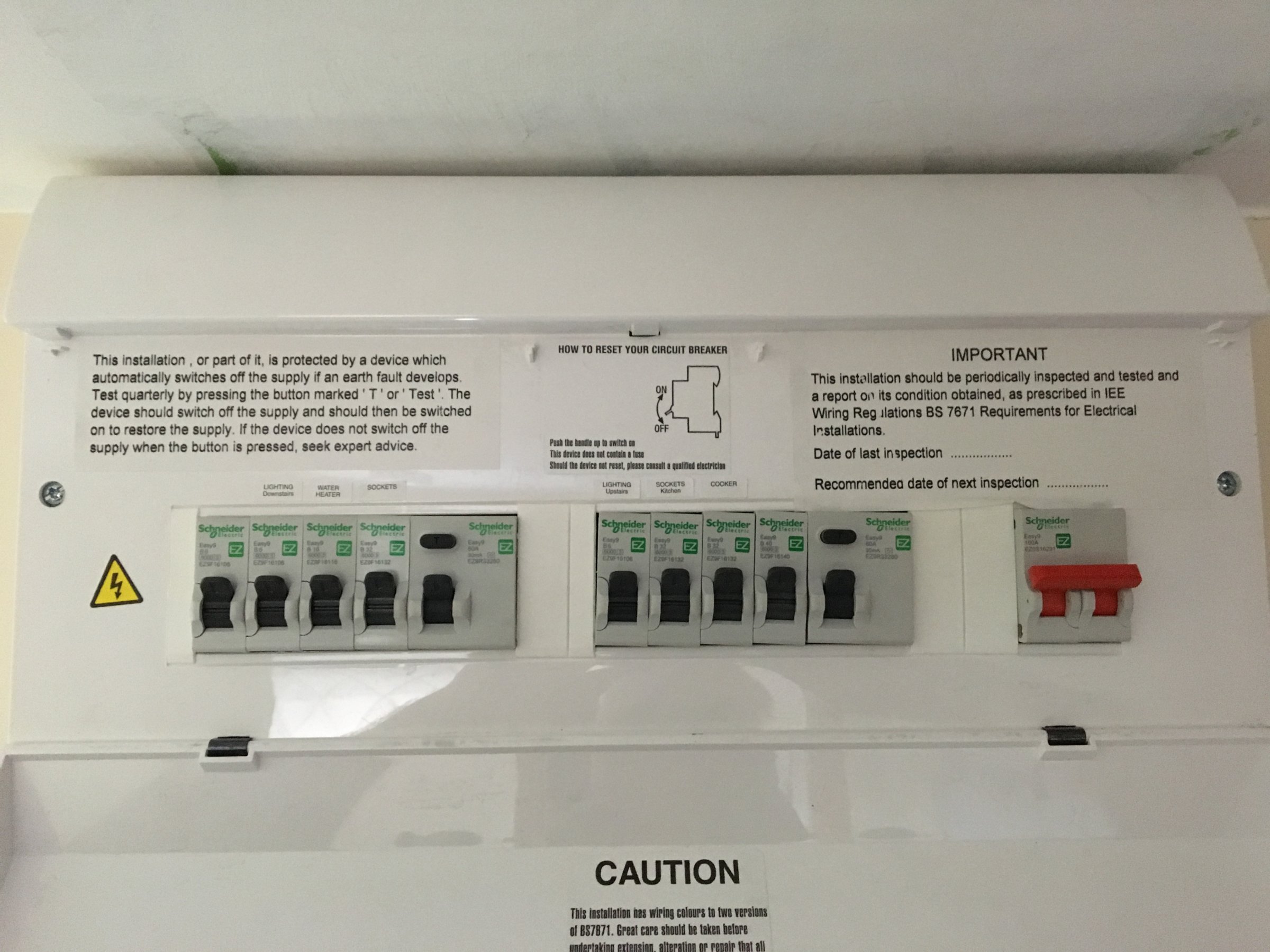

Actually just to be sure - can someone verify from the image that these are RCDs and not just mcbs please?
As you have been told, your photo confirms that all your circuits (including those serving your bathroom) are protected by RCDs.
However, don't forget that, as EFLI explained to you, there are two other conditions (in addition to RCD protection) which need to be satisfied in order for it to be permissible for supplementary bonding to be omitted. It is very likely that those other conditions would be satisfied in your electrical installation, but you would really need an electrician to confirm that.
Kind Regards, John
