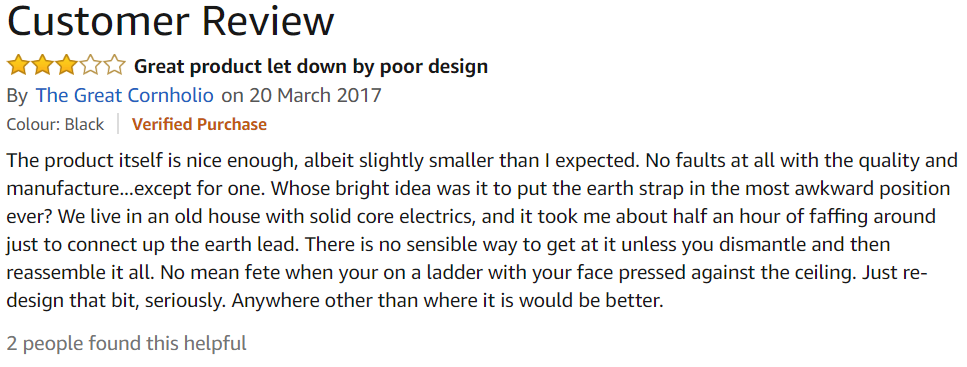

I only ask because somebody reviewing the light, complained about having to take further steps to earth it.

Got a link to that review?
Hi BaS. This is the review (the top critical one)
https://www.amazon.co.uk/ROMKE-Ceil...iewpnt_rgt?filterByStar=critical&pageNumber=1
now that I read it again, it matches up completely with what ericmark said.
The problem with pre-1966 homes is that they often had no earth connection at all, in which case lights that require an earth cannot be installed.
The review is just someone who had no clue what they were doing, and for reasons known only to them decided to dismantle the item rather than connect the wires to the terminal block supplied.

I'm not sure why that reviewer was struggling so much, if the op's pic is anything to go by.
Maybe the manufacturer took notice and redesigned it. The light fitting is one of the easier ones to connect - with plenty of space to house joints and extended bits of wire and the like.
