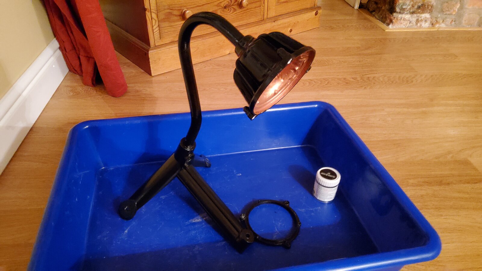

I had an old Coughtrie outside lamp replaced with a floodlight, so i thought i would make an indoor task light with the old fitting, a sort of steampunk style but without me having to wear victorian clothes.
It still has the original ceramic lampholder, which is fine, but no eath lug. I suppose it was so high up, no one could reach it outside. That and the fact it was the 1950's.
Ive drilled a hole in the lamp, near the lampholder, and am going to crimp a ring crimp onto the earth, and will test for continuity between plug and body.

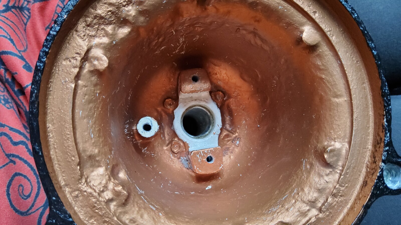

Mine looks a bit different. But heres a photo showing the hole ive drilled on a sort of lug, Maybe the earth was supposed to just wrap aroung it,
Now ive got 2 more snags.
!. The metal body doesnt seem to conduct a current so im not getting continuity anywhere at all. Maybe a good thng.
2. I cant think how to make a cord grip. Maybe push a cork in the base after wiring it?

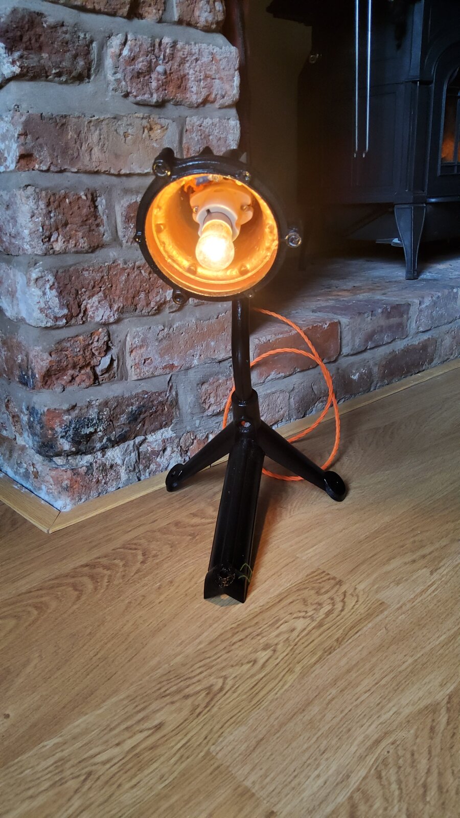

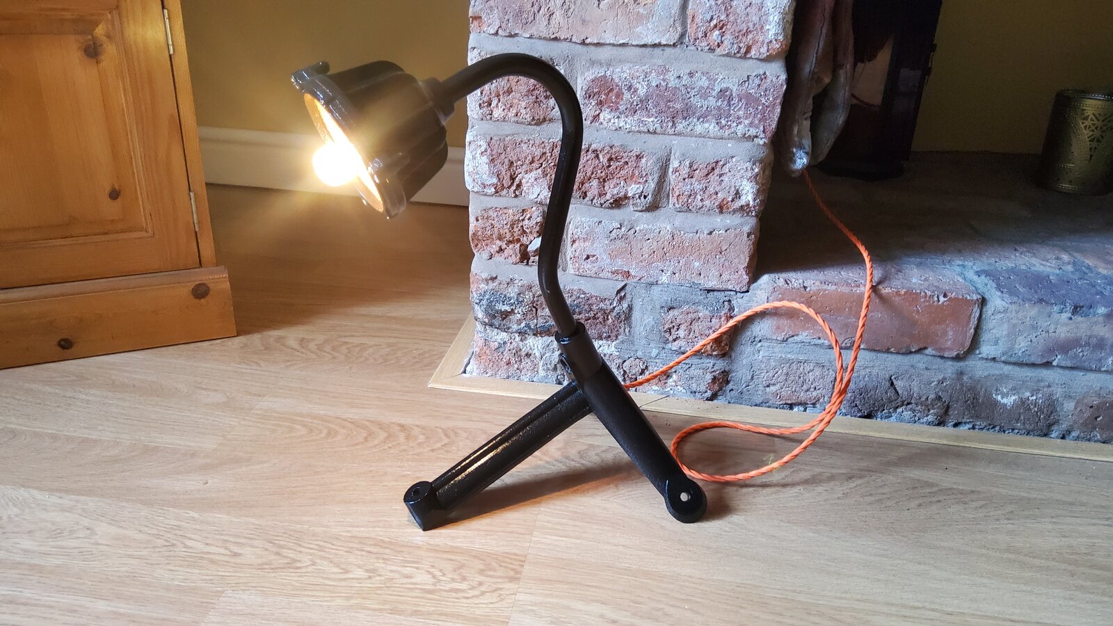

Ok. Finished. Found a 15w pygmy lamp in a drawer to test it. Woah, it's too bright without a shade! :cool:
I wonder if they make those gold vintage type LEDs in pygmy?
Anyway, I'm very pleased with it. And it only cost the price of the fancy braided cable and a plug. I used leftover bits of paint.
