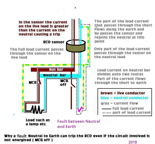

I’ve just finished replacing a light fitting, as usual I turned off the associated breaker, checked for no voltage with a detector pen, then went ahead with the replacement. However when I touch the earth, the rccb tripped causing the rest of the house’s electric to go off.
This can consistently be replicated, which I’m fairly certain isn’t normal, does this mean I have an earth fault that needs to be corrected by an electrician? Any ideas?

How did you "touch the Earth" , finger or screw driver.
If the Neutral touches the Earth then even if the MCB for the circuit is switched OFF there can be a trip
Thanks Bernard, it was with a screwdriver, so there’s a chance that it could have been earth touching neutral, the diagrams really informative!
Yep! Isolating at an MCB only isolates the live, neutral remains connected and will likely have a different potential to the earth - so when shorted, it trips..

Not very practical. To isolate means turn off both lives, both line and neutral, and in many houses that means half or all the power, my house would need to be all power. With a TN supply it is permitted to just switch off the line.
I would guess it is a neutral - earth fault which is unlikely to cause a danger.

Nothing wrong...you touched neutral to earth when connecting new fitting which caused it to trip
