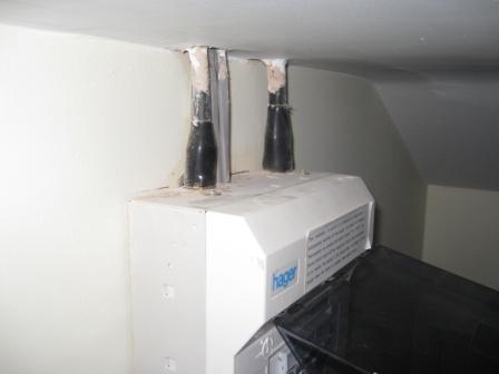

cu the gland should be fastened through a banjo ring that is also bolted to the cu and has a separate earth wire
The main house cu is plastic, the gland is bolted to the case but no earth wire... This then goes outside (above ground fixed to house wall) and back inside to a small garage unit. This is a metal box and has the banjo ring...but no earth wire. The metal case is fixed to the earth block, so there is 'some earth' there :rolleyes: .

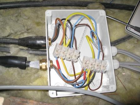

But the garden lighting circuits go to wall switch, with switch live going up to a plastic junction box in the loft in T&E, where is connects back to the SWA
I've pulled the plastic back to show the connection which appears ok (except no earth again)

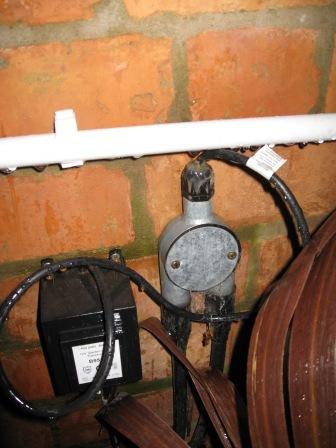

From there its into the garden where the SWA terminates in various conduit boxes eg
Appear to be connected up correctly.
So...I'm pretty sure the conduits aren't earthed. What should be done at the cu's to improve the earth?

Personally I would say the best thing to do is make sure the outside lighting system is RCD protected then earth it with a seperate rod kept away from any metal that connects to the PME earth.
If you go down this road make sure you clearly label that there are two deliberately seperate earthing systems and test the rod gives an adequate earth.

Should the 12v transformer be installed outside though? I thought these usually have 'indoor use only' written on them.
That hager CU is metal clad, and the banjo is bolted to it.
You only have to earth SWA at one end providing there is an earth running within the cable.
