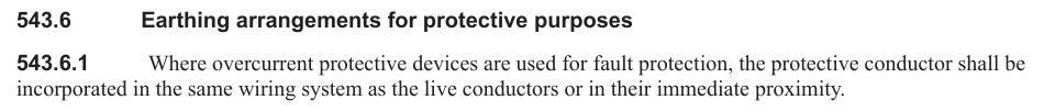

I really don't think that any of the electricians here will recommend doing that.
Not permitted, protective conductors must be incorporated in the same wiring system as the other conductors of that circuit.
Would I do it? Plain and simple No.
The big problem would be any future work could so easily make the part of the circuit you tap into redundant and the person doing the work may never know the additional connexion was there.

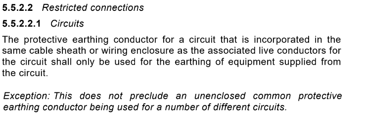

Interesting that this "practice" is "not permitted" in the UK.
It is permitted in North America and Australia, the thought being that, if a Protective "Earth" is required it does not matter from where it comes, since it normally carries no current.
The wire used in Australia is the same as is used for "Equipotential Bonding".

Interesting that this "practice" in "not permitted" in the UK.

BS7671, UK:
TT does not apply there as overcurrent protective devices are not normally the means of fault protection.
From AS/NZS 3000:2018
