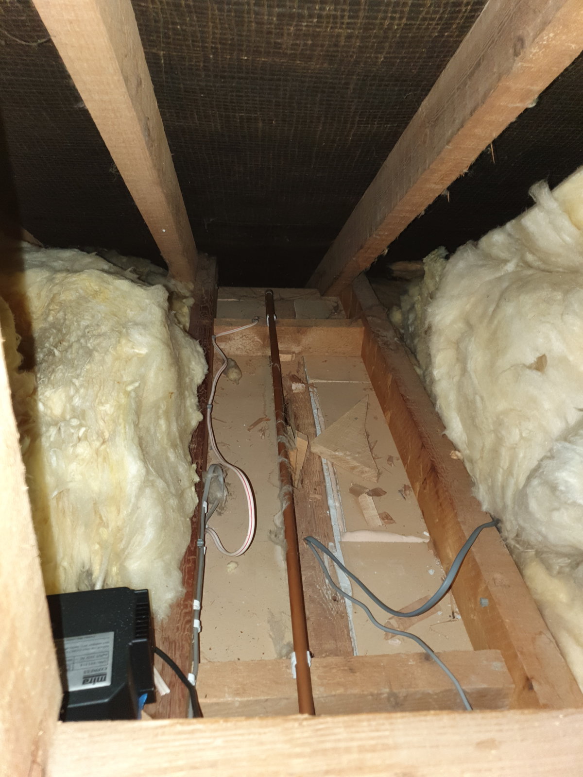

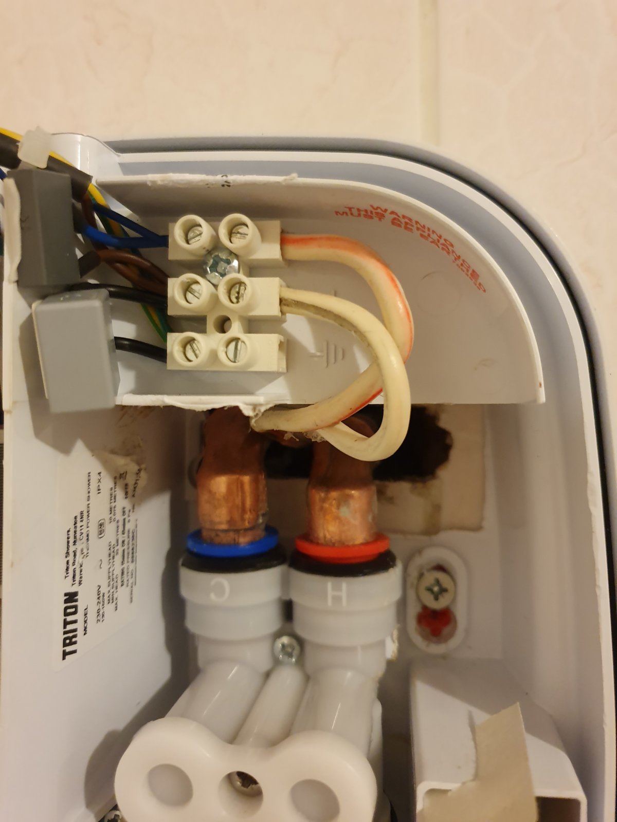

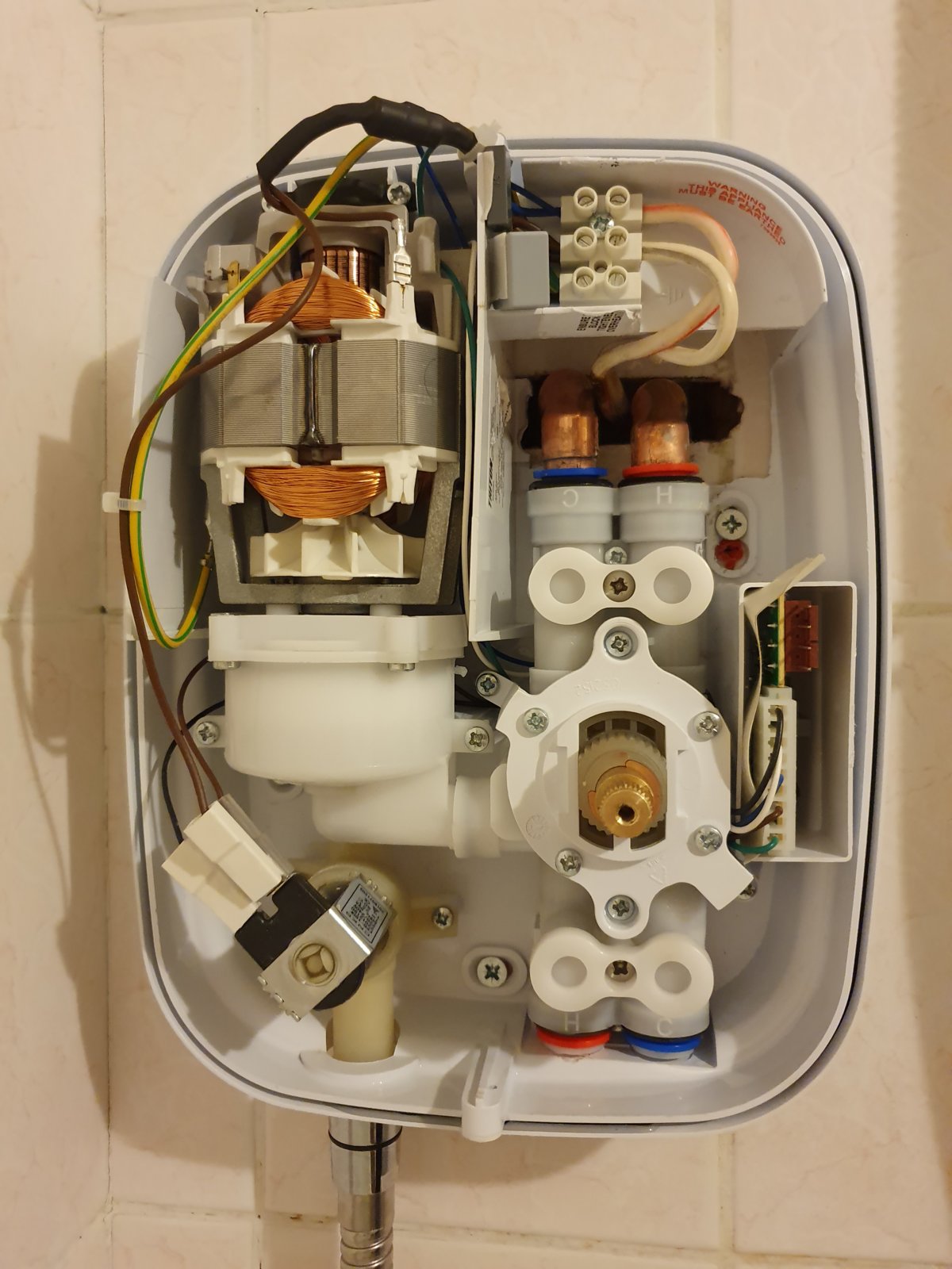

Hi all, I hope you can answer my query. To cut a long story as short as possible:
I recently had my old Mira Express power shower replaced (by a plumber) with a Triton Thermostatic power shower. The Triton has an earth connection inside whereas the Mira did not. I'm not sure if this is because the pump was double insulated or whether it was being earthed from the transformer in the roof (see pics) but either way I believe I need to now earth this new Triton one.
I tried my best to pull the old 2 wire cable out and up through the roof but it is set solid in what I can only imagine is cavity insulation (looks like expanding foam). So my question is whether it's safe for me to use an earthing clip on the cold pipe inside the shower and then earthing the other end of the pipe in the roof (where I can easily access it and supply an earth).
Is this safe/viable or will it meet/break any electrical safety standards? I ask because I obviously don't want to electrocute myself/my family and there appears to be a fault in the unit I had installed so the plumber told me to call out a Triton engineer to get the leak fixed (another long story). Obviously if the Triton engineer sees it without an earth he'll just condemn it and not fix the leak. I have until the 30th to try and resolve this and to save the cost of an electrician coming out I was hoping bonding to the pipe would be sufficient. Any help or advice would be much appreciated. I've attached a few photos for your viewing.
Many thanks, Jon.

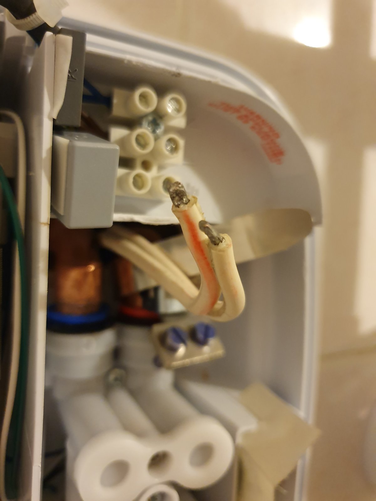

Hi there, the power is supplied by the flat 2 core (with earth) grey cable which you can see tacked on the left-hand side of the picture in the attic. This does have an earth and goes down into the isolator switch. Then the live and neutral come out of the isolator and it's the white 2-wire cable (with red line) which goes down through the ceiling again into the shower unit.
The white cable is not really suitable for that use (no sheath) and should ideally be replaced.
Yes, you can use the water pipe as you propose.

It looks to me like your 'old' shower was low voltage & was fed, via the black mira PSU in picture three, via a 2 core flex.
Your new shower requires mains. It should not be supplied via that original two core flex - this was intended for low voltage (probably 12 or 24V).
As EFLImupudence has advised above, you should replace the white cable with a 3 core cable which is suitable for use on the mains.
Did your plumber cut the white cable & connect it into the shower isolator? If he did, I suggest you don't use his services again - he has put you & your family at risk.
You do need to fix this before the Mira engineer arrives. Obviously this wiring error is not responsible for the leak but I would strongly suspect that he would condemn this installation and decline to touch it until it is corrected.

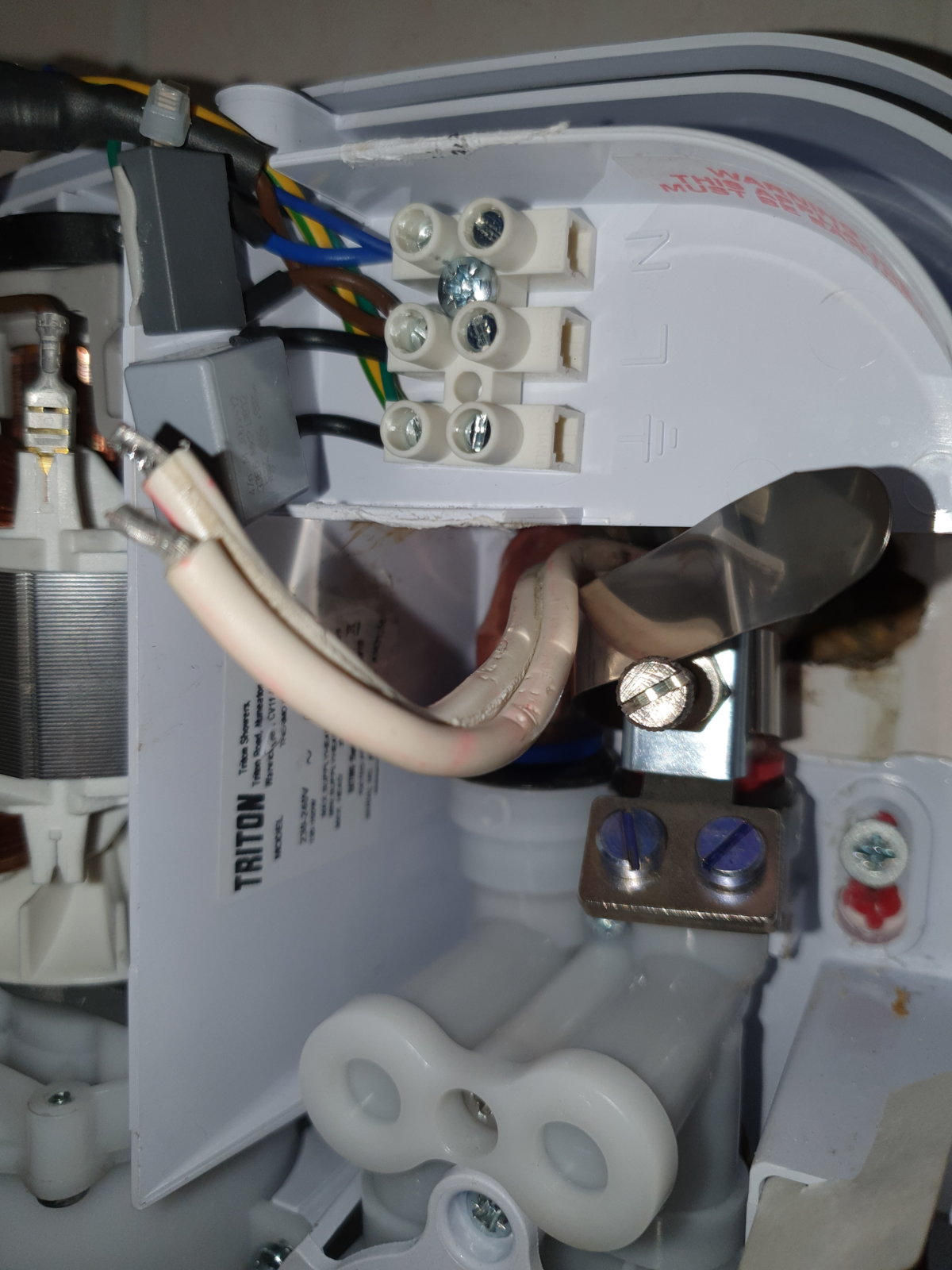

@EFLImpudence I've tried again tonight to poke around and see if I can get this cable loose but to no avail. It's comes out from the wall at almost 90 degrees and the expanding foam is all around it. I'm guessing it's quite possible the the white cable is actually clipped to some struts on its way down too - either way I can't get it to budge.
Looking again at the original cable it seems quite a thick one - thicker than the 2.5mm cable cores in the cable I bought to replace it (see pics) so surely this is safe enough to run a little pump? Remember it's not powering an element to heat water so I presume it doesn't draw too much power...
