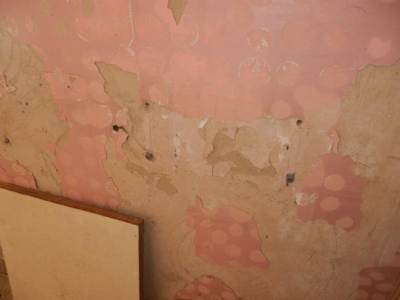

I talked some plasterers to help me refurbish a house. They say it will be easier (and cheaper in the end) to put plasterboard on top of the existing plaster than to try and re-plaster. This is because of the state of the existing plaster: there are cracks (not on the block work), paint and loose plaster patches plus the walls are not flat.
Is this right? Will the plasterboard stick?
Here are some photos showing the state of the walls.
Why does it have to be one or the other? Decide which is best for each individual wall.
As joe says, although it may be the case on some walls
Did they mention how they would fix the boards?
Without leading them on to see how they answer, I would find this out.
They should be using mechanical fixings into the bacground rather than just sticking them on.
Be careful of margins on frames, thckness for doorlinings etc if sticking boards
I'm suspicious of that advice . I may be wrong- but can they actually do anything other than board and skim? Would be interesting to see some previous work of theirs. Also why not get a quote form other people, and a quote from these for both methods?

Yes I asked them, they said they would scrape the old plasterboard, (find out if it is loose where they would glue the new one at the same time), and then apply the glue on it.
I do not suggest solutions either, I ask them what they will do.
Maybe they can only skim on plasterboard? and they cant "float" walls properly. Skimming was easy to learn, floating took a long while for me to get it right!

As what i have found is ( being a plasterer ) people can skim, but cnt prepare walls properly. Its easier for someone to stick some boards up and skim them, rather than float the wall, glue it and skim it.
