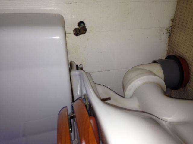

This is the overflow pipe on a toilet. I want to undo the pipe so I can remove the cistern.
"A" moves freely, no problem.
"B" and "C" seem to be stuck together. They do turn in relation to the metal pipe, and when they turn the plastic pipe turns with them.
I don't know which parts I should be turning and don't want to force anything.
What do I do?
Thanks!

Hold B so it can't move and loosen C.

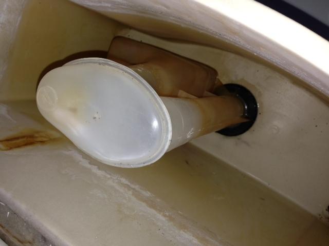

toilet needs a new syphon which can't be unscrewed from outside the cistern because the cistern butts up right against the pan.
am I doing the right thing to take the cistern off? I can't seem to release the syphon solely from inside.

As Picasso has said, most modern flush valves have "built in Overflow" so if the cistern is overflowing it would be visible in the Toilet Pan.
I would just tighten up the exsisting fittings and fit a new flush valve, Fluidmaster Flapper valve kit,

Is this a close coupled cistern that sits on the pan or a low level that sits about 9 inches above it conected by a pipe?
A photo of the syphon and the cistern would help us to advise.

If "C" is out of the way loosen the plastic nut "A" then you should be able to lift the pipe out of "C" then let it soak in plenty of WD 40 then you should be able to move "B" as suggested by footprints
That's exactly what I'm going to do - update the inner workings. I didn't realise there was no need for an overflow with the modern system.
pics below. The issue is I can't see how to get the old syphon out without taking the cistern off because I can't access the underside of the cistern
