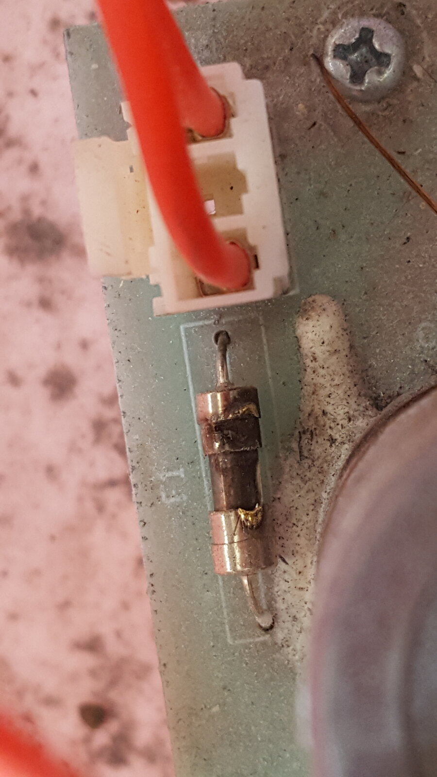

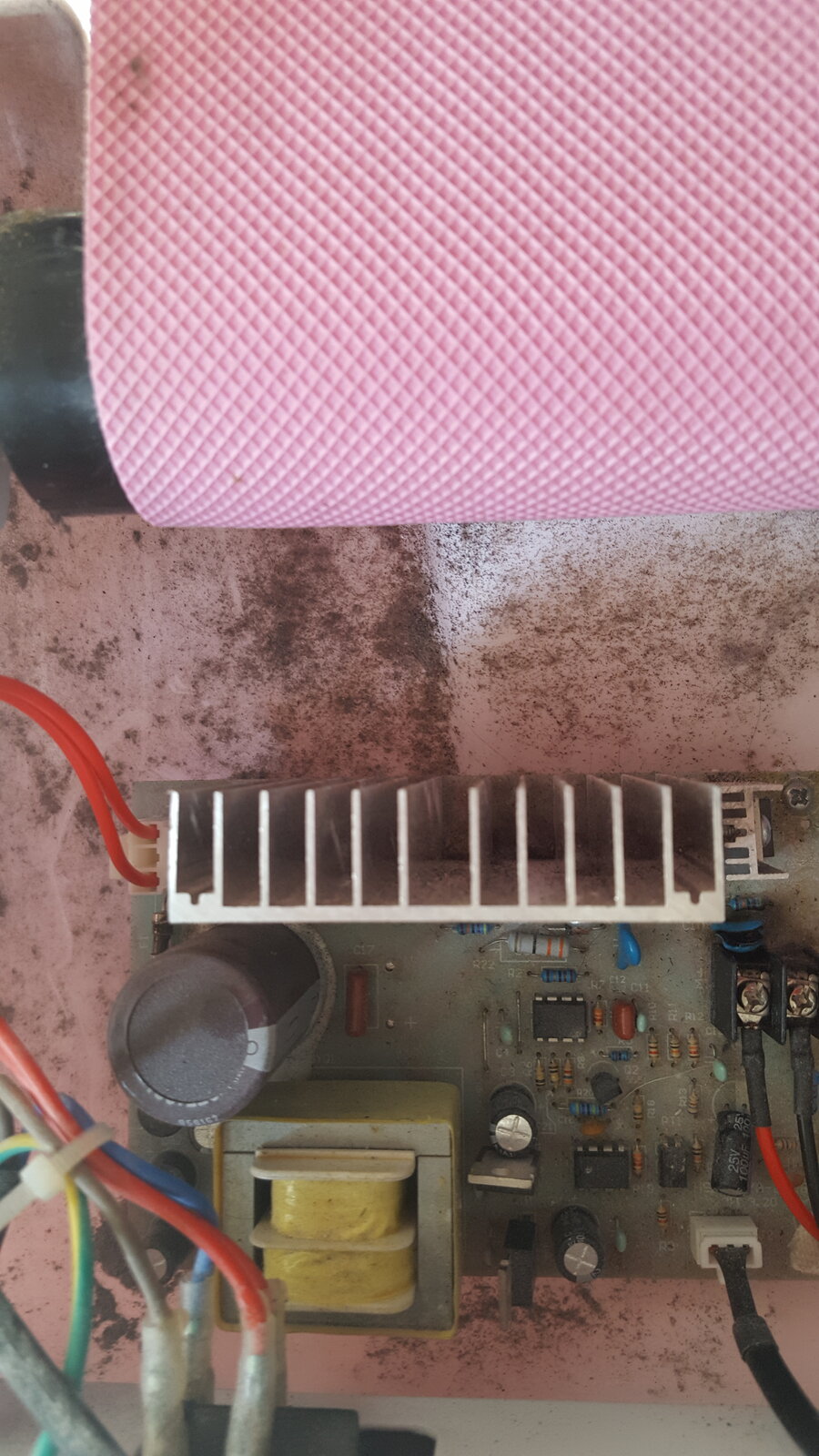

Wife went to use treadmill the other day and she said there was a bang and it tripped the fusebox. There is power getting to the on/off switch as it lights up but no power to the tracking unit and treadmill motor. Took off tge cover and it looks like a soldered fuse has blown. Is this an easy thing to fix assuming that is whats wrong with it. Pics beliw (excuse the dust)

It's easy enough to replace the fuse link if you have suitable soldering equipment. However, these components generally blow for a reason, so it's likely the replacement will just pop again. Some troubleshooting is therefore needed/recommended before replacement.

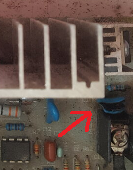

An image of the purple component, the one that appears to be leaking white liquid would help diagnosis.
It could be a failed electrolytic capacitor that has become a short circuit and needs replacing.
the white liquid might just be a sort of glue used to fix the purple part to the board to stop vibration damaging the connection

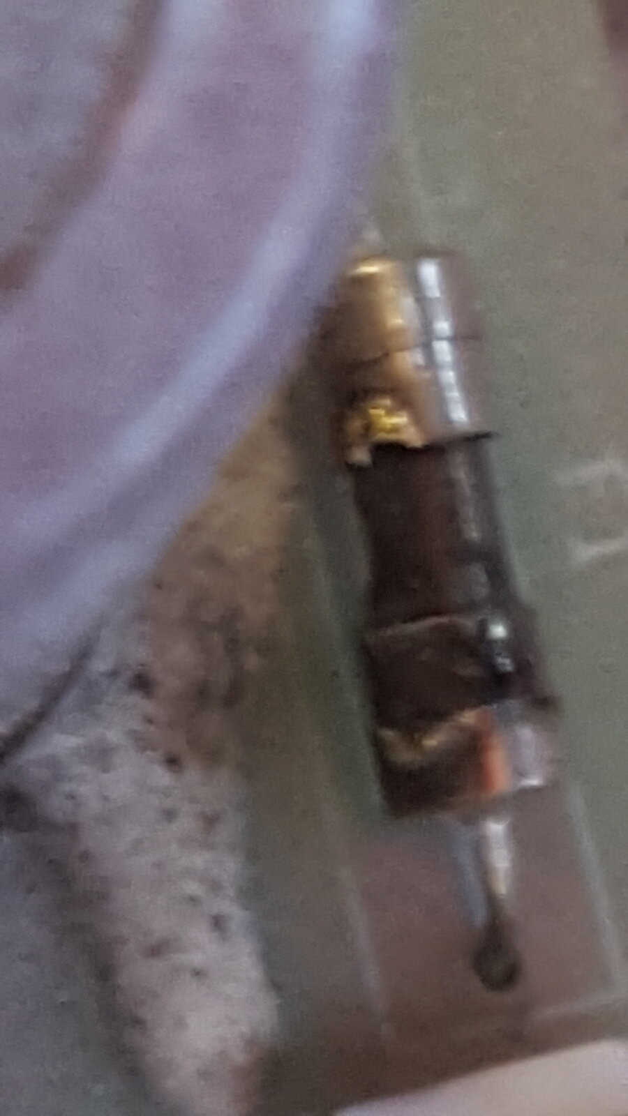

Forgot to upload this image and again excuse the dust. Don't have experience of soldering but willing to try, at this moment the treadmill is goosed (so can't make it worse) and thanks to COVID, prices are through the roof so wife is holding off just now. What type of fuse is it and can you tell the amp rating (assuming it's measured the same as normal fuse) and where can one get them.

Has this component split into half
If it has then it is very likely that several components have also failed.
hard to tell if the blue component has split or is just two capacitors close to each other
OP keeps asking for the fuse value. No way to tell from the picture but very likely is says somewhere on it. I would remove it, and get out a magnifying glass to see if there are any markings.
If the fuse has blown then that'll be the least of your problems. The blue things are voltage dependant resistors acting as transient suppressors.
You may well find the thyristor driving the motor has blown and if so that may be due to a motor fault. Been there got the tee-shirt and ended up buying a new treadmill. Even found parts of a scorpion inside the motor when I stripped it down !
Aplogies on delay in replying. Looks like a blue resistor has blown too.
Thats a capacitor it should have some writing on the side, with its value
I would concur. If that shorted it might easily explain the blown fuse on its own.
It looks more like a varistor, rather than a capacitor, used for over-voltage transient suppression. If you can read the number off it CPC Farnell will have a replacement. If you can't read the number get it from one of the other ones. The solder caps on the fuse should pull away from the fuse (careful you don't get the end-cap off the glass as well). That should reveal the fuse rating stamped on the fuse end-cap.

That fuse hasn't simply blown with age or a slight over load, it has been taken out by a substantial fault condition. It will be easy to replace, but it will simply blow again straight away - you need to find the cause of the fault and as above, that component bubbling liquid out the base (electrolytic capacitor), might well be the cause.
