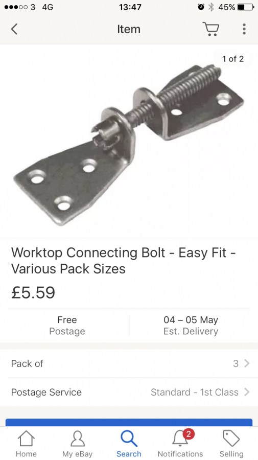

I need to join a breakfast bar to a worktop. They are square edge so I can pull the front trim off the worktop for a smooth join but I don't have the skills or tools to use the normal worktop bolts that go inside.
This is where I'm doing it:
Never seen one of those,
It may work for you but the traditional worktop connecting bolts have the advantage of pulling together from the centre and are recessed.
In the past have cut in them traditional bolts by using a 35mm hinge cutter then saw out the slots,then chisel out the grove.
Practice makes perfect.
The problem I see is because they're flush mounted and not sunk in they'll foul the top of your carcass
As you don't have a router and jig, I would consider them the next best thing, even though I haven't usd them, but yes, you need to be able to cut out the top of the carcase to accomodate them. Are you going for 2, or 3 though
I would probably use 3 on the 600mm join (which I had forgotten about) and 4 on the 900mm.
Practice would be nice but unfortunately if I balls these up my missus will kill me. I do have an off cut from the chimney breast bit, I might try and sink in a holesaw and then cut a groove with a circular saw. The worktops are 38mm thick so how deep would you go into them?
The carcas tops are 18mm so those easy ones will stick down a further 7mm into the unit.

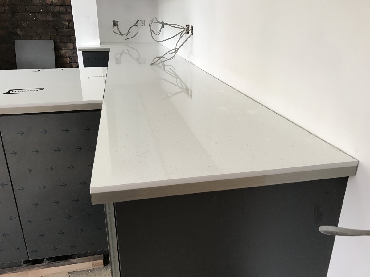

I've got my colourfill and a pack of 10 bolts, I've cut the trims off the front of the worktops so I'm good to go.
I just need to grow a pair before I cut out for the bolts :LOL::LOL:
You may as well crack on as your already halfway there cutting the trim off the front, can't turn back now can you

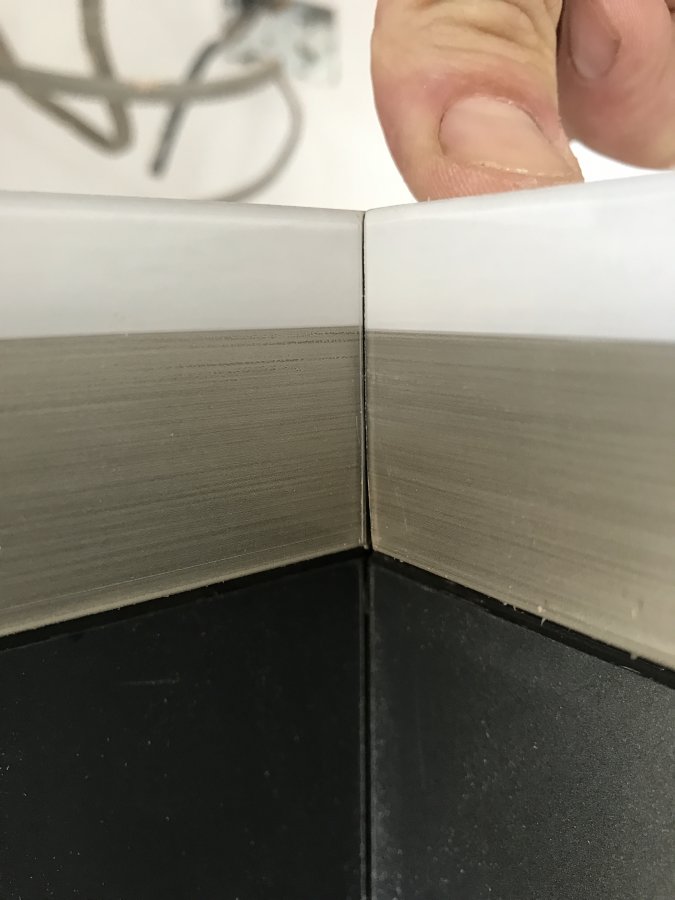

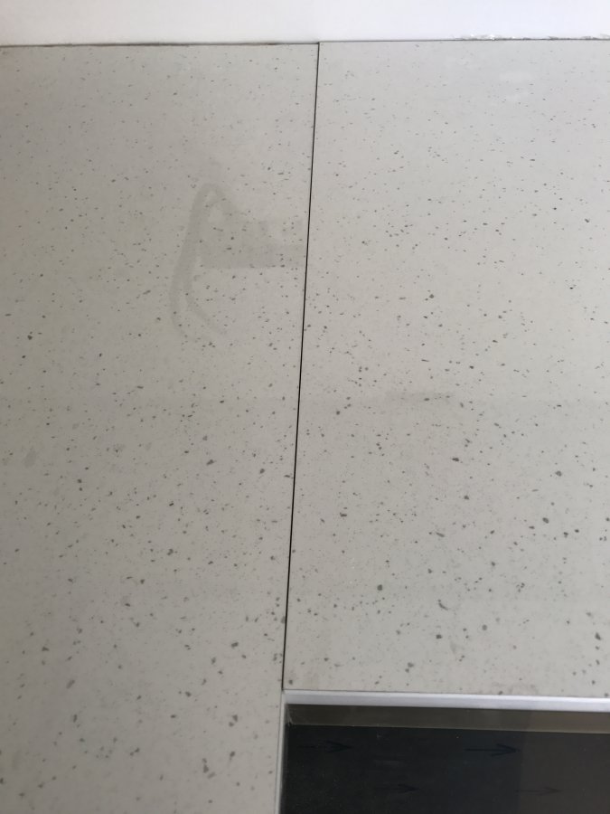

Now we didn't say anything about taking the trim off, did we. Pictures please Ian, I think you've opened up a new can of worms.
Well you haven't got as close a joint as using a router, but you've done pretty well, and hopefully the colourfill will fil the gap.
