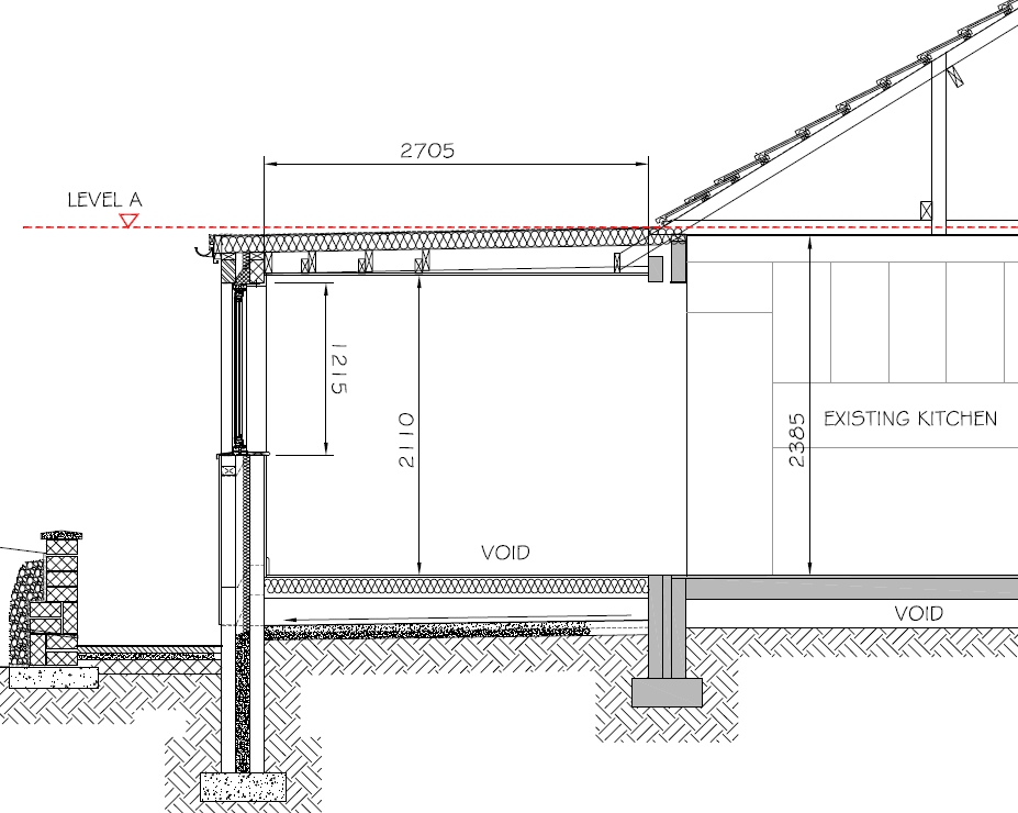

The Council say that the upper part of the new flat(ish) roof is above the eaves of the existing house and the build therefore requires planning permission. Our architects claim the part that matters for the measurement is the point where the new roof and new wall specifically meet, and they have built in a notch as a work around to this. The Council say the notch isn't relevant, that it is the upper roof measurement (as if it was continuing to the outer wall) that is key. Confusing! I've uploaded a drawing that may help.

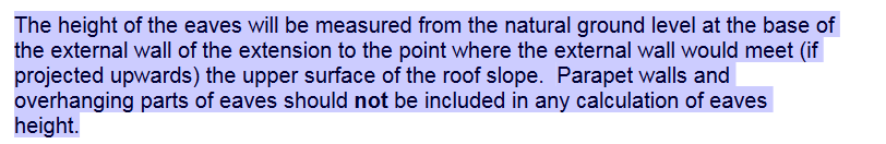

The architects quote the Technical Guidance as a back up to this, but I'd say it confirms that they are wrong:
For the purpose of measuring height, the eaves of a house are the point where the lowest point of a roof slope, or a flat roof, meets the outside wall.
The height of the eaves will be measured from the natural ground level at the base of the external wall of the extension to the point where the external wall would meet (if projected upwards) the upper surface of the roof slope. Parapet walls and overhanging parts of eaves should not be included in any calculation of eaves height.

I suspect that an LDC would not have been forthcoming in this instance. And I think it would ne difficult to establish negligence; the architect clearly appears to have been aware of the rules and thinks that their interpretation is the correct one.
In hindsight what clearly should have happened was the architect should have advised us we get an LDC at the outset before any building work was done. They insist they are right, the council is wrong, and that our best bet is to leave it for four years when any right to enforcement lapses, and that the since the Council have decided to close the case they are unlikely to open it again. If they do the architect will reply with the same argument. In my view this isn't an acceptable resolution and they are bordering on negligible for getting us into this mess.
If they believe they are correct in their interpretation of the rules then there is no need to advise a client to apply for an LDC, that's the whole point in Permitted Development, the right to build without having to apply for anything.
edit just seen there is an image .......

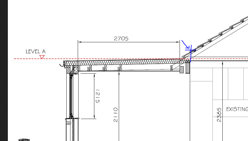

OK just looked at your image, I agree that it is not PD, am doing a very similar job at the moment and have just sent off a sketch to the client to explain why his ceiling will be so low if he wants to avoid having to get planning permission.

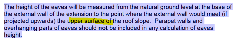

This is very relevant to the issue we recently had with a rear single storey flat roof extension (check my thread i started on it). We are also under Brighton council and they refused our application under neighbour consultation scheme because the flat roof was too high and hence above the eaves (we have a bungalow). Their interpretation of the eaves of a flat roof is correct per the guidelines and therefore your extension is in breach. They are at least being consistent with what they told us.
What's interesting though is that if your 'lower roof' had been at the end that connected to the house, as a sort of gully, then this would have been fine. This 'connecting' gully was an idea we looked at doing as they were satisfied that this would be the eaves of the extension since anything above this that was not directly in contact with the original house and hence did not form part of the eaves (even as a flat roof) - made no sense to me at all. The whole experience we had with Brighton Council was one of sheer incompetence, inconsistency and timewasting.
One point re Freddymercurystwin - your client's flat roof could be raised some more since it is the point where the outer wall crosses the UPPER SURFACE of the roof surface (ie the faceof the tile). That was confirmed to me by Brighton council and follows the guidance.
