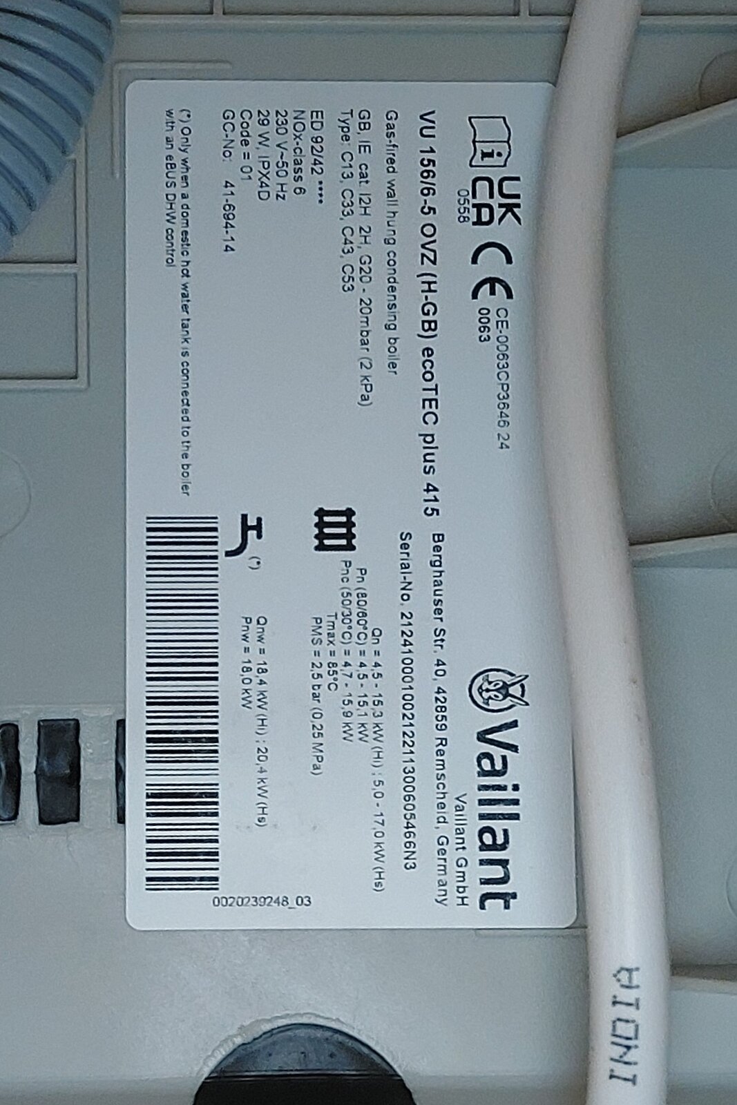

I recently have had a new vaillant boiler ecotec plus 415 installed. It's a conventional system with single zone heating and a hot water storage tank. This is the first boiler I've owned with modulation capability. At the moment the room thermostat is a simple on or off type. The boiler does do some form of modulation using flow and return water temperature. I am wondering if it would make sense to install a VRT50/2 ebus thermostat? If I do install that, would that automatically override the flow and return modulation? I'm fairly handy but the last boiler I had was 30 yrs old so I did get my money's worth out of it but I'm now way behind in tech knowledge on modern boilers!

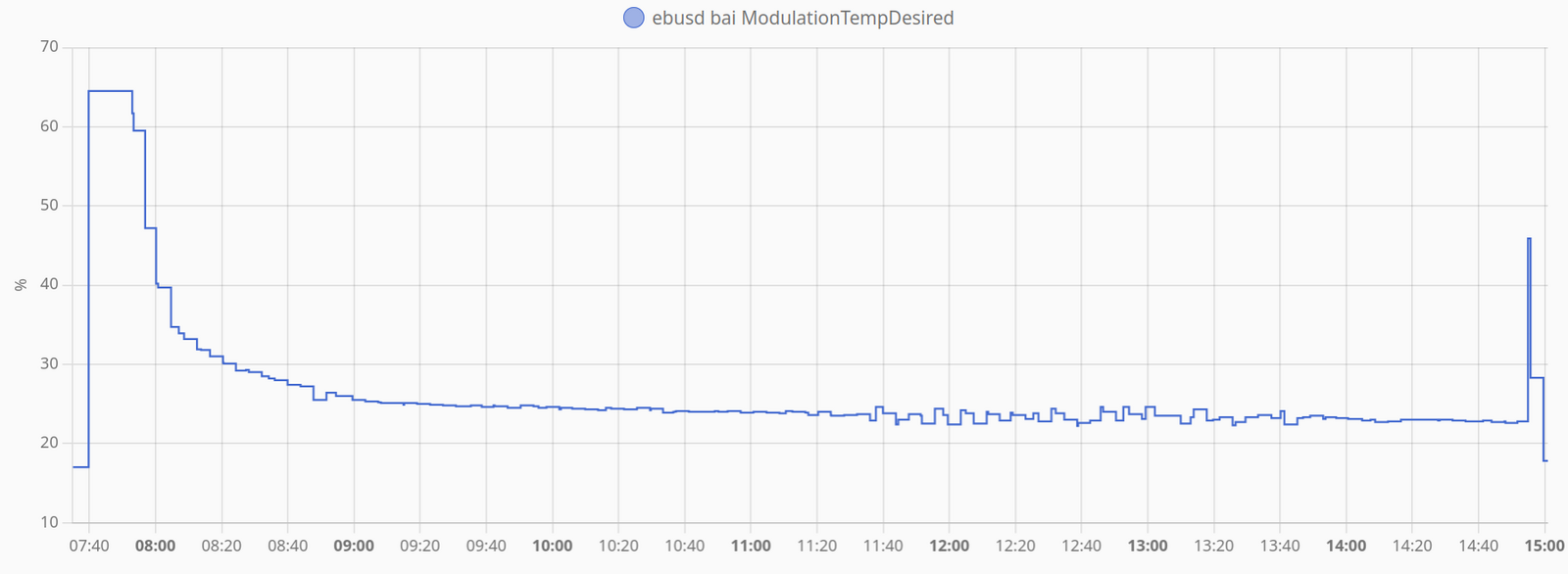

The boiler will modulate without some fancy external controls, but it will perhaps start out higher than strictly necessary. I am not sure how noticeable it would be if my boiler had just stayed around 25% modulation all day:

It depends. Mine didn't. It was firing for the whole 7h in that time window. But I am cheating by having the flow temperature set low enough that the thermostat is never satisfied.
OK, that will work, but only providing you manually set and adjust the flow temperature.
