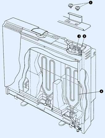

I recently moved into a bungalow that has 3 storage heaters, one in the lounge, hall and Kitchen.
At midnight all 3 lights on the sockets light up (picture in album) but only 2 of the heaters heat up.
The one in the Kitchen does not heat up, it worked the first night I was here.
I have checked the consumer unit and nothing has tripped out.
Is there anything I can check?

It is a Dimplex XMS724N
There is also another number, not sure if it is relevant. 000649
I seem to remember that the reset button is in the top right hand corner of the heater. The drawing below isn't clear, but somewhere near position 2. The top cover will have to be removed to get to it. You will see a small button which if it has tripped, will click when pressed.
Really? The tiny red unit will rock up and down but will not slide or pull off, it is attached to the white block.
Looking at the top view I can see what looks like a contact, I am fairly sure I have reset one before by pushing it down
Are you talking about looking from the top view of the red unit?
If so do you mean to the right of the screw on the red unit?
Well I pushed it, poked it, prodded it to no avail.
The misses wants the cover back on now as it's been off a day and half.
Thanks anyway.
I may get an Electrician out when I get some funds.
