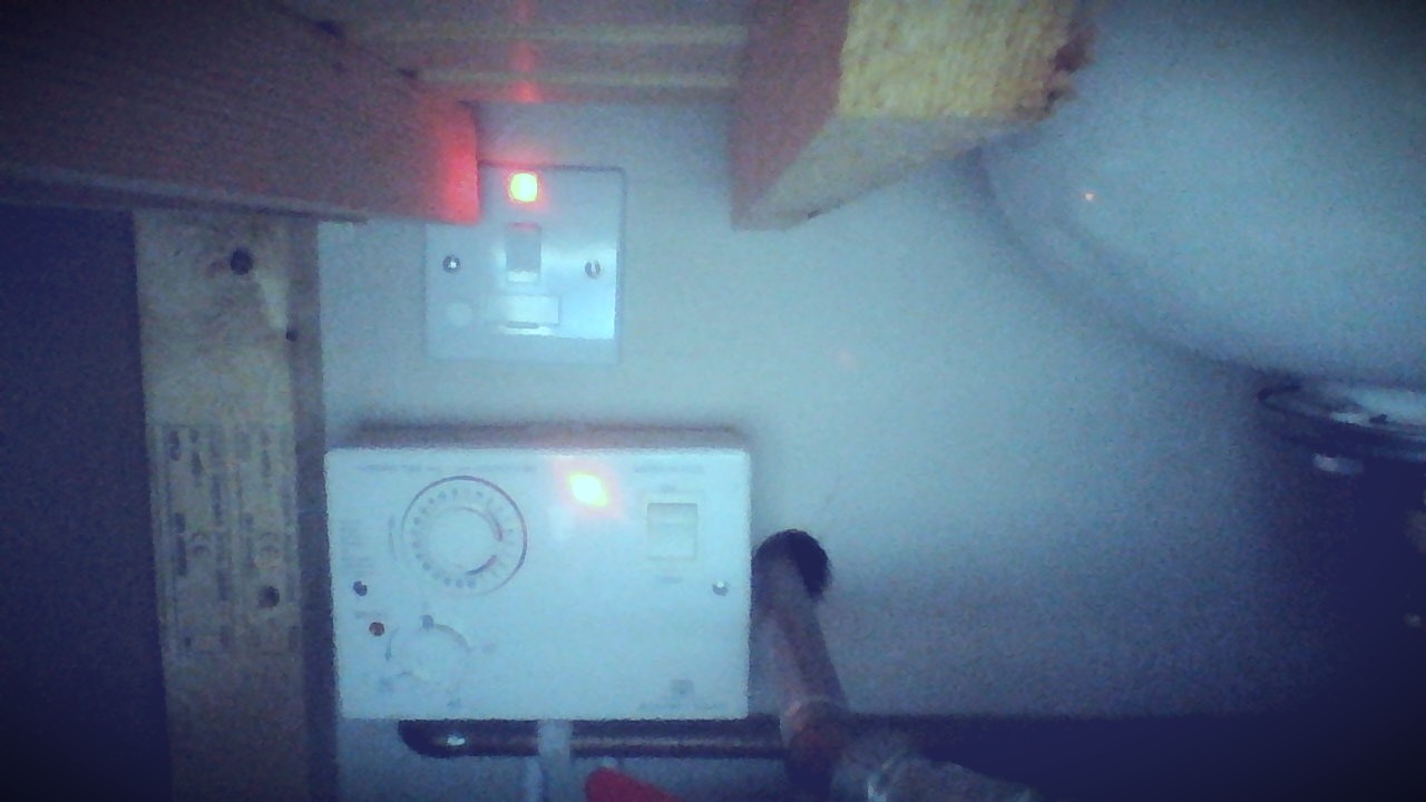

This is the best picture i can get.. sorry its not great. that red light seems to stay on clock is ticking but never any water... lived here since febuary this year last worked about 4 days ago. the hot water seemed to only last aout 7/8 minits at a time though before cuttin out and going cold.
I can't read it. Is the brand name "Horstmann" on that timer?

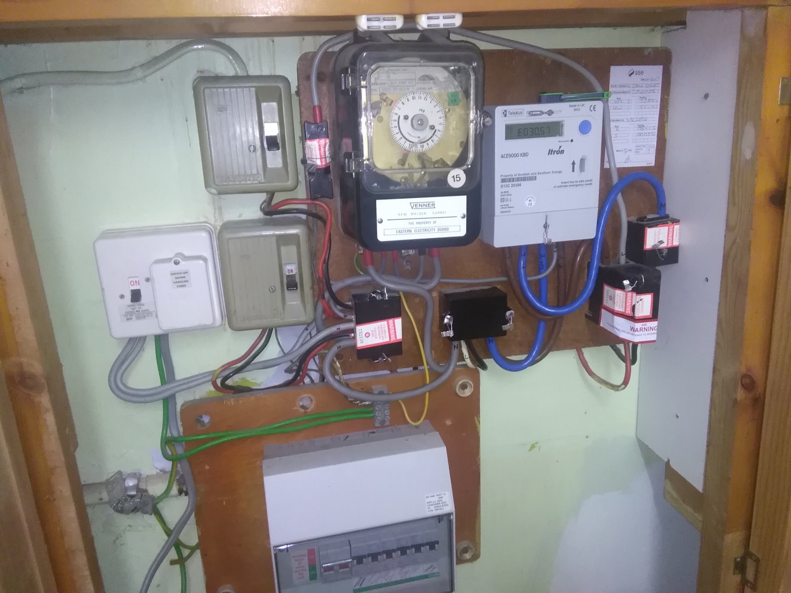

If you have an off-peak economy tariff, there will be a timer in or beside your electricity meter that turns it on during the night. Please post a photo of the meter and anything near it.

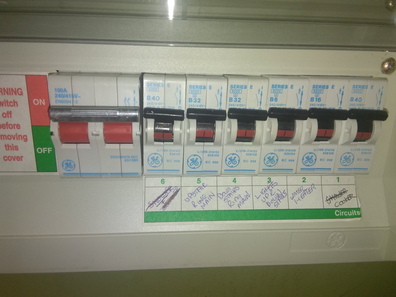

Your electrical consumer unit ("fusebox") will probably have two breakers marked "hot water" or "immersion." Please open the flap to show all the switches and breakers and their labels, and post a photo.

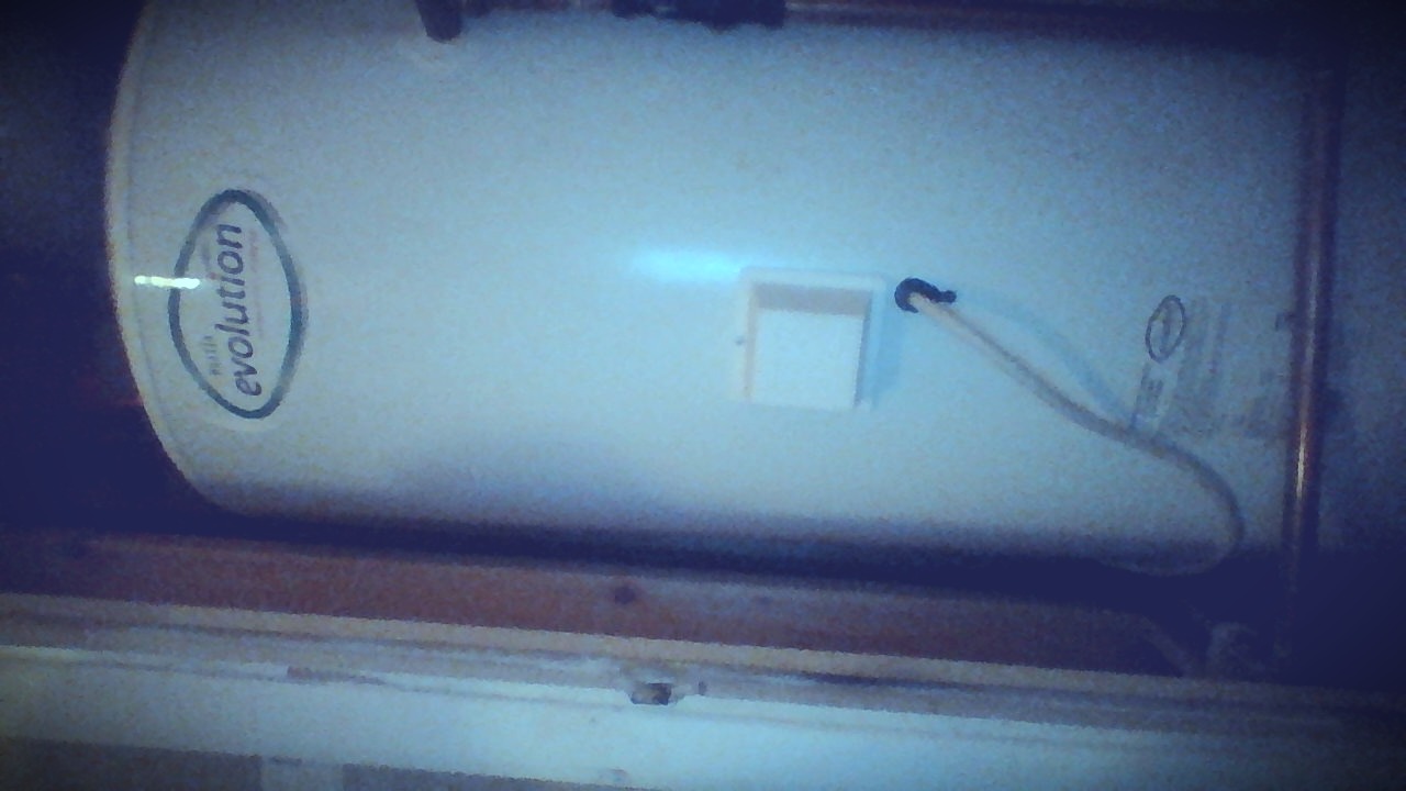

I expect you have a hot-water cylinder. What colour is it? Please stand back and take a photo showing the whole cylinder and especially any electrical cables going into the top or sides.

I think I can see a white pressure vessel in the corner of your photo. Depending on the colour (which indicates the type) of your cylinder, you might need a specially qualified plumber, or it might be an everyday job for a plumber or, depending what we discover, a qualified electrician.
Yes thats the one i have. and yes electric boiler... sorry its added so many pics here cant seem to delete some of them!! i presume this is what you wanted to see?

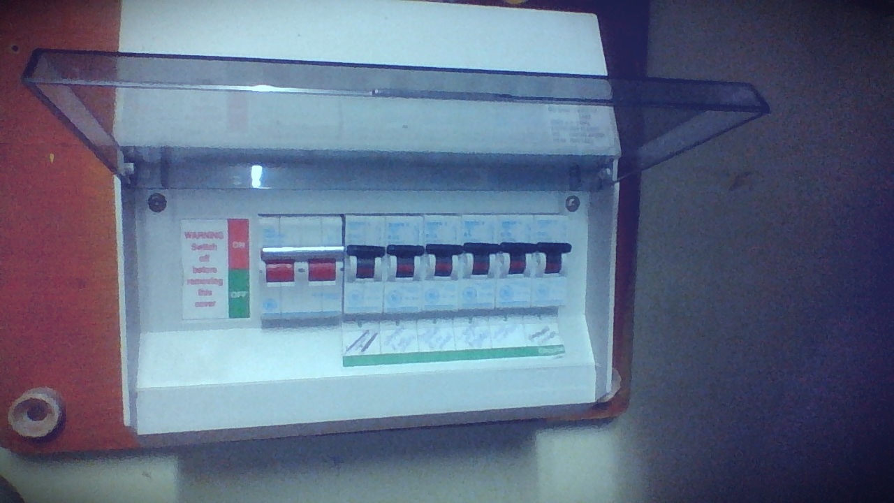

That's the (one) consumer unit; not the meter(s).
If you took the picture of the timer between when asked at 6.01pm and posting at 6.19pm then your clock seems to be set to around 11am - 7 hours slow, therefore, if you have Economy 7, the water will not heat when the power is on at night.
Set the clock to the correct time and see if you have hot water in the morning.

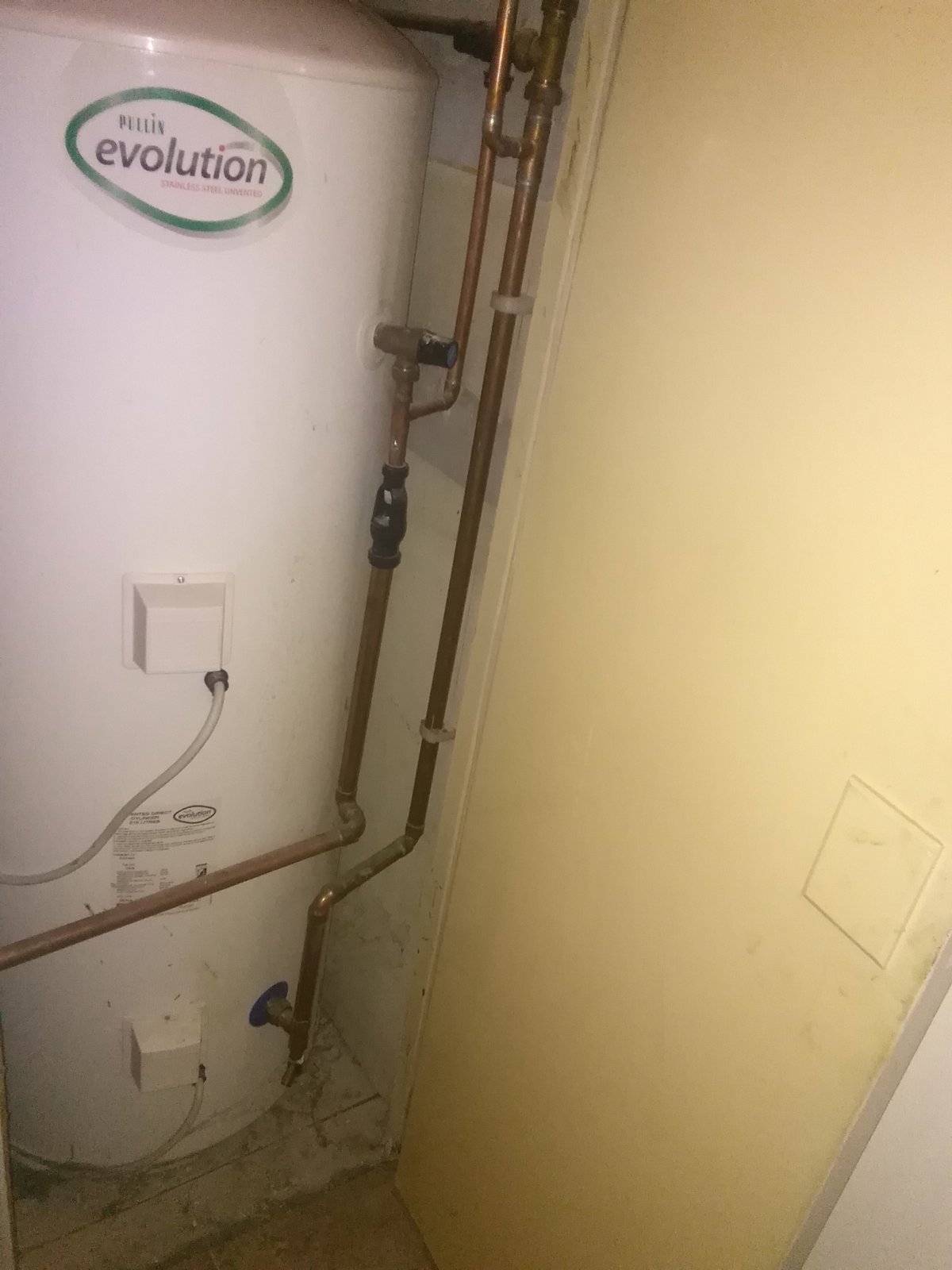

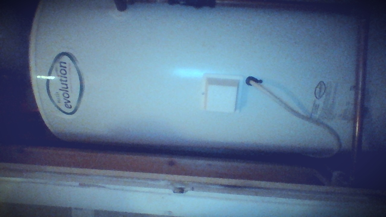

I can only see one thick flex going into the cylinder, so perhaps it just has one immersion heater. Is there another? Stand back further and photograph it again.
Please also photograph the electricity meter and anything around it.
In the consumer unit, what do the labels say? Pics may come out better if you can turn on Flash.
It appears you have a Pullin Evolution unvented cylinder, so if you have any work done to it, you must get a plumber with an extra qualification - tell him and ask him to confirm before making an appointment.
One of your neighbours may recommend a local person.
These cylinders are pressurised and have various safety devices.
http://www.evolutioncylinders.co.uk/
There will be a model number on a label, such as 150D
House. sI needing some work!!! Hope these pics help abit more. Its a tiny bathroom. No more room to stand back!!
Ah, I see a lower immersion heater now.
And there is a timeclock by the meter.
You may be able to see the start and stop times of your off-peak timer. You should align your Horstmann to the same period.
