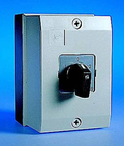

I am possibly fitting economy 7 to a flat and will also be connecting the immersion to this.
However, it would be benificial to be able to switch this on during the day to boost the hot water if necessary.
Are there switches on the market? DPDT? in order to do this? Or is it infact not allowed? Suppose it could bridge the two circuits?
Just wondered whether anyone here has done this.

If you must, there are E7 controllers with boost facility on market:
Horstmann Electronic 7 & E7 Quartz
See tlc-direct.co.uk and look for part numbers HO ELEC 7 and HO E7Q

Cheers, securespark, only trouble with using something like that is that little old ladies have trouble understanding such technologies :rolleyes:
Could a two way switch work??? Com to +immersion L1 to E7 Live and L2 to daytime Live...
The negative circuit would be shared though...

No no no, and a thousand times no.
You are describing a light switch, which will not be able to switch the load that storage and immersion heaters represent.
It's not negative, it's neutral. Without wishing to prompt the "I came here for help and advice and all I got was discouragement and abuse" complaint, how much do you know about electricity, and electrical installations?
But in any event, you must not share the neutral as you describe - this is a Very Bad ThingTM.
Can't see that I am the first to do this.
Grateful for any feedback
You can get 2/3 pole changeover switches rated at 32 or 63A, similar to this:
I would suggest having an electrician wire it up for you. Or check with your electricity supplier to see if there are alternative peak/off-peak schemes that you could go onto that would avoid the need for a switch.
Or just fit a second immersion heater with the thermostat set lower than the off-peak one.

As for the switch, yes light switch, and no I wouldn't use a standard 5 amp - 2Kw/230=8.7amps. Not sure if these were available tho?...

The changeover switch is perfect for my needs, thank you, simple and cost effective.
