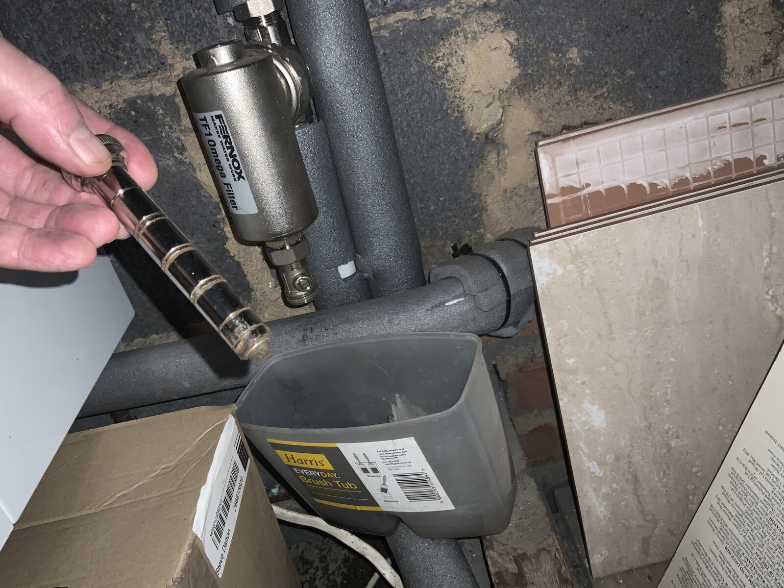

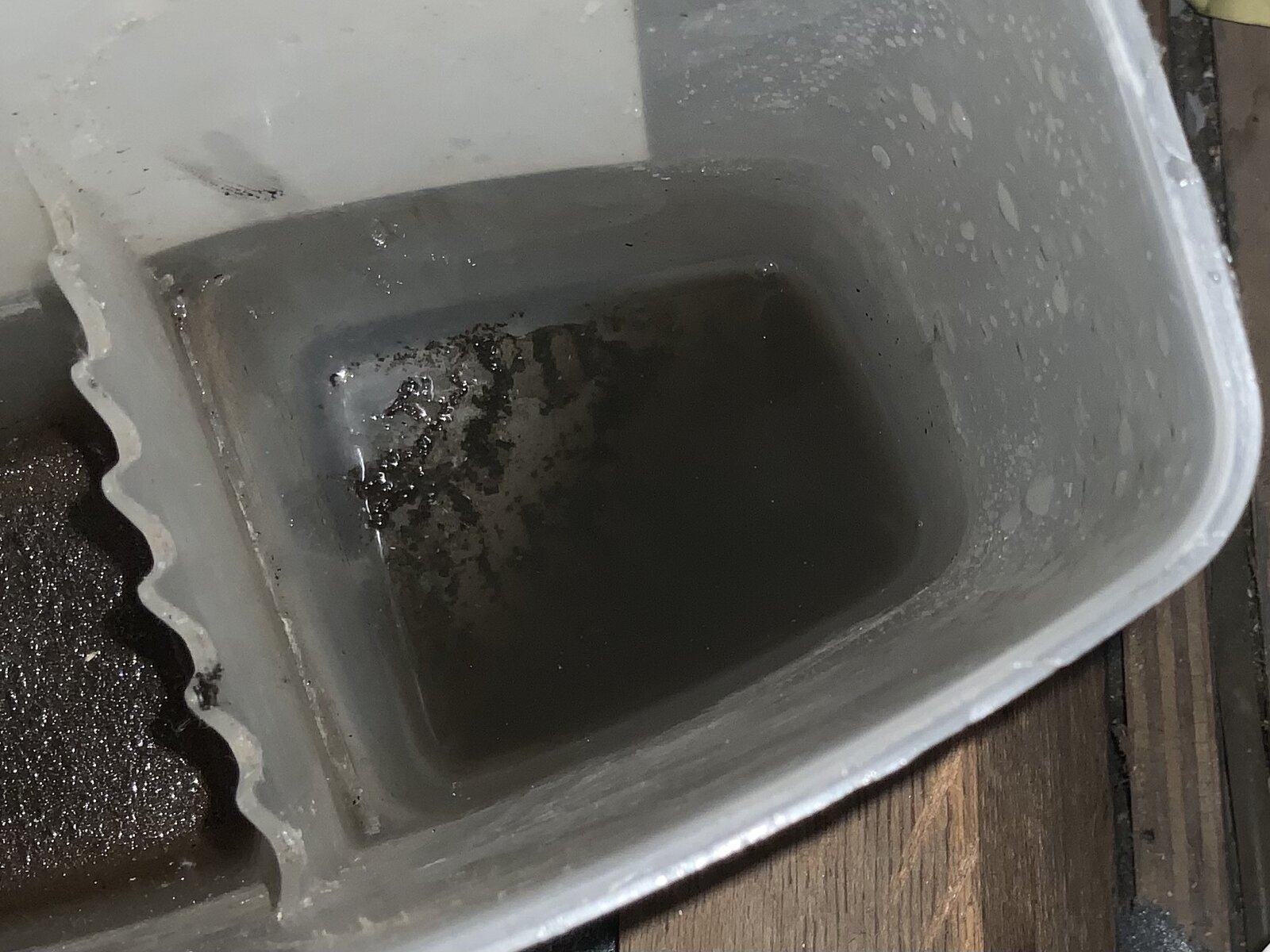

You don’t need valves to clean the one I have - Fernox TF1 Omega. I just switch everything off, remove the magnet from the top of the filter, wait a few seconds while any metallics sink to the bottom of the bowl then open the drain valve at the bottom of the filter and all the shyte is blown out (sealed system). I would imagine it would still flow out of it was a conventional vented system.
Edit: Reading this has prompted me to clean out my filter.

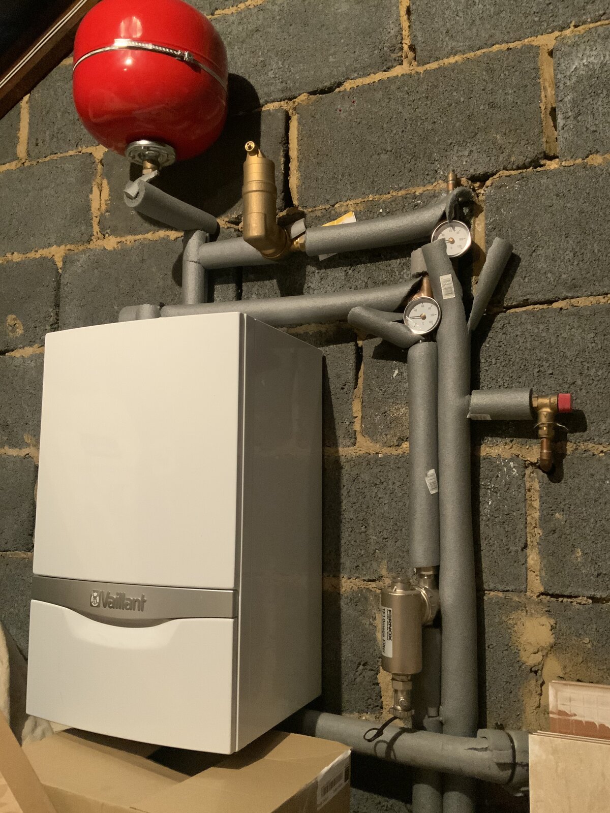

Here's my filter:
Magnet removed:
This is what came out before water started running clear - about a cupful of fluid:

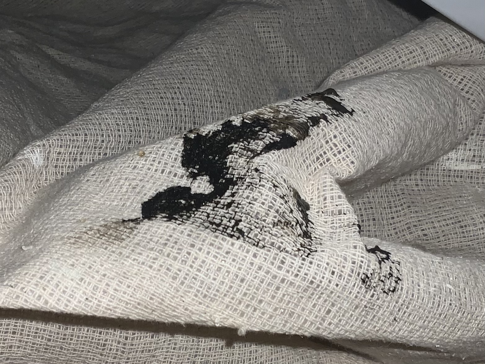

After I’d swirled the magnet around in the drained fluid, I wiped it on a cloth:
And that’s it - about 6 months worth of magneticy stuff from my system.
