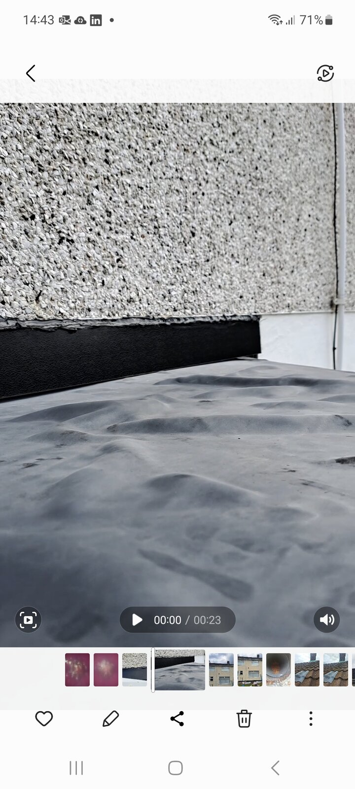

A roofer has just done my small bay window.He used solvent based adhesive and I do not think let it tack off.
The edpm has bubbled pretty bad
Will this settle by itself or stay like this ?
No that will not settle. He should have used water based adhesive for the main field and contact for the perimeters.
