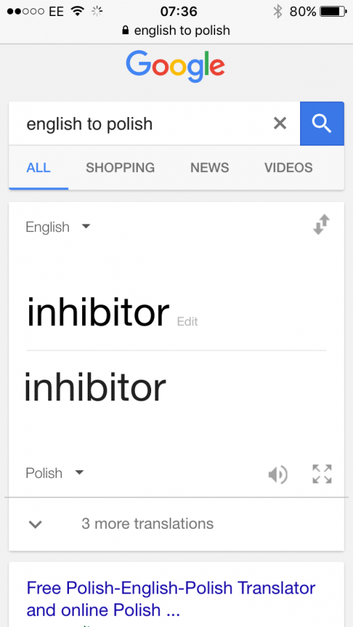

I also asked him if I'd need to pay extra for inhibitor to be added when the loop was refilled, and he didn't know what I meant by inhibitor (not a native speaker) but assured me only water was needed. Is that normal?

You the plumbers needs to polish his English?
Perhaps inhibit giving wrong advice:LOL:
