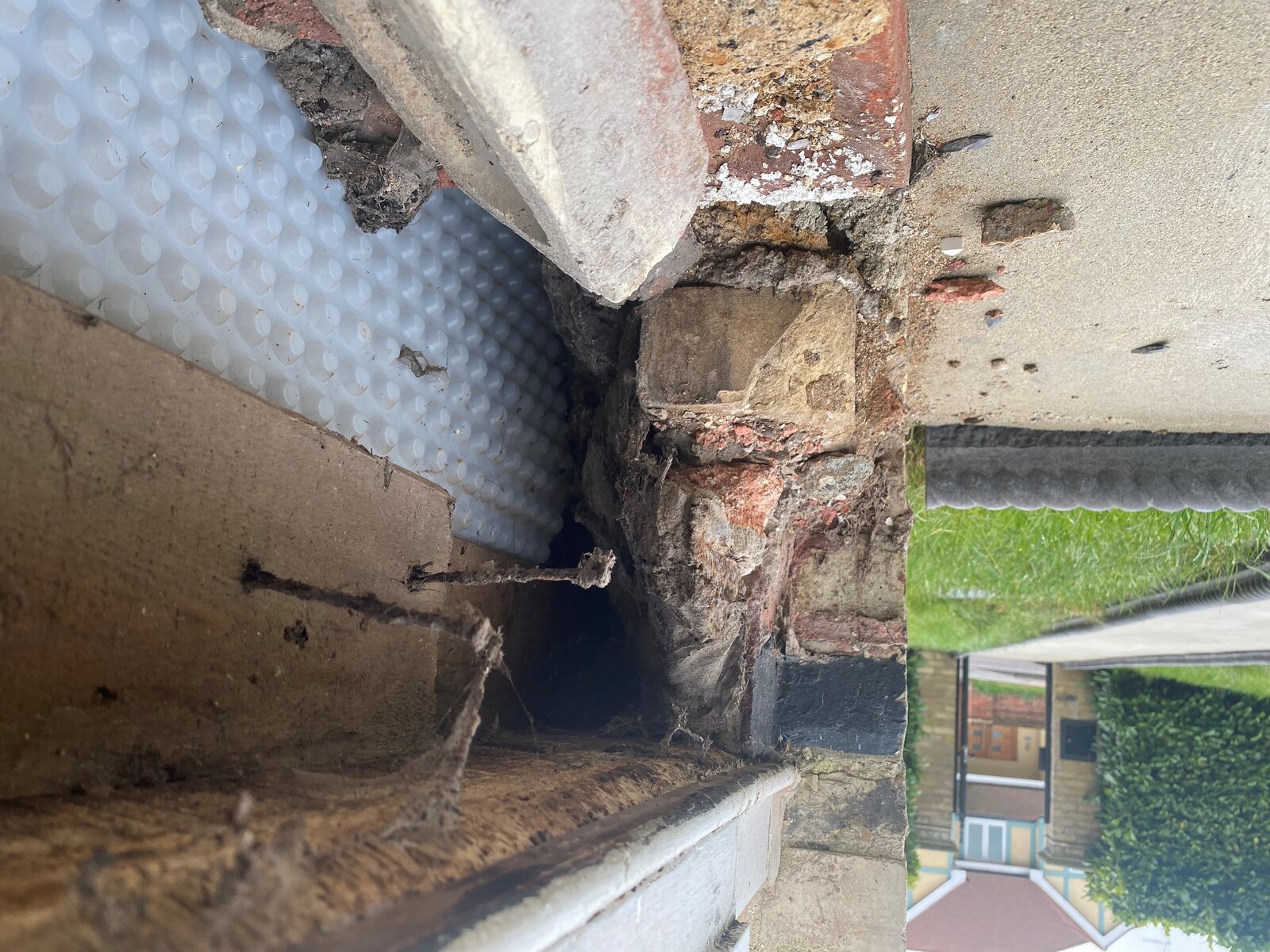

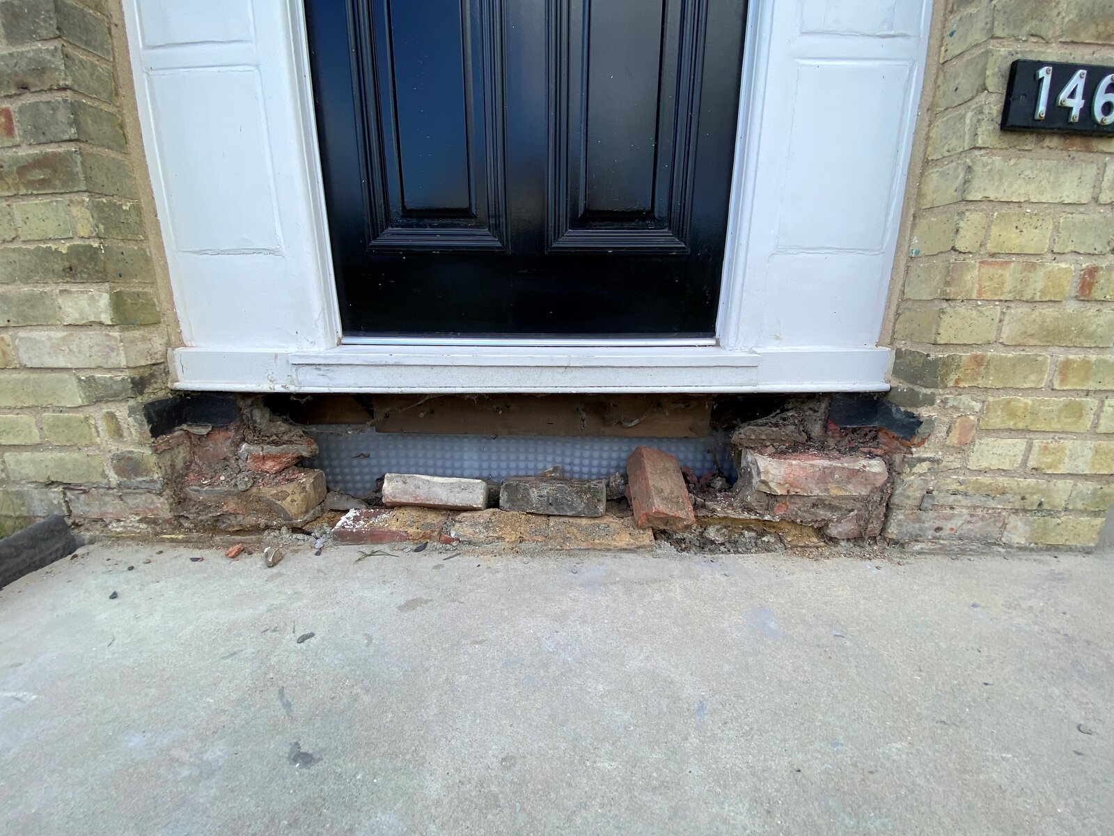

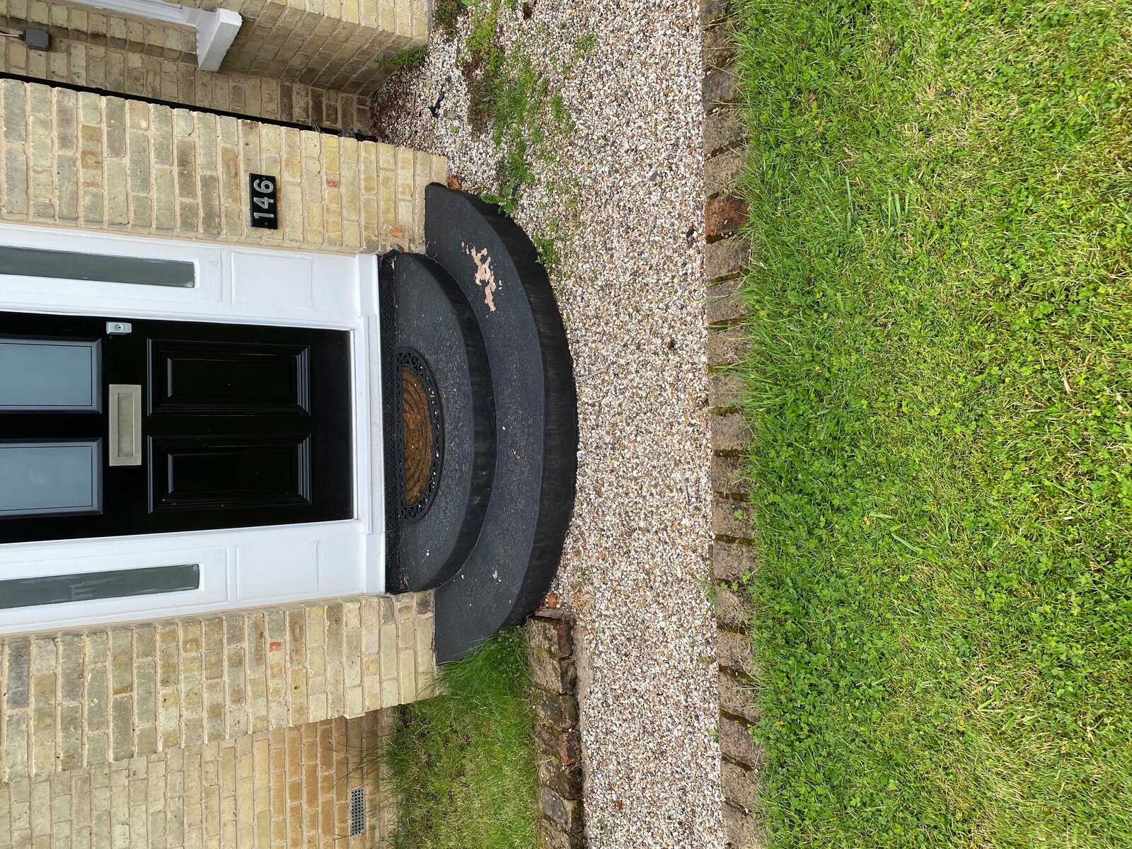

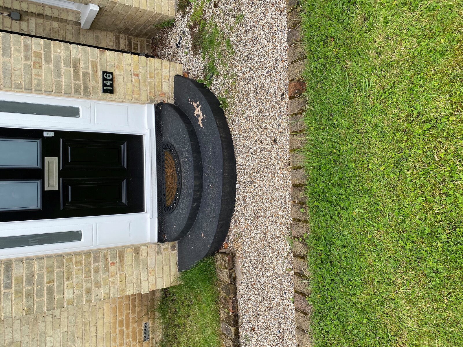

Hi, we have an Edwardian house built in 1905. We have a cellar directly under the hallway. We are currently replacing the front steps and path and now that the steps have been pulled way there appears to be very little support below the front door. When the steps were there, there was just a metal grille providing ventilation. Can anyone recommend if the hallway and door are supported in a way that can’t be seen from front on and whether we should brick the space up to provide extra support before putting the steps in?
I have put in a before and after shot.
Thanks in advance
Pete

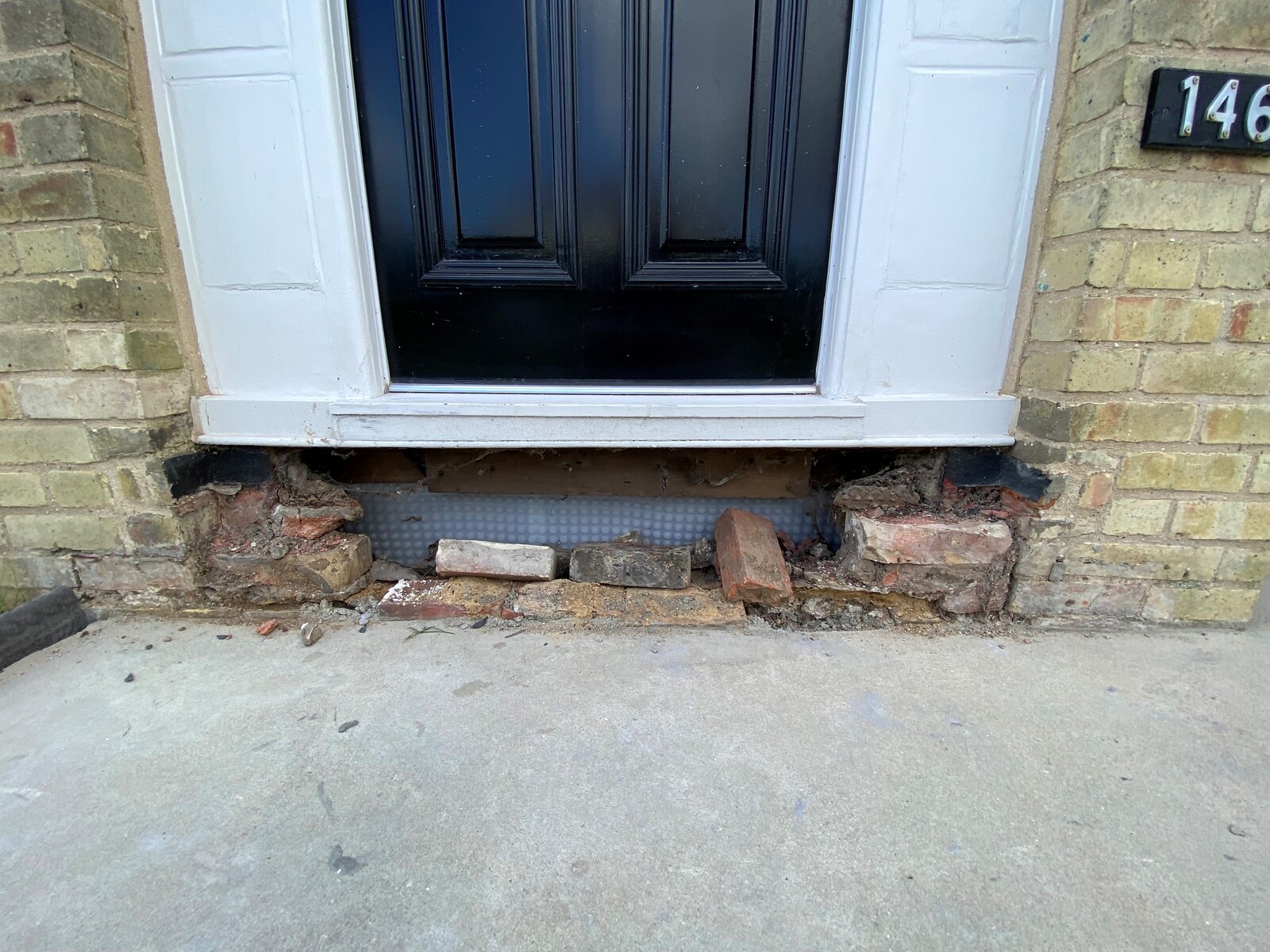

You can see where the brick “piers” at either side of - i.e. underneath - the door, have been chopped out. The damp proof strip has been left in mid air. I imagine reinstating that would resolve it.
Blup
Thanks Blup- do you mean just brick up under the door ledge the whole way across? thanks Pete

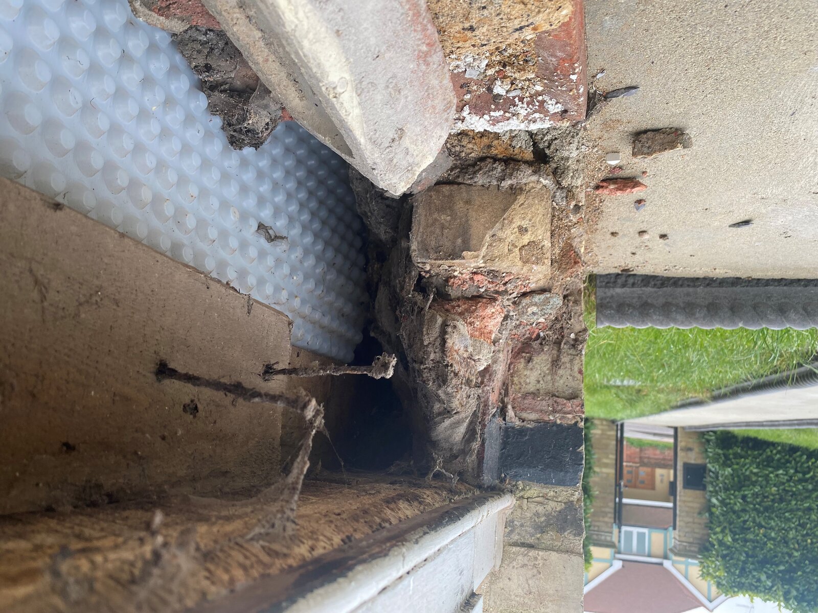

Thanks for the quick replies Opps.
The unpainted timber below the door frame, sits back from the doorway. I have attached a picture to try and show this, so the door frame does not sit atop anything directly below it, apart from a brick at either end.
Unfortunately the hallway is tiled so i cannot see any nails.
I don't detect any bounce at all on the threshold and i think it has been this way for years, at least 3 since we moved in.
Pete
I have just taken a further look. It seems as though the doorframe is fixed to a lump of wood that is itself fixed to the flooring joists. You can see the lump of wood in the first pictures i attached. So the door frame is connected to that and then that is connected to the floor joist that is set back a little further. The door frame also has some support at either end from the bricks it rests upon.

I would leave space for ventilation of the cellar if there was ventilation there before
Blup
If you can get 2 rows of bricks under the threshold you could fit them but make sure one on the lower course is an air brick to allow air to flow past the joist.
