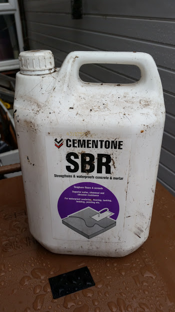

I've got a mostly full tub of Cemoentone SBR left from another job -can i use this stuff? (pic attached) Also do i literally just paint the stuff on as it is? Do i need to PVA the wall aswell?

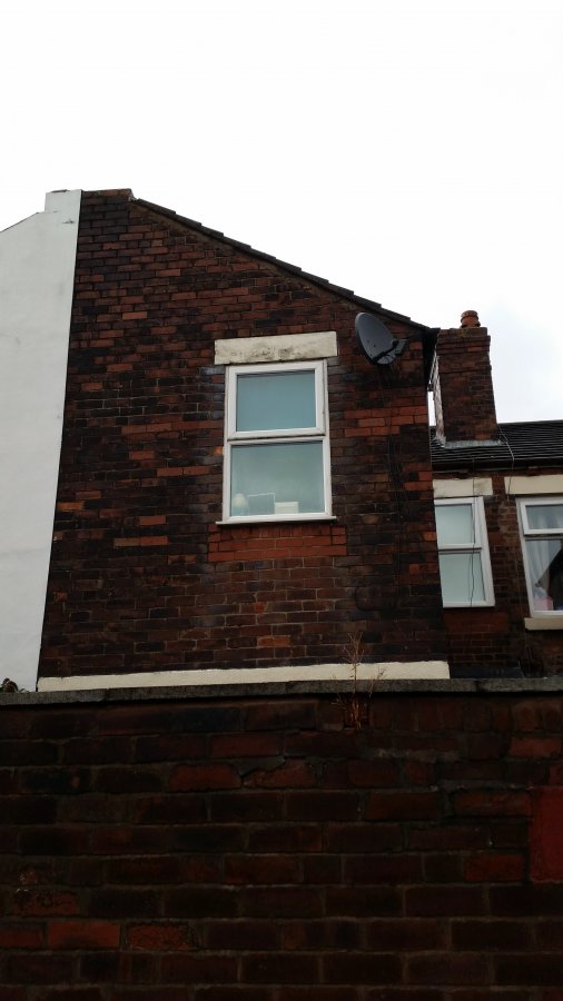

I've attached a picture of the external wall; I cant get into the loft at the minute to take a picture (ladders at my parents and the loft hatch is above the stair well, so i'm looking at a 20 foot drop if i try climb it!) The roofers didn't provide any pictures or videos - i'll bare this in mind in future, never thought of asking for it before!

Thanks for the photos.
You would be as well to, in agreement with your neighbour, remove that stub of a shared stack, & any remaining c/breast below. Roof over the ridge space remaining.
Its fairly common now for roofers to supply a before and after video.
The gable looks as though it could do with a complete pointing.
The Cementone is fine. Dont use any PVA.
Use NH Lime from any builder's supplies. The render is exactly like, and as workable, as sand and cement. Dont confuse it with lime putty.
