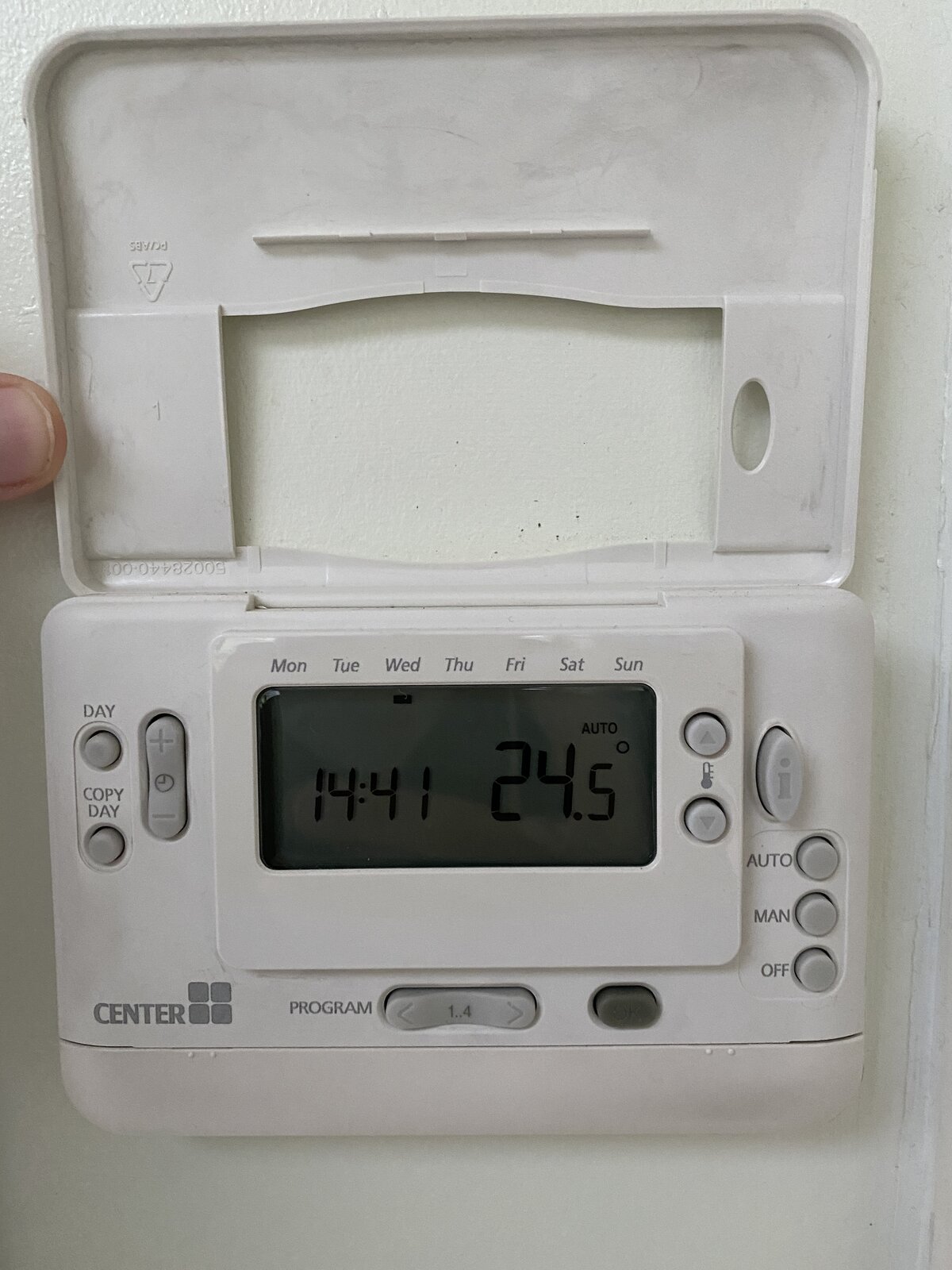

I have 2 x EHE0200361 thermostats. One for the central heating and one for the underfloor heating. See image.
My builders installed them years ago before I physically moved into the house.
From my research, I understand that this thermostat comes with a relay for wireless control.
Yet, I have never seen the relay box anywhere.
I've searched around the boiler but nothing at all.
Could this thermostat work without a relay? Does that mean it's wired up directly to the boiler without a relay?

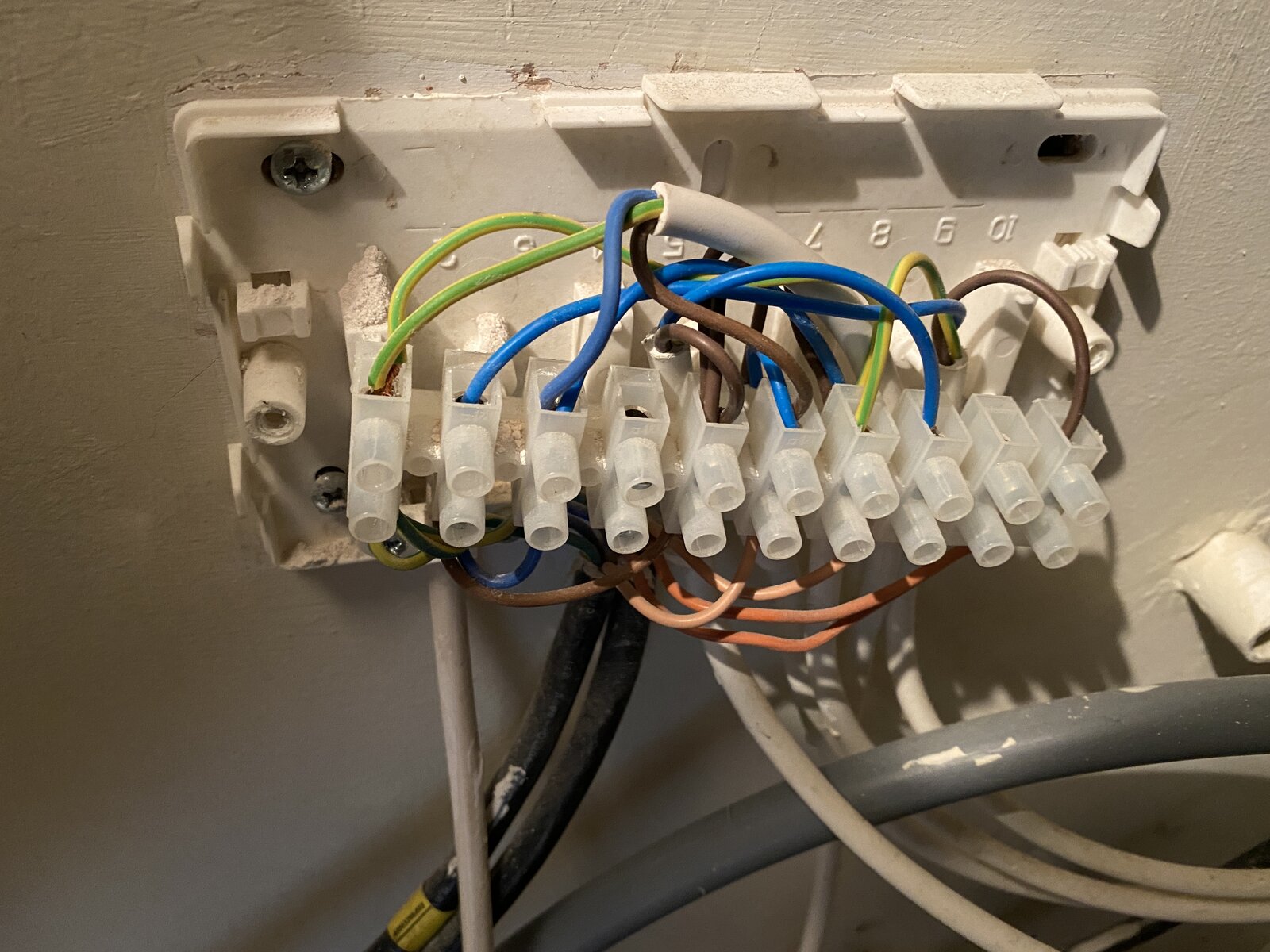

Yes, I found the box you mentioned. See the image.
So my thermostat on the wall connects to this.
Now I have a new thermostat with a relay. The thermostat itself is wireless but I need to connect the relay to the wires.
Do I simply take off the old thermostat from the wall and use the same wires for the new relay, or, do I need to hook up the relay to this junction box that you mentioned.
No it doesnt connect to anything, it sends an RF signal to the ceiver , the receiver gets wired in there

It is not a relay, it is a wireless receiver, if you have two wirelesss thermostats you need two wireless receivers
Right, but where do I wire them?
Do I wire them where my existing thermostats are or do I wire them to the junction box in the image?

you wire them in to the junction box, and you install them next to the junction box
Does that mean I tear out the thermostat from the wall and also tear out the wire that goes between the junction box and the thermostat?

Sorry over to someone else , you will not listen, there are NO wires in your thermostats, the thermostat is simply removed from the wall, the existing receivers are replaced by the two new ones, they will use the existing wires that are in the old receivers

I have two thermostats which are connected directly to the boiler without a wireless receiver. The wireless receiver doesn't exist because the builders didn't install it. That's why the thermostats are connected directly to the junction box (located underneath the boiler).
So now, I want to install a new thermostat WITH a wireless receiver (also called RELAY by Lightwave).
1. Do I remove the existing thermostat from the wall and expose the wiring (coming from the junction box) and wire the relay right there on the wall?
2. Do I connect the relay to the junction box? If so, what do I do with the existing thermostat that's on the wall and the wiring which goes from the junction box to that thermostat?

Well perhaps you have a battery operated wired thermostat and not wireless. A wireless one doesn’t work without a receiver as Ian pointed out, unless you have an intergas (which you don’t) where it’s built into the boiler. https://www.wolseley.co.uk/wcsstore...lang.all/ti/on/Center_340010_Installation.pdf
So if you’re replacing a wired one, for wireless, it’s best you remove the wires at the thermostat end and wiring center end, and all new wiring located to wiring center. If it is indeed wireless, then you should be able to swap the wiring over from existing receiver to new one. Replacing the thermostat on the wall, or just have it as a stand-alone item.
