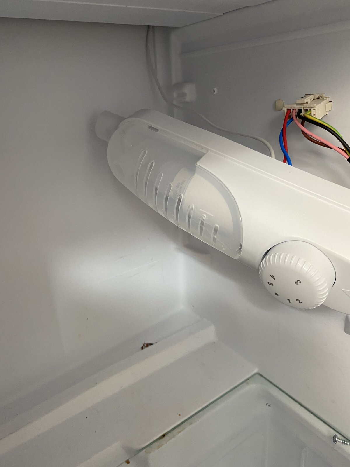

Hello All, has anybody got any idea how i open this case to possible change bulb? Thanks
Try prying it open with a flat head screwdriver.
On your picture there is a prying slot.
There is a small "slot" near the top of the translucent vented lamp cover-
and there is probably also one on the other side.
Squeeze the cover between those points and it will probably release.
