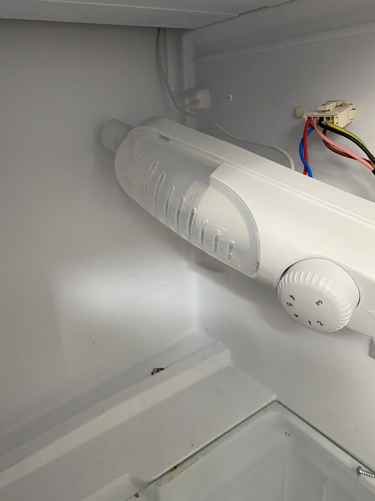

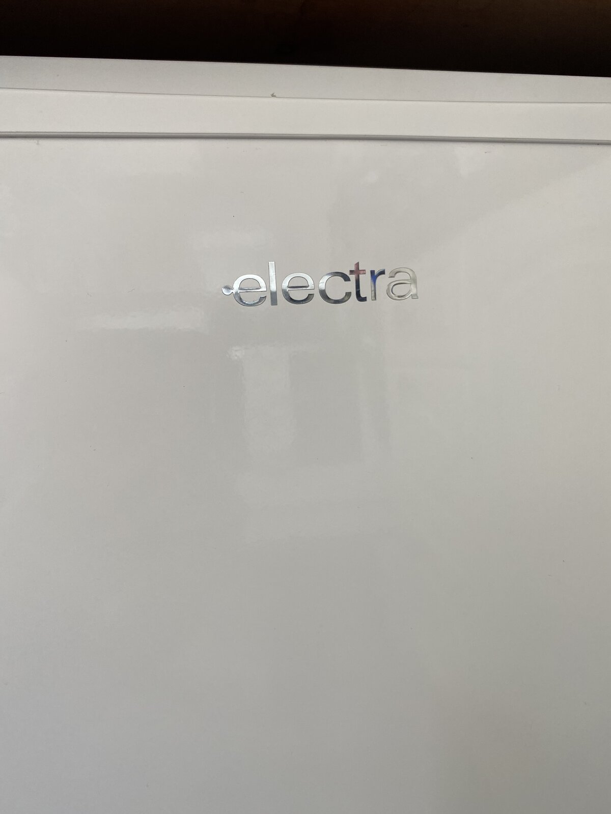

Hello All, anybody got any idea how i open the case on this to change bulb? Thanks

It looks like you've taken the whole unit off the fridge wall.
You need to remove the plastic cover with the slots in it. Behind there is a lamp.
There is a "translucent" and vented cover over the lamp.
There is a little "slot" near the top of that cover (probably one on the other side also).
If you squeeze the cover near those slots, it is likely that
you will be able to remove the cover
to gain access to the Lamp.
Not exactly the same fridge, but here's your easy guide. Hope you can get the old assembly fitted back.!
