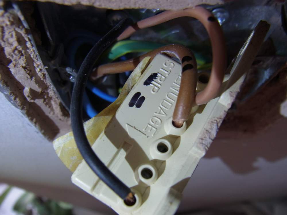

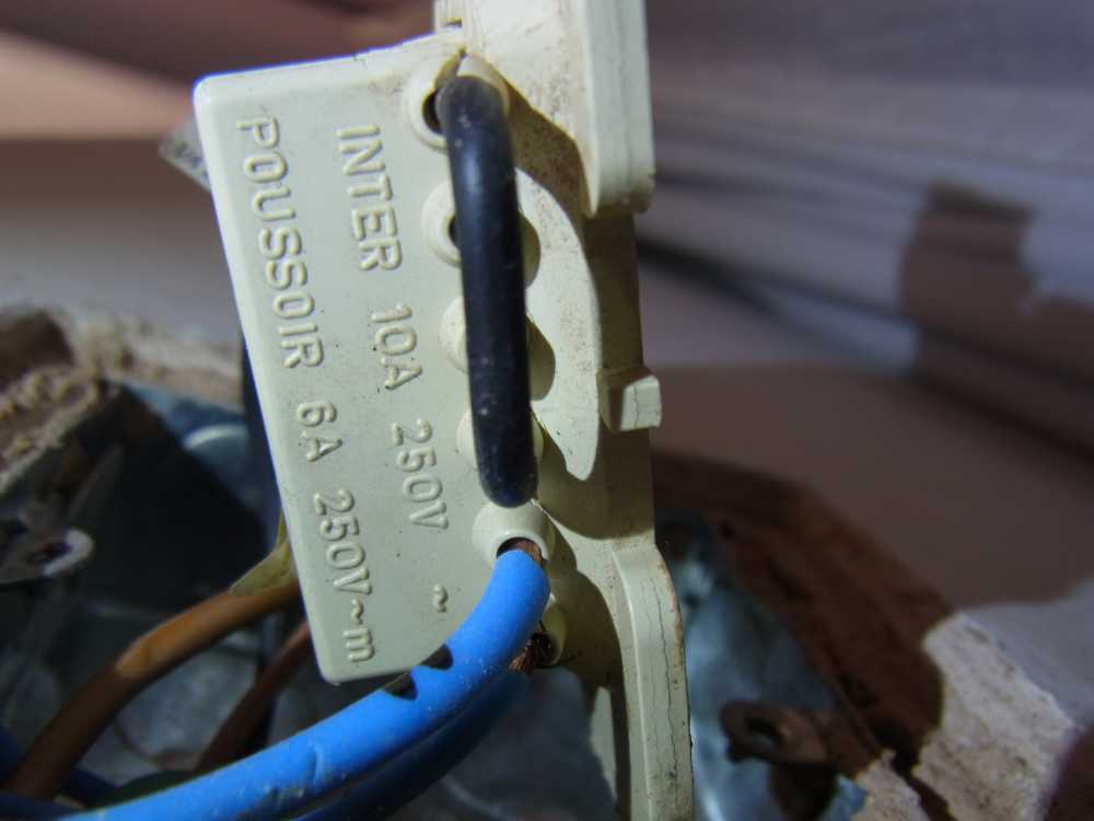

I have a electric awning driven by a Somfy Apollo SLT motor, it has been acting up and now has stopped. Two years ago I had a total rewire of the house with the exception of the switch for the awning which was recycled. It appears the switch was damaged during this process, so I have searched for a new one. The switch is a dual sprung rocker switch (you have to keep it pressed to keep it working) I have brought one that was listed as a Blinds switch it is rated the same 230/240v 10amp.

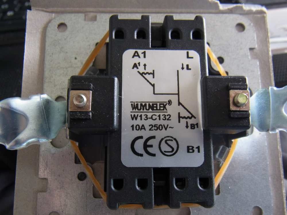

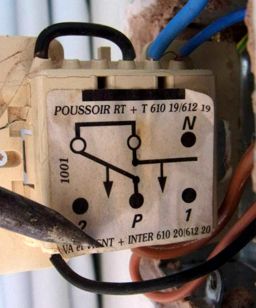

My problem is I do not understand the wiring diagram when compared to the original, I am hoping someone can look at the photos and explain how to wire in the new switch a sketch would really help.
I have a album of photos 3 of the old switch with wires in and the diagram on the back and 1 pic of the diagram on the new switch.
Any informed help would be really great.
I suspect that the correspondence between the old and new terminal names is
P -> L
1 -> A1
2 -> B1
Or the latter two could be swapped, it depends which way up you fix it.
Your old switch has an N terminal. You will need to join those two blue wires together with a terminal block - unless those two terminals at the bottom left of the new switch are actually joined together.
P -> L
1 -> A1
2 -> B1

Ah I have just clocked what you mean about joining the neutrals outside the switch, I may give that a go, the circuit is isolated and we have double RCA main board so the worse that might happen would be the circuit will shut off.
The switch make 4 different connections
No it doesn't - three.
It connects P to 1 or 2 depending on which you press and doesn't allow both at the same time.

The new one is virtually the same L to A1 or B1
Does this one have two separate switches as opposed to a rocker which can't connect both at the same time?
Hi tank you for you answer and question. Both have two rockers and I believe it is mechanical blocked from making contacts on both at the same time, the new one said something to that effect on the sales page ( it was translated from German so the wording was odd)
I think i got my head around the Neutral outside the switch now as it can't be doing anything in the switch as they are nested together to start with.
No, it definitely doesn't do anything.
Its position on the diagram is a bit confusing but the 'switch arm' does not go up and contact it.
