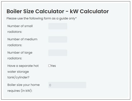

In reality an electric boiler may not be big enough to heat your property anyway. There's an on line calculator you can use to check here. Don't tick the "Have a separate hot water cylinder" box if you intend to use an independent immersion heater.
