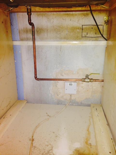

No, I'm not worried about the fridge falling out, as it's about 6" off ground level - I was concerned about it moving forwards and or backwards as it's not secured into the recess properly by screws, and damaging the copper gas pipe at the back. attached is a pic of the area before the oven was put in.

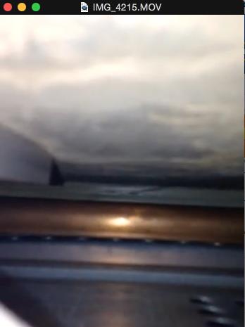

I put my phone under the recess and filmed it, but it seems I cant upload video to this site. I took a few screenshots. It's a bit difficult to see
I uploaded the video.
Any advise/options would be very welcome as I'm quite concerned about the proximity of the pipe to the back of the oven
https://vid.me/slFA
Screw a block of wood to the wall, just more than the gas pipe protrudes.
When you push the oven in, is it touching the gas pipe
Is the gas pipe preventing the oven from going all the way in?
Yes, I think they've pushed it as far as they can without disturbing the gas pipe. I'm getting a gas safe engineer to re-route the pipe higher up to avoid the back of the oven , so the oven can be pushed flush into the recess cupboard properly without disturbing the gas pipe. Hopefully this can be done before the isolation valve so as to completely avoid the area (ie in the picture I posted to the far right of the pipe it would go directly vertical instead of horizontal - thus avoiding the back of the oven) as I mentioned at the back top of the oven there is a good size recess to accomodate gas pipes poking out as it's a NEFF oven - and I've been told NEFFS and Bosch's are best for this
Moving the pipe does seem the easiest option, especially as there's that cable running horizontal (in the white plastic casing) attached to the wall (that goes on to a socket in which the fridge is plugged into)

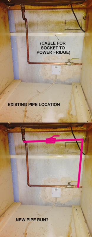

I was thinking of something like this to re-run the route of the gas pipe.
On the video clip the back sides of the oven seem to taper in a bit, so I'm hoping we'll be able to get away with running the pipe vertically up the side. If it misses the back hopefully the fact that it goes over the boxed-in cable (as opposed to going flush to the wall) will be good enough.
Best thing is probably wait for the gas safe fella to come round, pull the fridge out and let him measure up and do as he sees fit???
