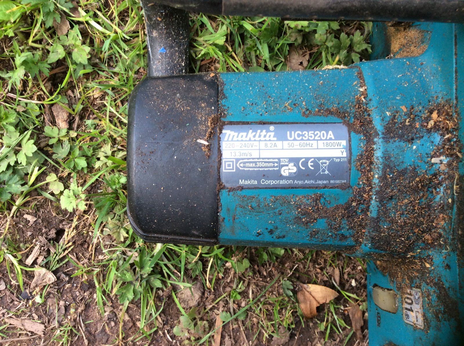

That would be my choice if I wanted one, tough as hell and reliable.
Worth finding out how to sharpen the chain, and regularly give it an extra shot of oil.
John :)

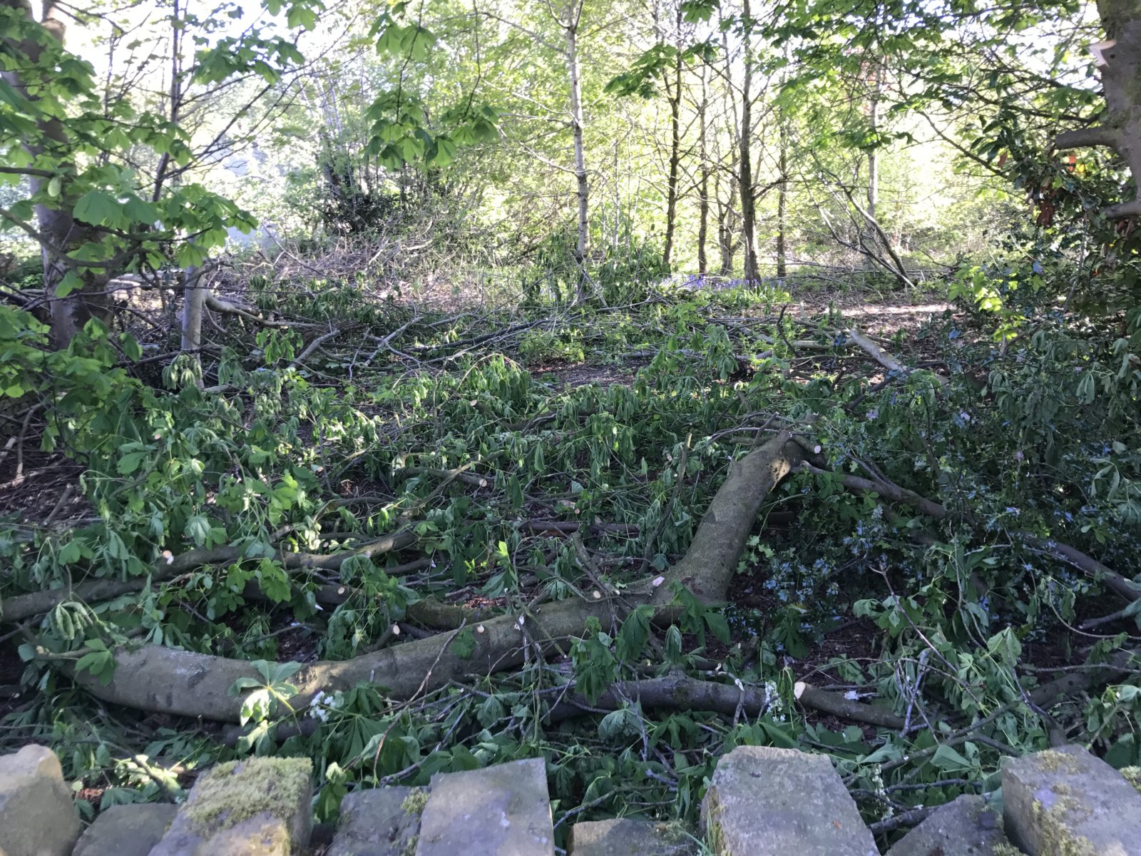

After sleeping on it I've decided to start with the reciprocating saw but also to keep an eye out for a used chainsaw.
Although the trees are not mine they are not maintained in anyway so I might jump over and lob off a decent sized branch each week until I get some light back. There are huge trees left and right of the picture that are too close to the wall, I started hacking because the ones to the left reached over my roof.
