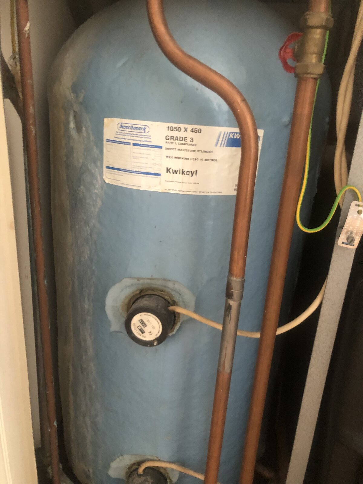

Hi all,
I’m about to replace my boiler and have no idea what’s a good boiler or not as I’ve come across so many that all differ in price, soz, etc.
The place has no gas so it needs to be electric.
I will be adding central heating with this installation (probably 3 or 4 radiators incl. a towel rack).
It’s a one bedroom place (about 45m sq).
Any suggestions on size, make, price range, etc. would be greatly appreciated.
Thank you

Thank you both; appreciate your responses. I also appreciate I could've given more context - I'm on the ground floor, so winters are colder, I also thought the radiators would retain heat longer and save electricity (as the assumption was electric heaters use a lot of energy) - do you think there isn't much difference in electricity usage?
@polesapart I've just removed a storage heater, albeit an old one, and I didn't find it that effective but perhaps it wasn't a good one.
You'll need 3 phase electric for a decently powered electric combi boiler. Do you have that?
Thanks muggles, I'm not entirely sure - I'm trying to find out. I'm replacing an old electric one so assuming so?
That's not a combi boiler, it's a hot water cylinder. Each of those elements is only 3kW and it's quite likely that they can't both be operated at the same time. By comparison the lowest powered gas combi boiler on the market is 24kW which produces acceptable performance for one outlet at a time, but is useless if you want to fill a bath
