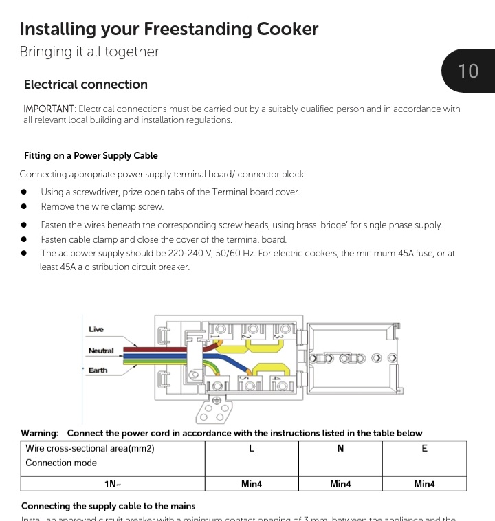

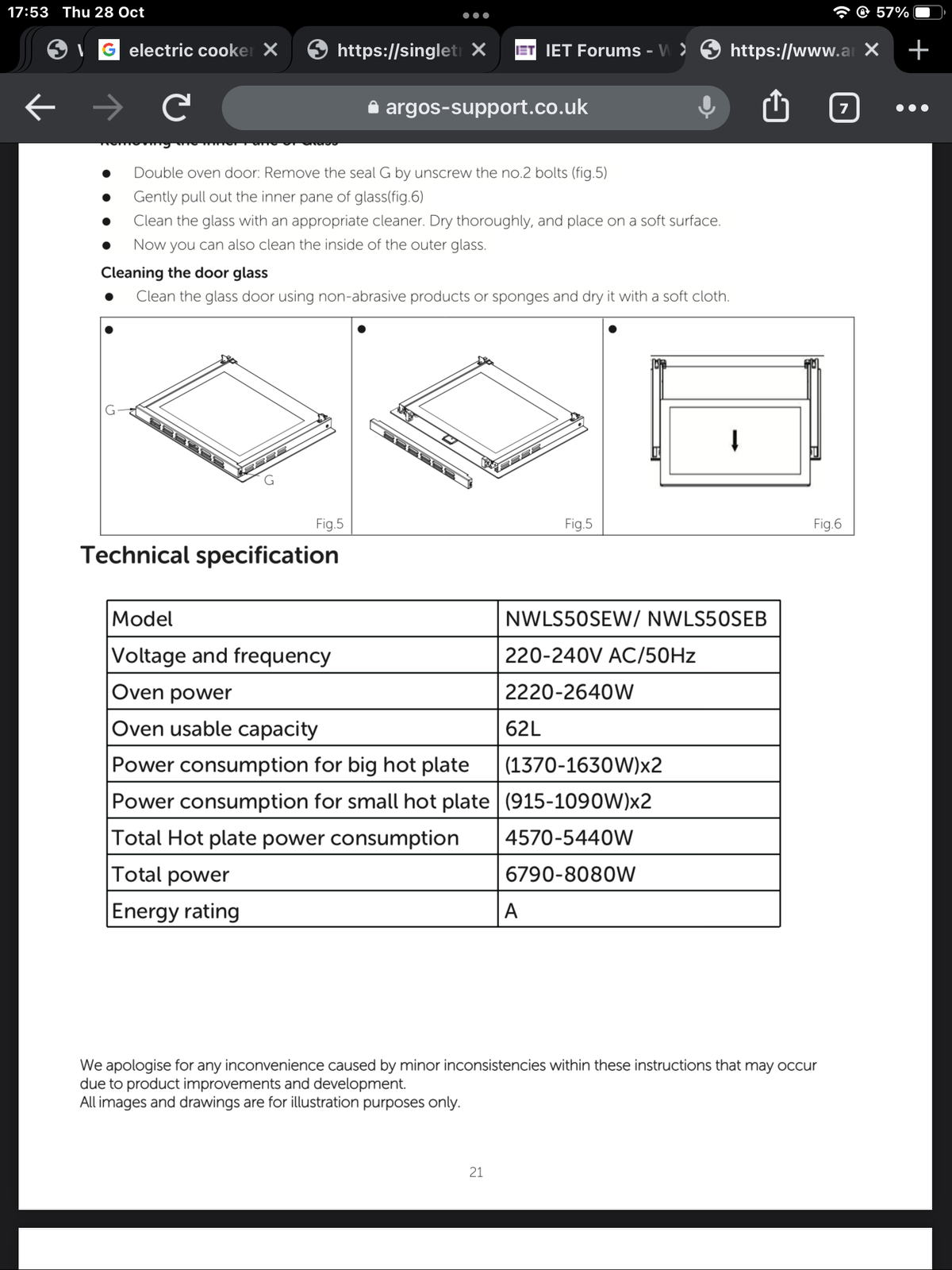

I’ve recently purchased a New World NWLS50SEB electric cooker which needs hard wiring.
I intend on doing this myself unless I’m told that there is the potential for it being a bigger job due to the amount of power it draws and issues with fuses.
attached is the information from the booklet, can anyone tell me whether it’s a simple job or am I going to need to get someone in?
I do have intelligence, I can do this myself, I just don’t know how to tell whether this cooker is going to be too powerful and trip out when I switch it on for the first time.
Thank you.

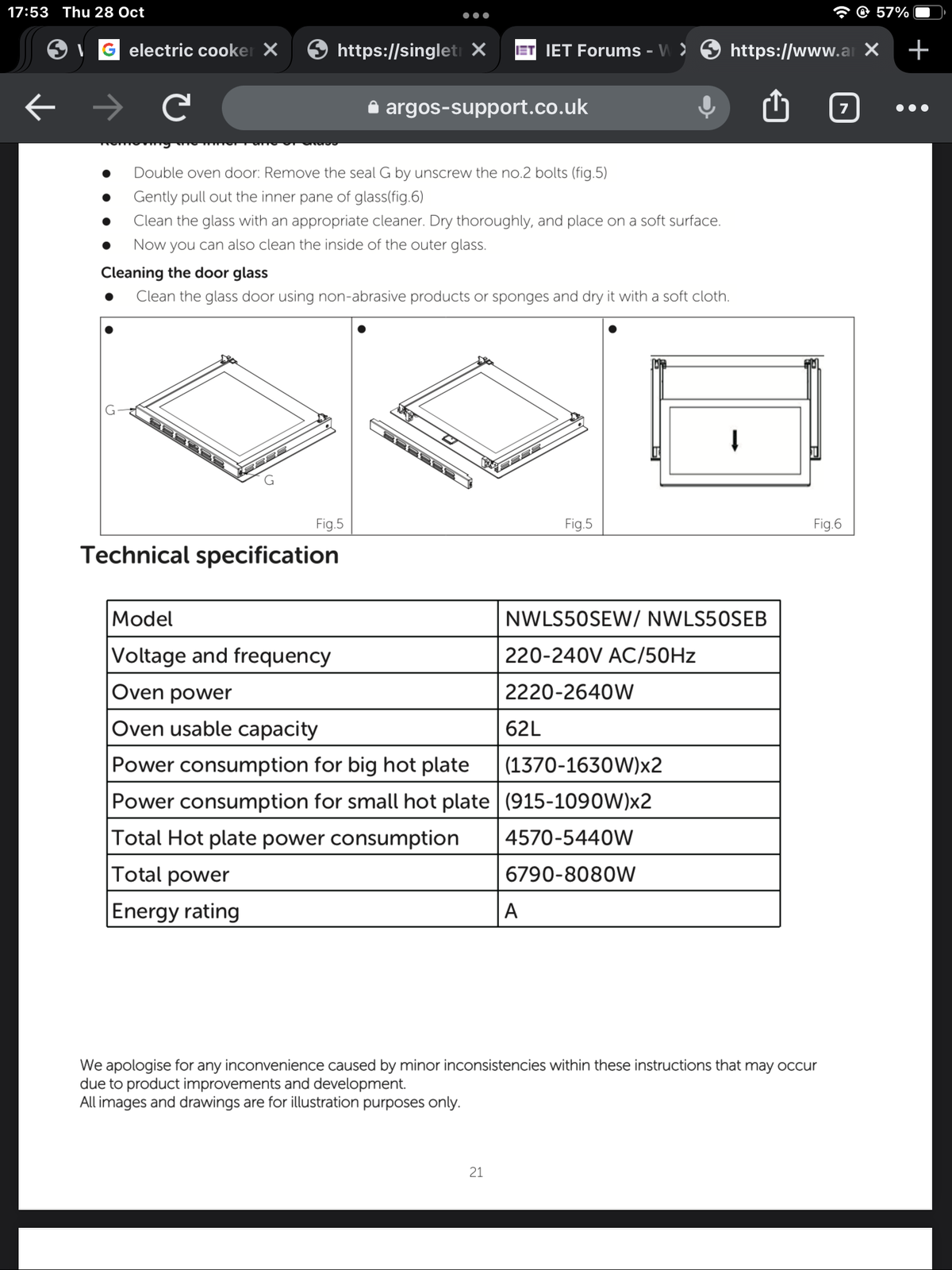

Hi,
This cooker, if using every hotplate on the hob and the oven/grill was working flat-out, could draw a current of over 30A.

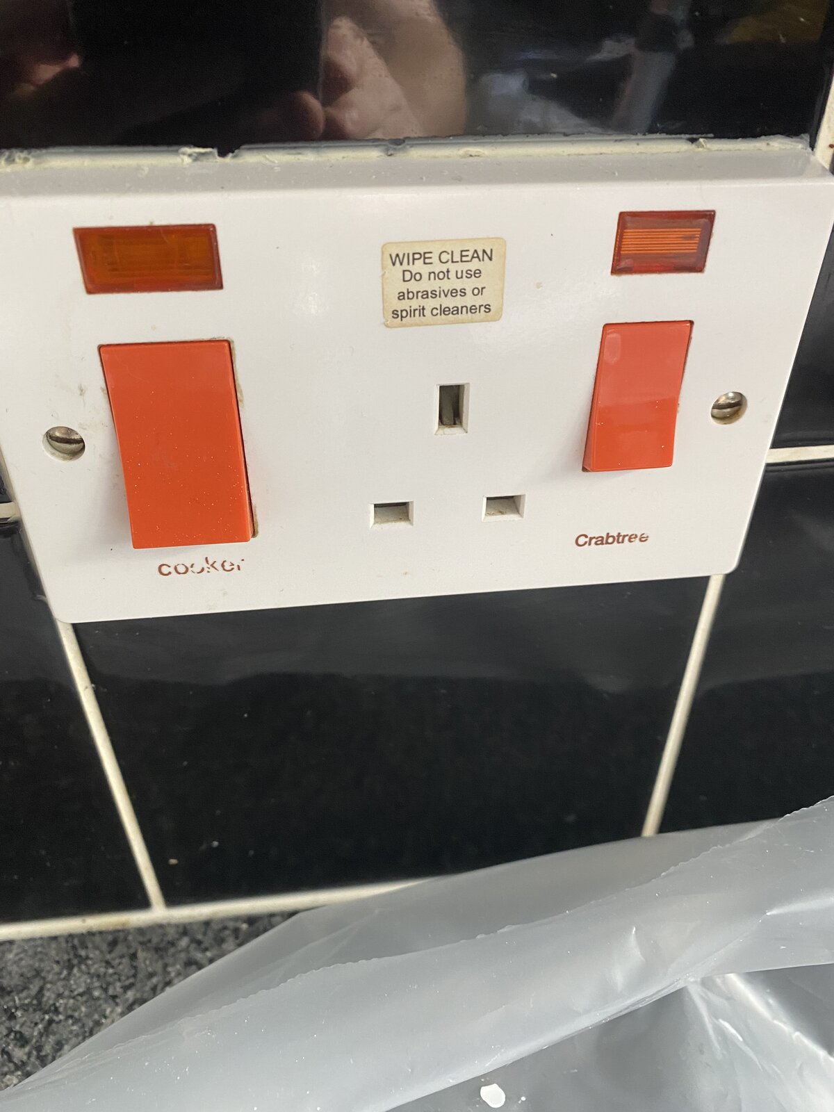

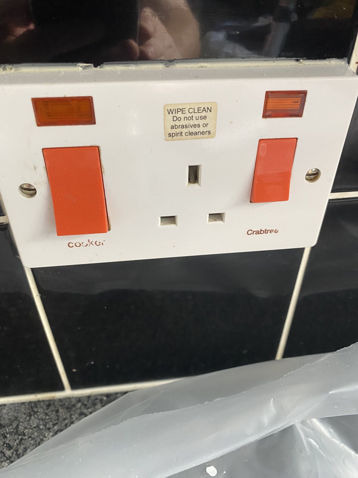

Relating to the circuit, it would be useful to know the MCB rating and if possible, the cable size between the 'consumer unit' and the cooker outlet.

The instructions state it should be connected to a 45A circuit:
If the voltage in your home is 240V, at maximum power, the oven could draw a current of nearly 34A. At a more average 230V, the draw would be nearer to 32A.
Depending on how you cook, it might be very unlikely that your cooker will take anything like the maximum power.
However, if you are likely to use all the hotplates, oven and grill at the same time, that current may get uncomfortably close to the limit of the cable/MCB if you only have a 32A MCB.
If you have a decent cable size, it may be possible to uprate the MCB to say, 45A. But that would definitely require an electrician!
...and if you do have a cooker switch with a socket, that will be another current load to take into account for the poor cable! :)
So, the decision depends on what level of risk you wish to take! It may be doable, but maybe not a risk worth taking!

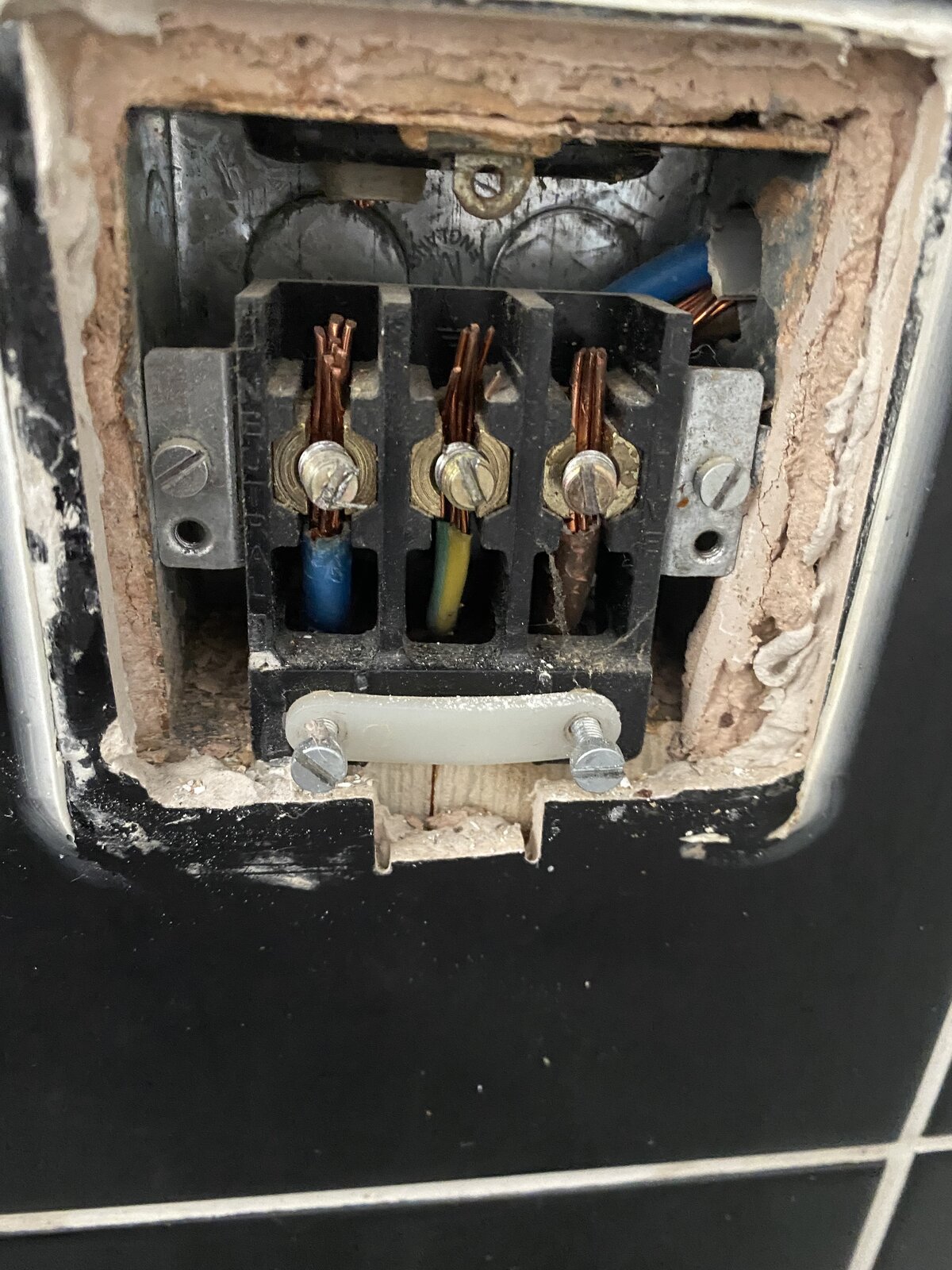

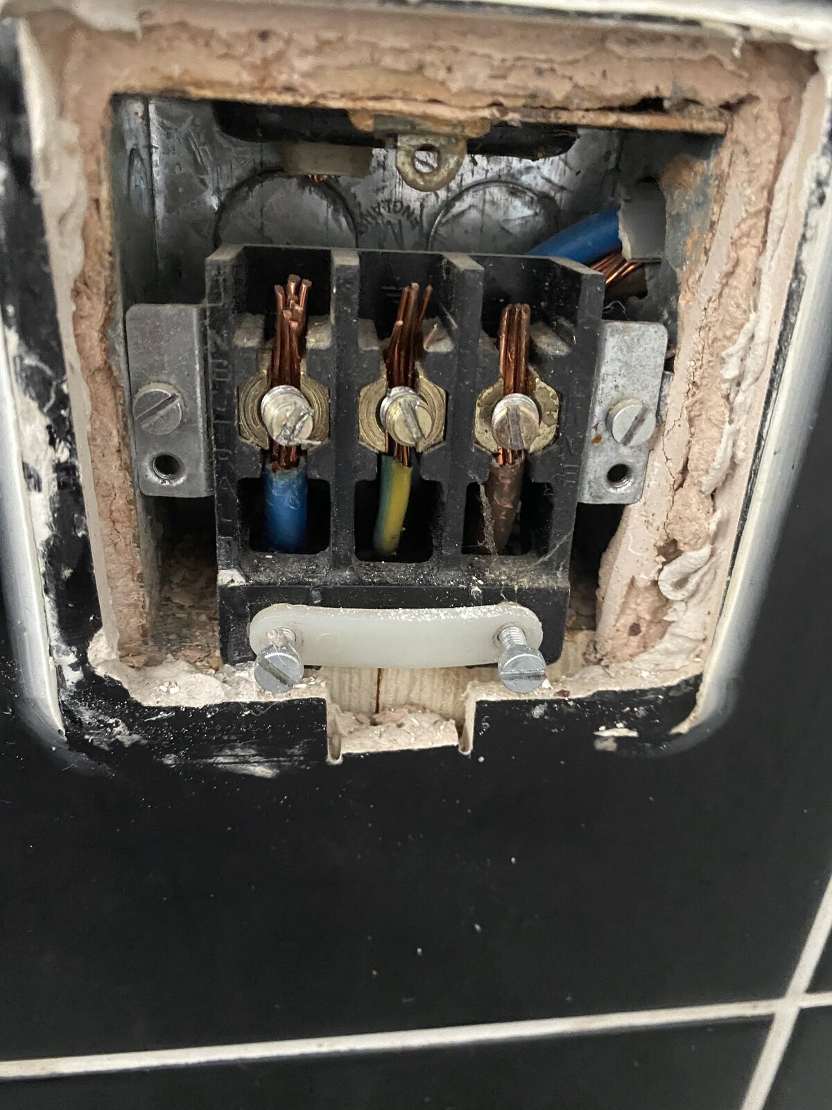

Check the cable going into the cooker switch & if the earth wire ( green/yellow ) is multi stranded like the ccu ( cooker connection unit) in your second pic then it will be 10 mm sq. As long as it has been installed correctly initially ( which looking at pics. suggests it will have been ) then you will be ok to connect the cooker to the ccu yourself.

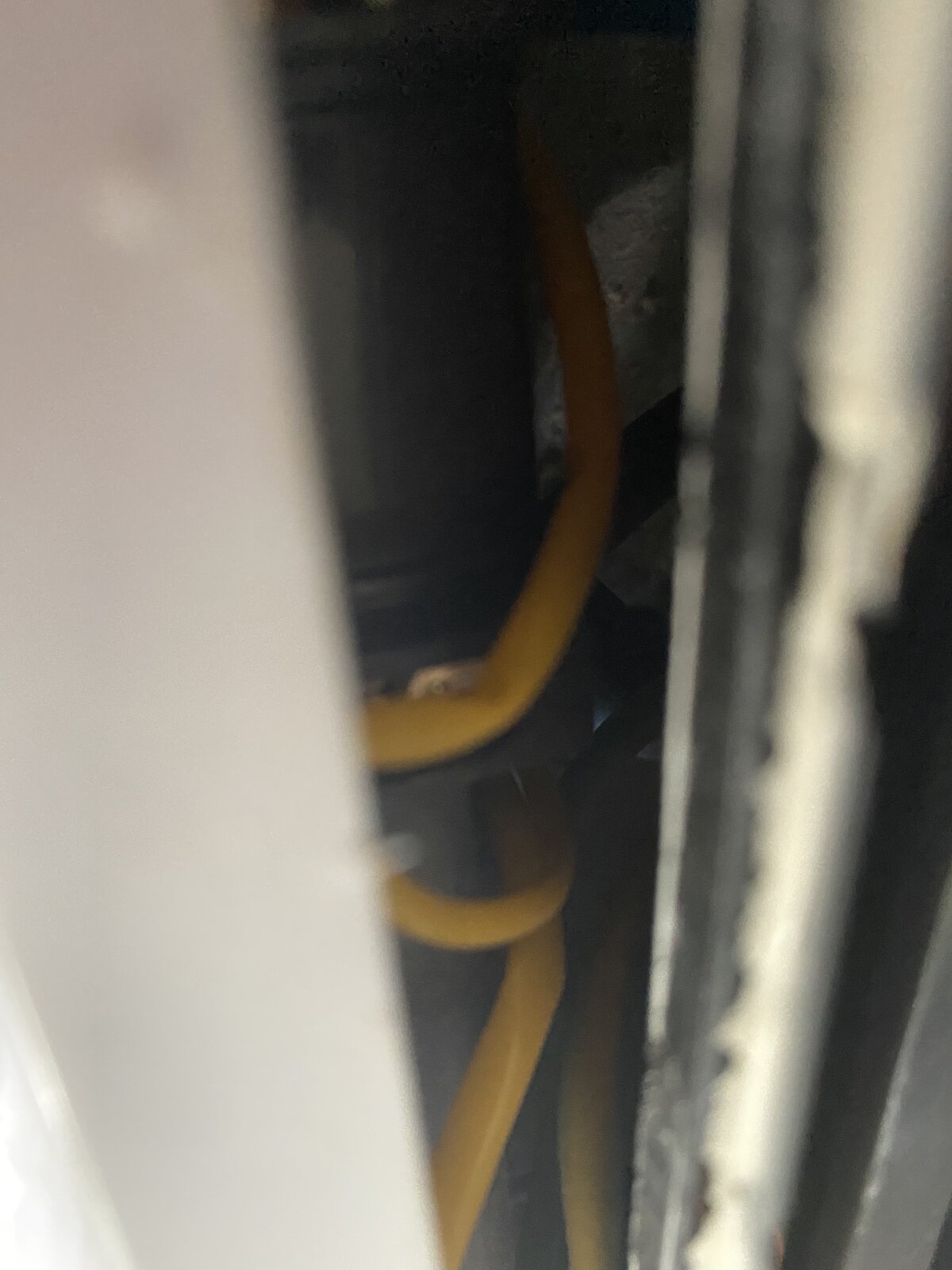

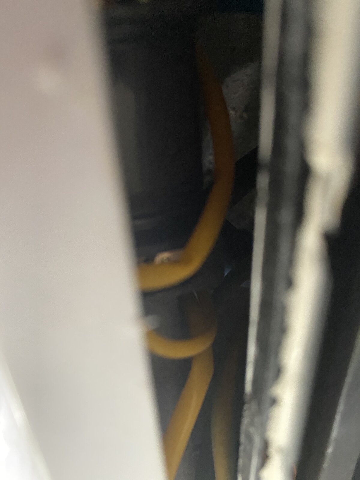

Apologies for not the best picture in the world but it was the best I could take.
This is behind the cooker switch.
Going back to,
Diversity calculations can be used to specify cable size.
Some information here:
https://www.tlc-direct.co.uk/Book/6.5.2.htm
In your case a diversity calculation would come out at around 22A, so a 32A rated MCB would be allowable with some provisoes.
I.e. some extra current allowance may be needed for long cable runs, cable buried in plaster or unless the manufacturers instructions said otherwise! ;)
So in conclusion which cable should I be using when wiring the cooker in? 6mm or 10mm?
Ideally, your existing circuit is in 10mm
if going by manufacturer's instructions 10mm should be used for the connection, (2m) length maximum. Twin and earth is acceptable.
However, if the rest of your circuit isn't 45A rated, I believe (and again I may be wrong! These values should be calculated by a qualified electrician) diversity would allow for 32A circuit and 6mm cable (with provisoes)
The bare copper earths should be covered with green/yellow sleeving.
The manufactures wiring illustration is also wrong! The grey outer cover of the T&E should be terminated within the connector box, or the wires double insulation will be lost. I.e. the coloured cores should not be seen outside of the box, just as with a plug.
