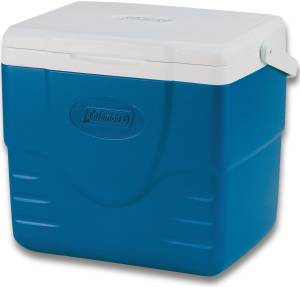

Those kennels look to be just moulded plastic.
So does this:
This will not keep the heat in at all.
Depends what the construction is - if it's a double skinned foam sandwich....
