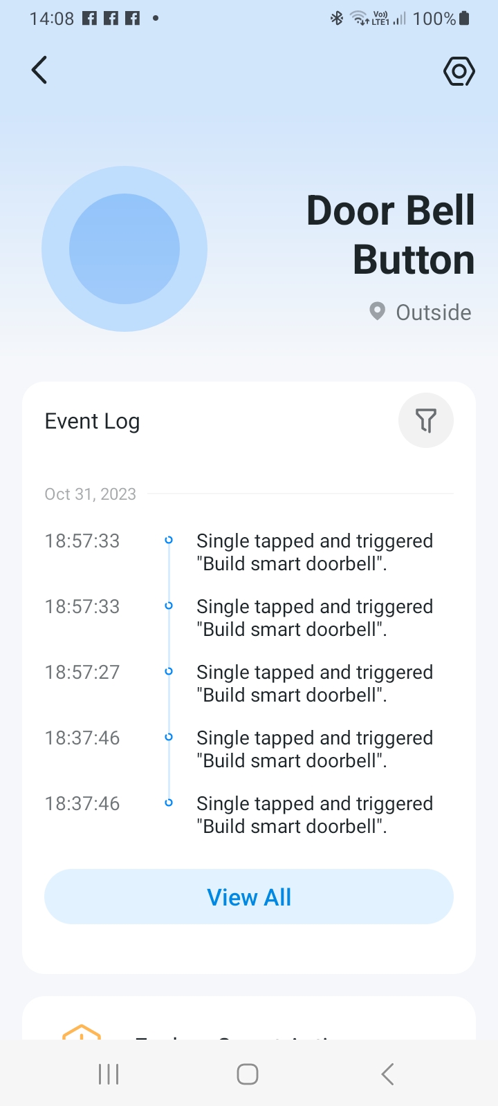

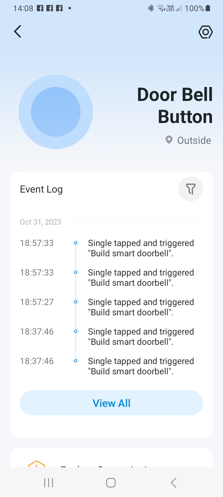

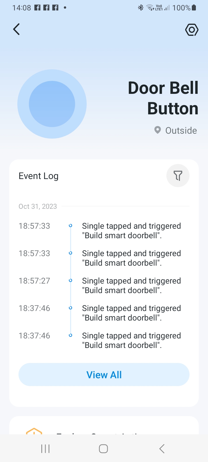

What I do find is then some one says I rang the bell and there was no answer looking on phone and saying when did you ring it, well there is no report it was rung at that time see Door bell report.jpgwe had three sets of trick and treat visitors and two pressed the door bell twice, actually four sets I was still at the door when one set came down the drive.

What I do find is then some one says I rang the bell and there was no answer looking on phone and saying when did you ring it, well there is no report it was rung at that time see View attachment 319432we had three sets of trick and treat visitors and two pressed the door bell twice, actually four sets I was still at the door when one set came down the drive.
