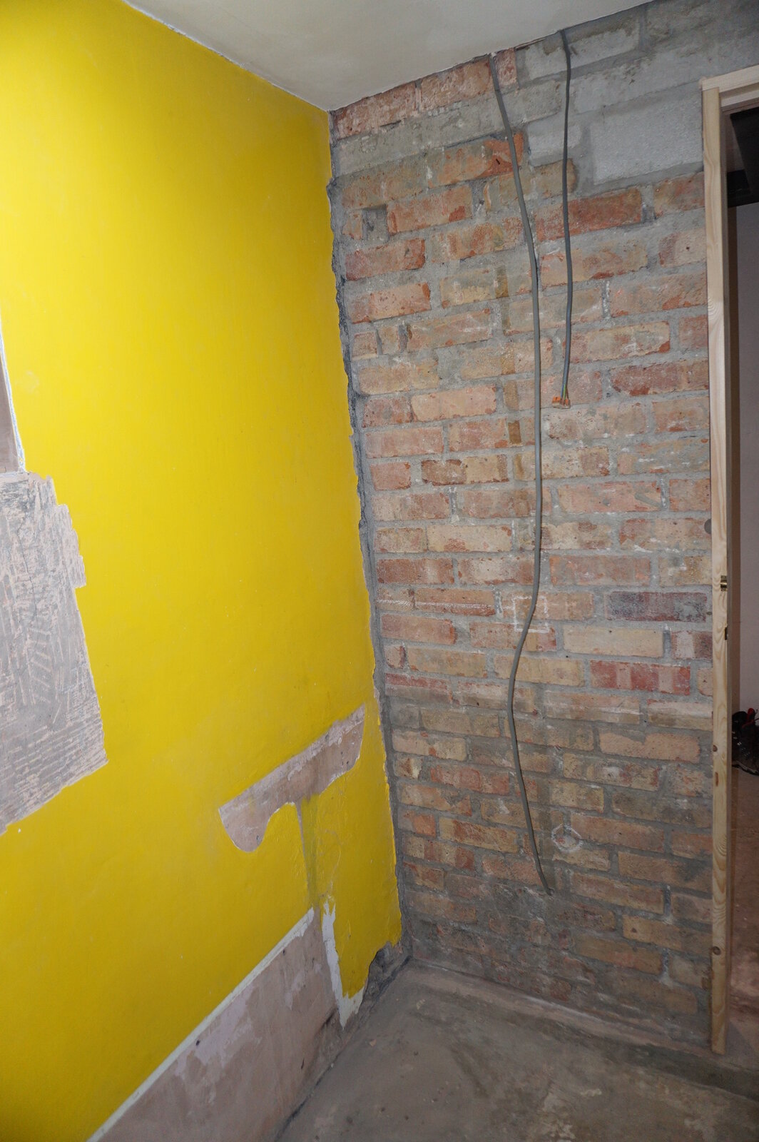

Bathroom being replaced/rearranged.
Washing machine going in bathroom corner via new spur in hall, with upward sloping hole up to new spur backbox.
Is it ok to Wago a junction in a 16mm blanked off galvanised backbox, to run a switched fused suppy for the towel rad off to the left (1000 height towel rad going over old sink position).
Does that sound right?

That 240v drop inside the bathroom supplies the dbl socket/new spur on the hallway side of the wall. The circled hole goes to the hallway spur.
I'm just trying to find the easiest way to provide a 2nd 240v fused spur INSIDE the bathroom, for a heated towel rad on that yellow wall to the left. Ceiling joists run parallel to the yellow wall,
I was thinking some triple Wagos in a back box would facilitate a short run of cable off to the left but there may be a better way?

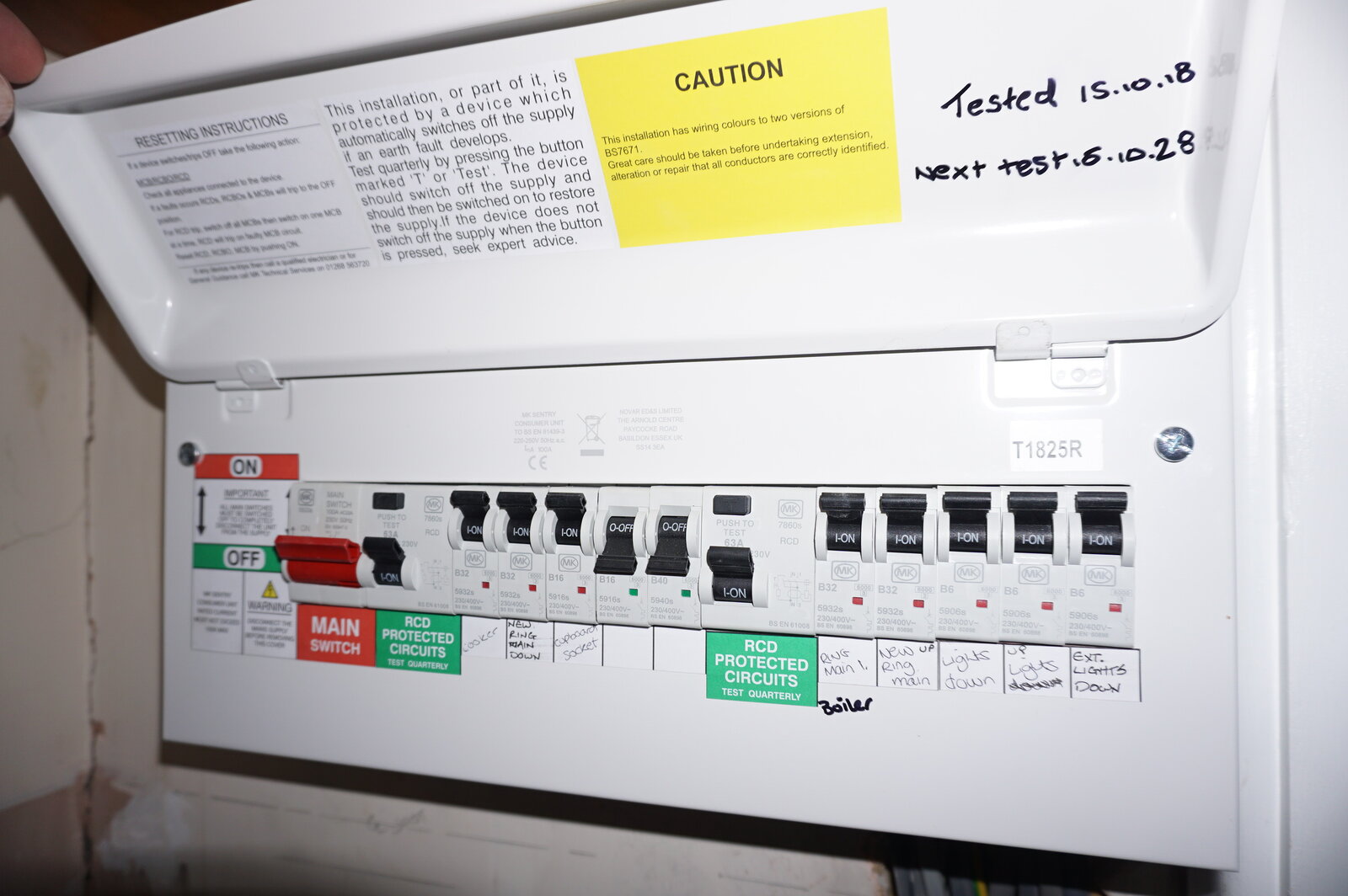

Where does the cable come from, what circuit is it on and what size is it?
You cannot just add things to the end of a cable without ensuring it is suitably protected against over-current.

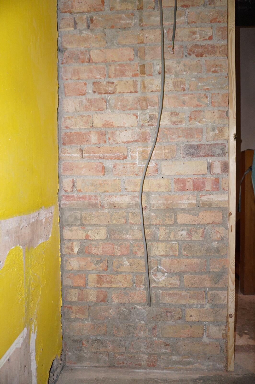

I was thinking of teeing the additional bathroom spur into the old school cable where I chalked a backbox on the wall?
It drops from the kitchen above. The circuit is "Ring main 1/Boiler" in the CU - the only 240v circuit until I added an extension.
Old school cable has no text on the outer grey, but the neutral/live copper cores are 2mm dia on my vernier. It is quite chunky.
The new hallway spur has modern 2x2.5 + 1.5

Your cable appears to be 2.5mm² (dia. 1.78mm.) in which case you must fit an FCU with a 13A fuse first and connect everything to the load terminals.
So, run the cable through the wall and connect to the feed terminals of the FCU then from the load terminals to whatever it supplies and the socket, then from the socket to the new radiator FCU through a horizontal chase in the walls.
Or
Replace the drop cable with 4mm² and connect that and two 2.5mm² cables, for the two FCUs, to the socket terminals.

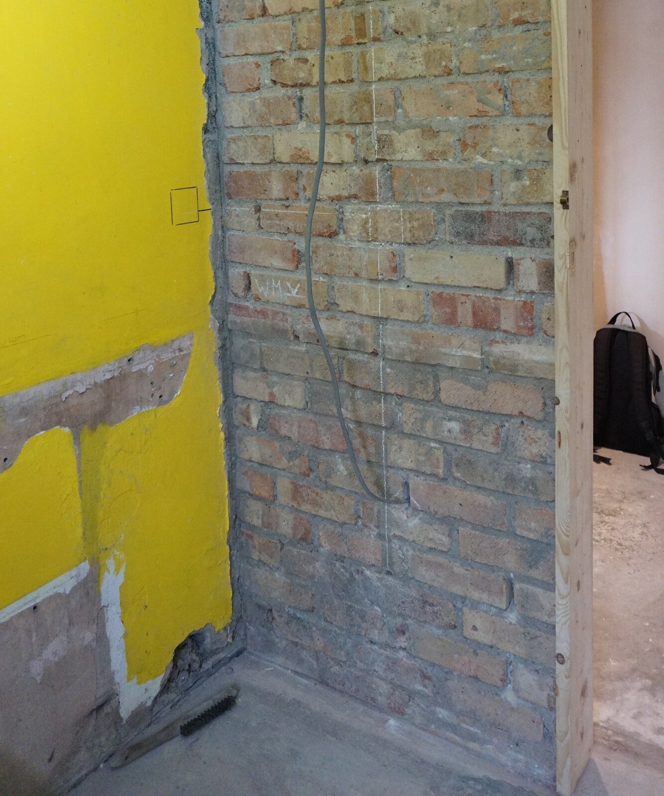

Does the rad FCU have to be sited where it's supply emerges in the bathroom or can it be sited horiz to that, to have it on the yellow wall, below proposed rad?

It has to be on the yellow wall if you are concealing the cable.

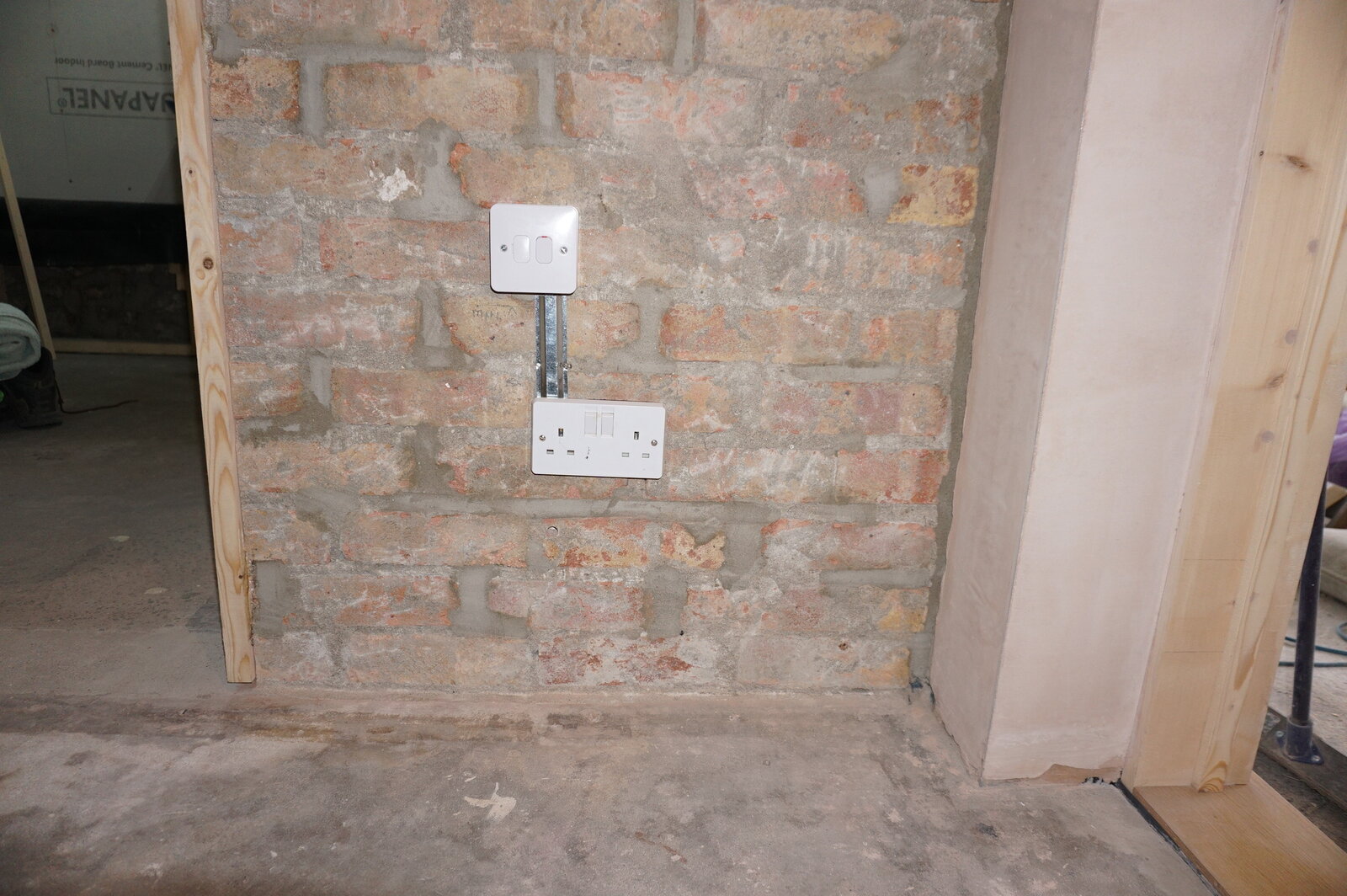

Does the rad FCU have to be supplied from the socket?
What about both FCUs in the bathroom, switched/flex outlet or otherwise.

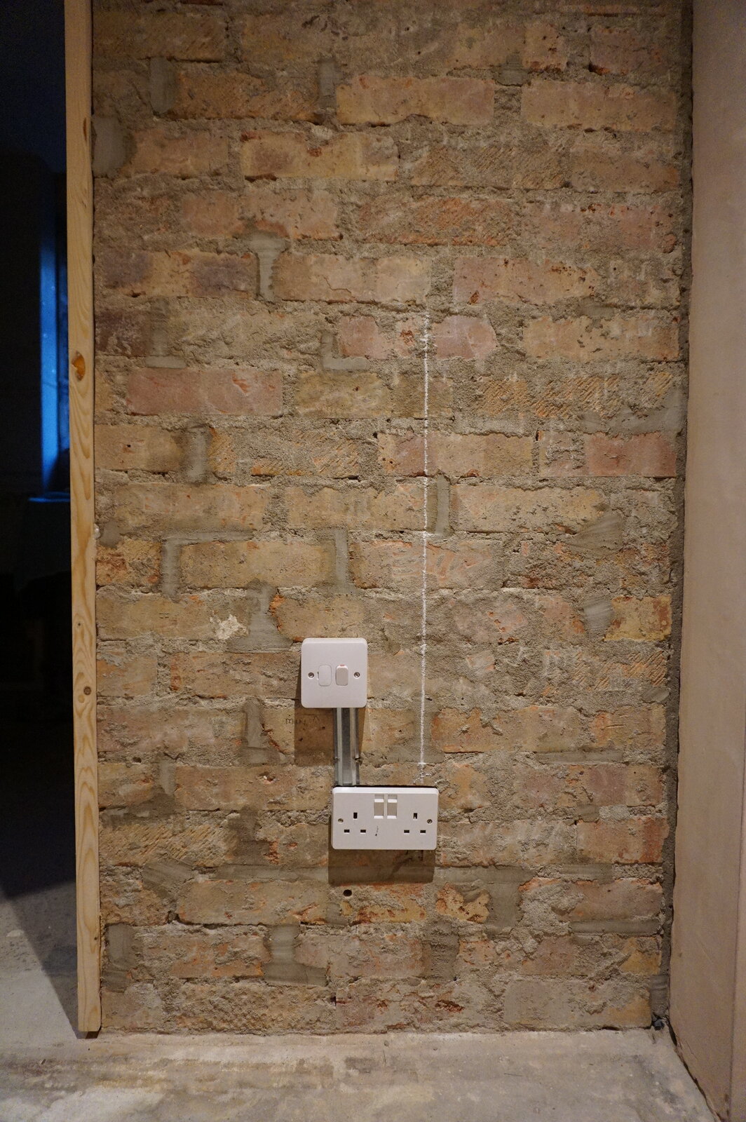

Take the existing old code drop to the WM FCU, continue (load) down, to (original) dbl socket feed hole thru wall, plus another (load) off left to rad FCU?
Indicated in chalk & Black marker.
No, but with only 2.5mm² cable, an FCU has to protect everything so has to be 'first' with everything from the out/load terminals.
Yes, that would be alright but both will have to be FCUs.
Yes, that's OK.
